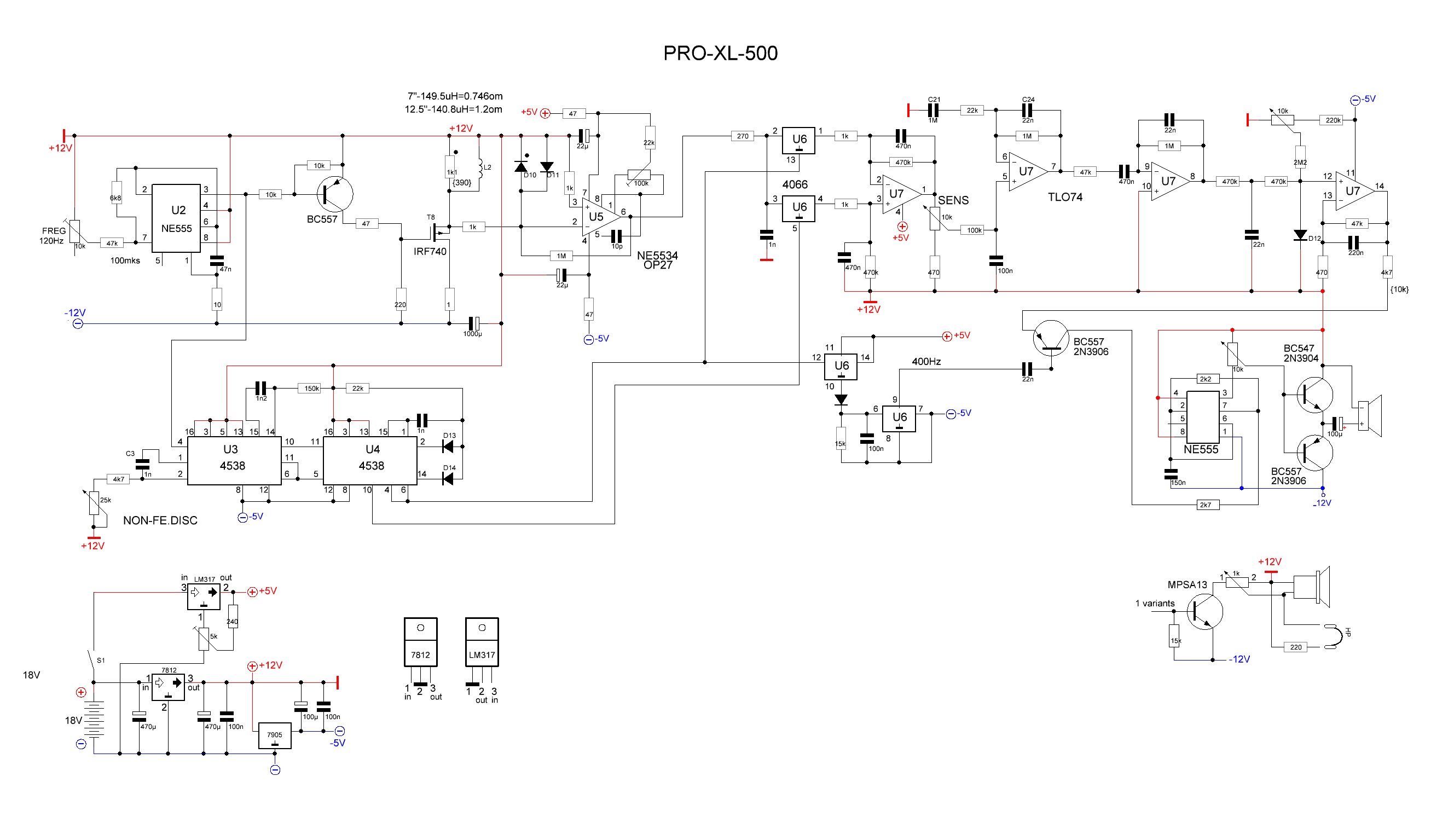

Garrett (pulse) XL 500

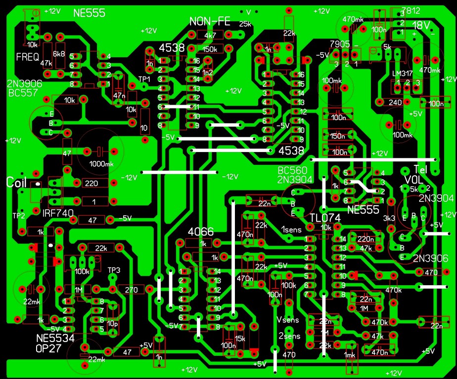

    Sens.1 is a bit wrong placed under LM324
    Because of Eric's recommendation, I was looking for the circuit diagram from the Mini Pulse.
    There are some similarities here in this detector. Maybe it should be possible, with some small modifications,
    to change the unit into a modern detector.
    Eric's suggestions I have not yet tried, but I will do it for sure.
      Pro XL 500
        I think this pcb is from thunting...
          Good to know the real name...finally
          Thank you

                  I found this today.
                  My AVG is flagging on that file . Do you have another copy of it ?
Name:	Circuit Diagram_Pro XL 500.jpg
                      XL-500.zip
                        I have scanned that file with AVG free and it does not flag on it. What version do you use ?

                                Only the schematic posted by Homefire (7) resembles the official XL500 produced by Garrett. The others appear to be adaptations by third parties which have significant differences such that they should not be confused with the genuine XL500 arrangement.
                                Eric.
