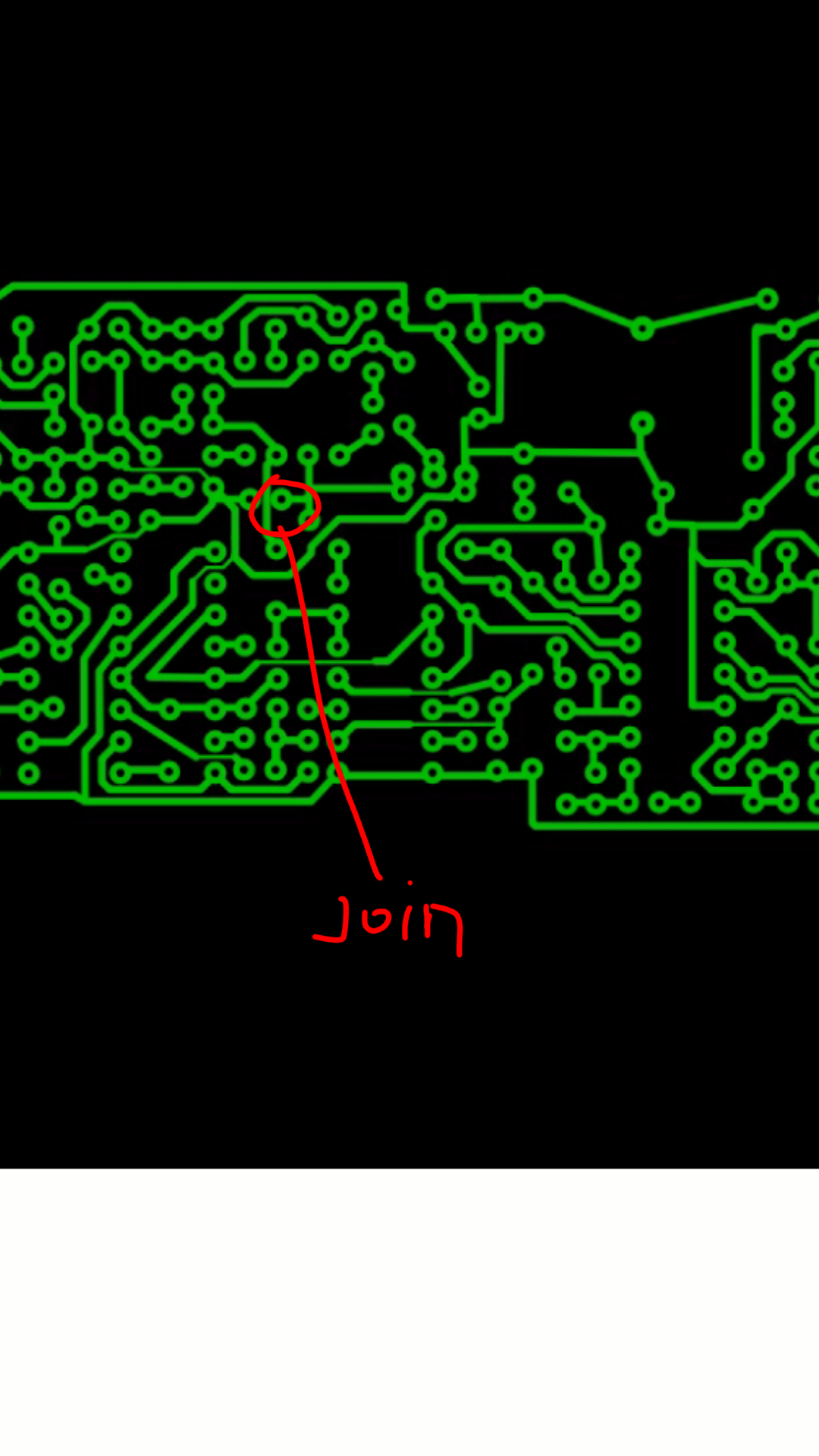

                          • #58
                            I just buy the resistors, IC and transistor from the schematic, will work the pcb later...
                            • #59
                              Mr.Fred, this point is a joint with the track right?
                              • #60
                                Sorry no. The vertical line should be here 0,3 mm.
