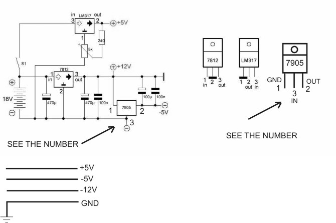

  • 7905 is a simple voltage regulator and not a negative voltage converter.
    • @Constantin,,,Thanks. Marty
      • Originally posted by Constantin View Post
        Something is wrong in this schematic. Power supply won't work.
        This has been spoken about many times , who ever drew the schematic got the 7905 symbol a bit skewwhiff
        if you move the ground symbol inside the box up to the +12v leg it works
        Somebody attempted to relabel it

          • Sounds as though the Gerber files are not going to surface on this project.
            • Hi Alec,,,The gerbers can be extracted from the Layout file that Walkman posted if you have Sprint layout? If you don't have it I could extract them for you and post them. I've searched for the XL 500 Gerbers by Dbanner but can't locate them on the forum. Regards, Marty.

                  • Originally posted by gurdal View Post
                    Hi
                    You need to add the board outline to those Gerber files. otherwise it will be rejected by the PCB manufacturer.
                    • Thanks George,,,will do. Regards, Marty.
                      • Gerber XL 500
                        I added the Board outline to the Gerbers. Regards, Marty
                          I zipped and uploaded the file to a pcb factory and the gerbs pass ok
                          pcb is 105x126 mm
