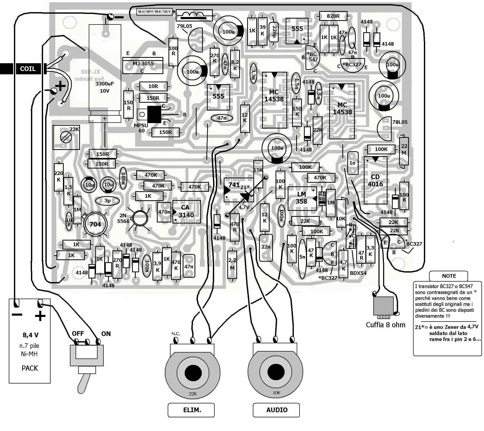

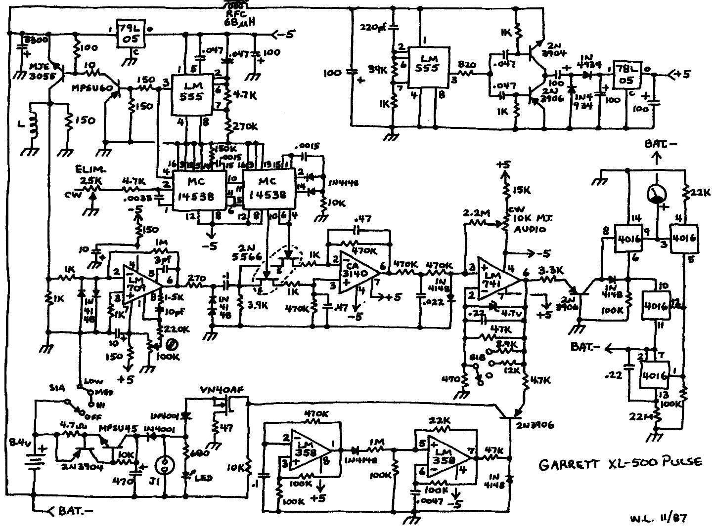

          Hi Walkman,,,Thanks for the files. Is there a Schematic for this PCB? Thanks, Marty.
          Hi MartyJ1963
          Yes I have schematic.
          • @Walkman,,,Thank you very much Walkman,,it's very kind. Regards, Marty
            • @Walkman,,,,What value are the Diodes please? It does not give the values on the schematic or the PCB. Thanks again, Marty.
                1n4148 use
                • According to the original files I believe it is the IN4148
                  • Thank you Walkman. I'm building the Voodoo at the moment but I would like to build your version of the XL-500 also. I tried to build the original but I could never get it to work. Thank you again. Regards, Marty.

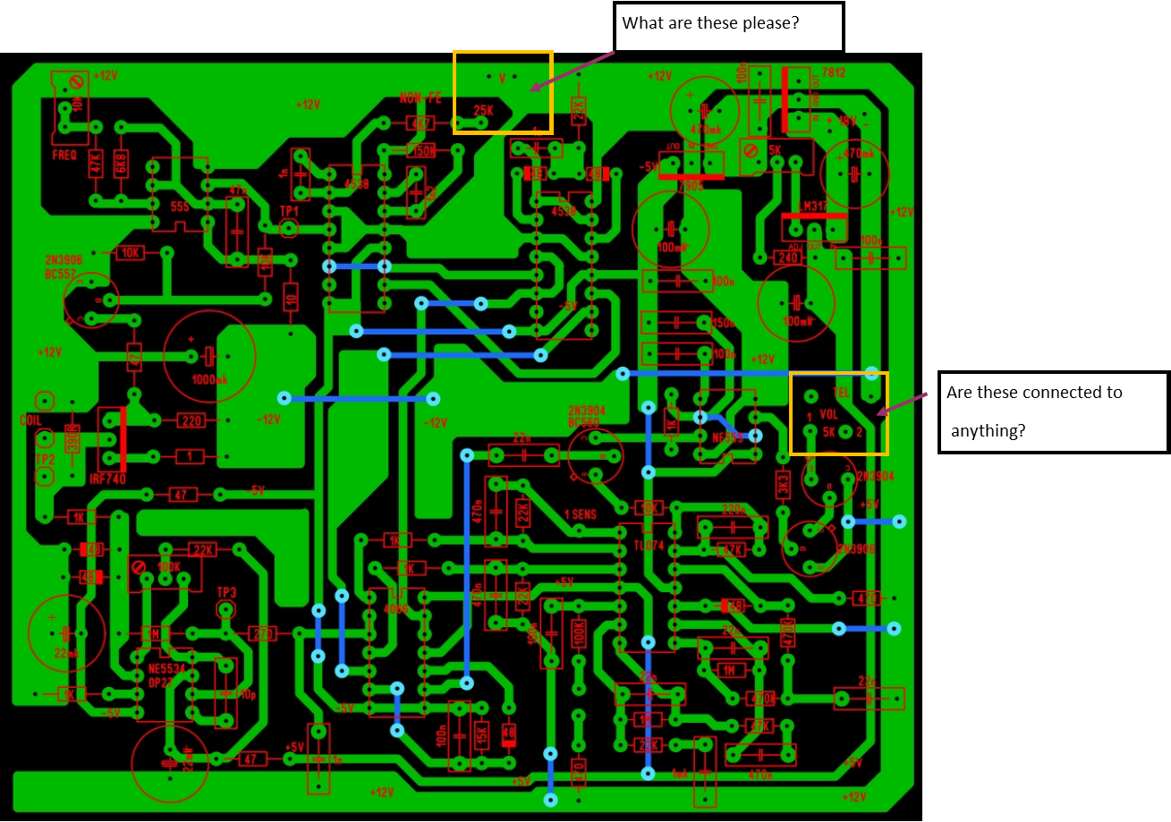

                    • Thank you Walkman and Emersonpaz. @Walkman,,,Could you tell me what these are please on the photo I posted? Thanks, Marty.
                        Hi Marty
                        Please follow shcematic.
                          The yellow box marked 25K, appears to be the NON-FE.DISC 25K pot that goes from one end of the 4K7 resistor and the other to +12volt, its looks like a pcb pin hole is provided in the +12 volt copper to solder in to/on to.
                          The other yellow box is the audio section which has some variations.
                            I might have written that poorly, so the area within the yellow box which contains the figure 25K, etc etc

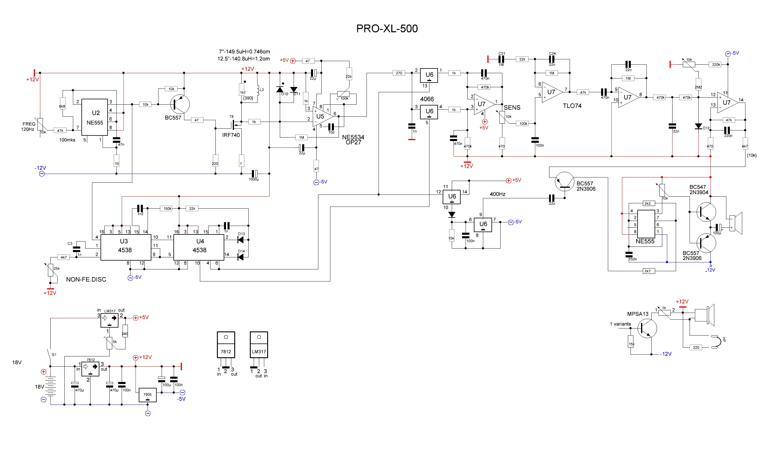

                            • Originally posted by walkman View Post
                              Hi MartyJ1963
                              Something is wrong in this schematic. Power supply won't work.
                              • Thanks guys,,,Only I couldn't figure out where to connect the speaker? @Constantin,,,Have you built this version? How do you know the Power supply section doesn't work? Thanks, Marty
