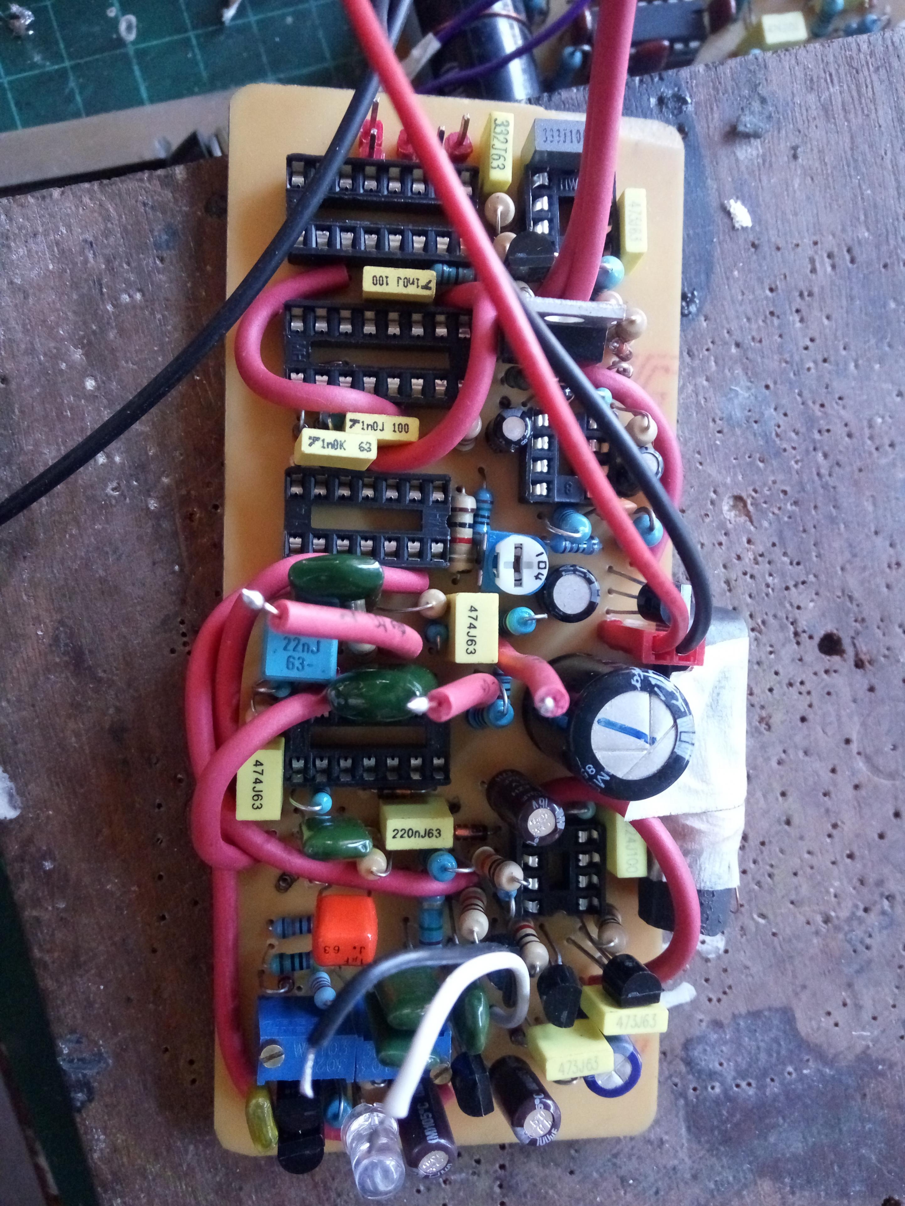

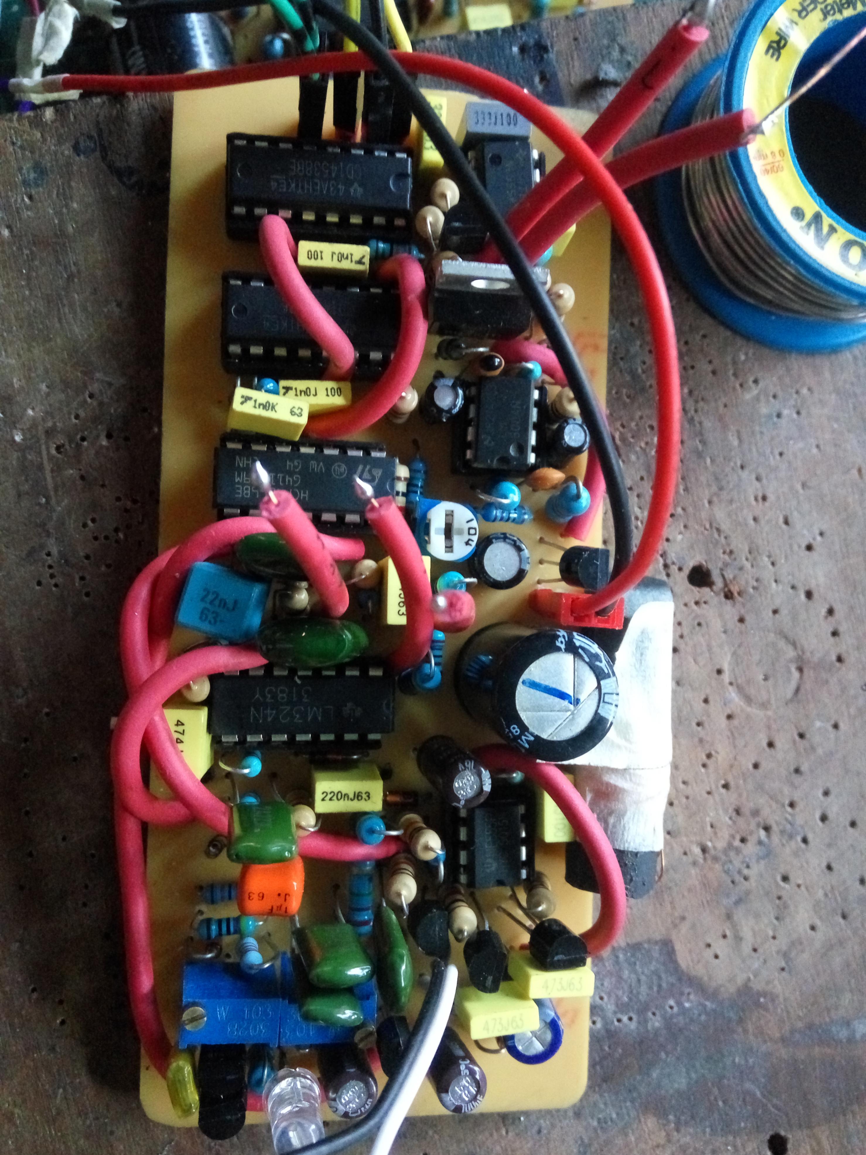

    My setup
    79L05 out 7.4v
    78L05 out 12.5 v
    I use 12v battery
    I think its wrong.....
    • #92
      The MPSA13 is a darlington transistor. It's equivalent to BC517 or 2n6426.
      You can check for equivalent here :http://alltransistors.com/crsearch.p...fe=5&caps=TO92
      For your measurement, did you take the battery + as ground ? This MD has a strange power supply, the GND is the + battery, the charge pump generate +6.5v at the input of 7805.
      • #93
        What??? What ever...let me try your methods
        • #94
          You are right.... 79L05 out -5v, 7805 out 0v with + batt as ground test, should i put all the ic's?
          Btw i cant find DR 100uh i made myself with ferrite rod with 100uh, is that okay?
          • #95
            The charge pump is made of a 555, 2 transistors and the 100uf you hasked before for value.
            This should give a 6.5v at the input of the 78l05. You should have +5v at the output of 78l05.
            All measurement should be done with the minus wire of your multimeter plug on the + battery which is a floating ground.

              • #97
                Unfortunetly...nope, its not working, no sound at all, after put all the ic 79l05 out -1v 79l05 12v.... Any clue?
                    [ATTACH]37092[/ATTACH]
                    Your second 4538 IC is reversed. Try to take it out and recheck the voltages. If you have recover the good +-5v, just put a new 4538 in place.
                    • Originally posted by reptooyep View Post
                      Miss that one....okay i got this
                      79 -5v (+ probe ground), 7v with minus battery as ground
                      78 12v

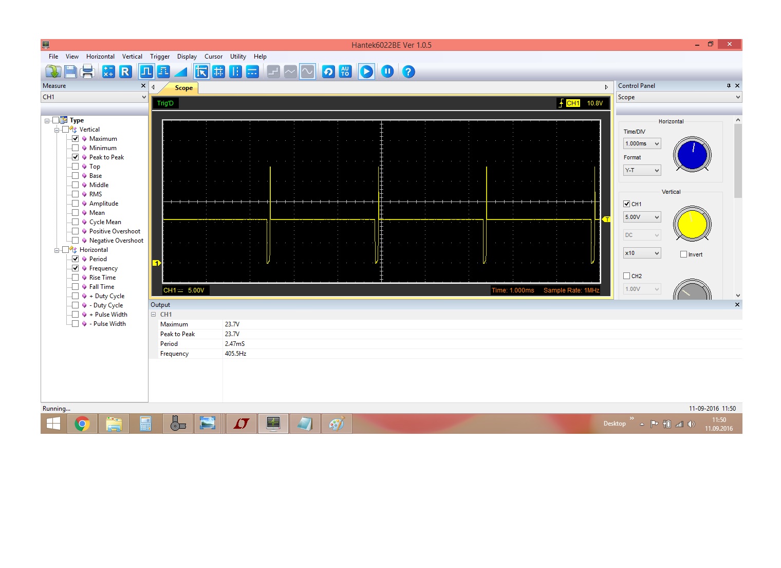

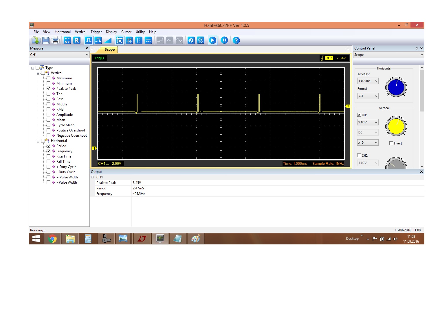

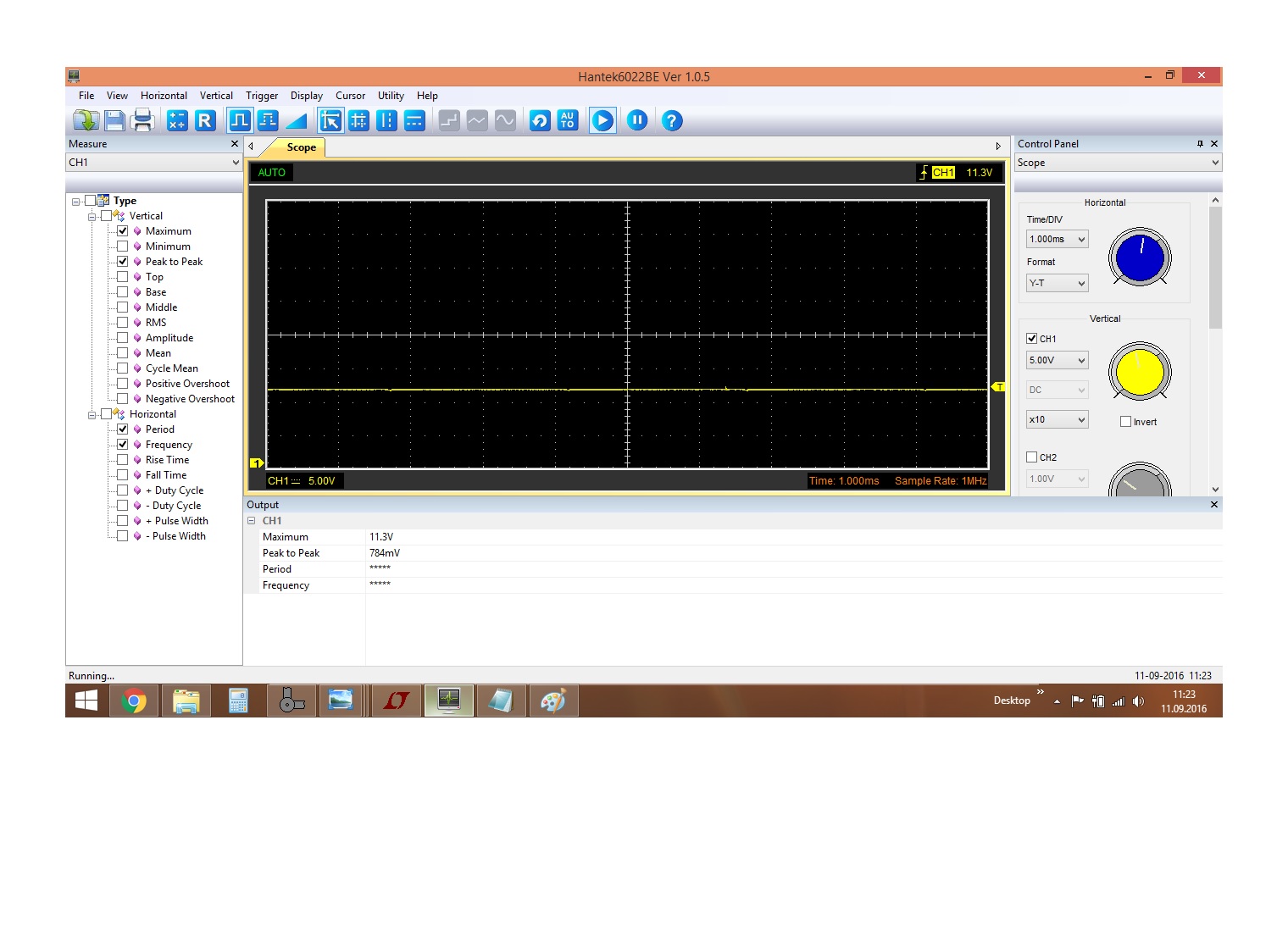

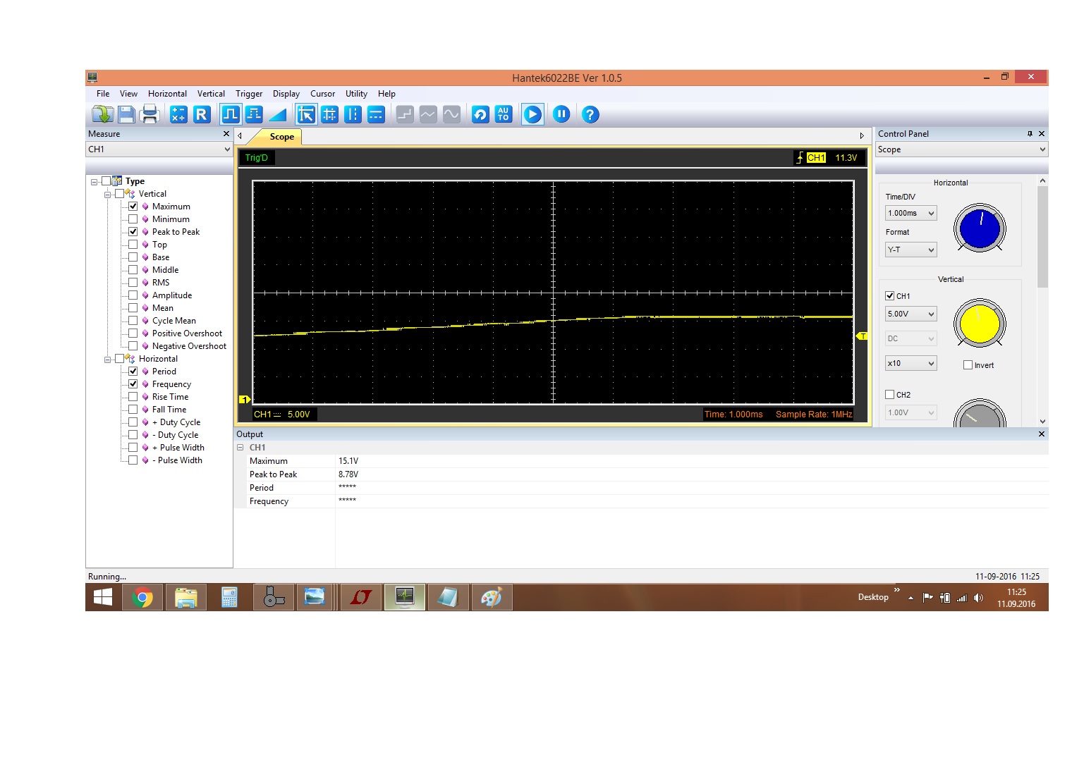

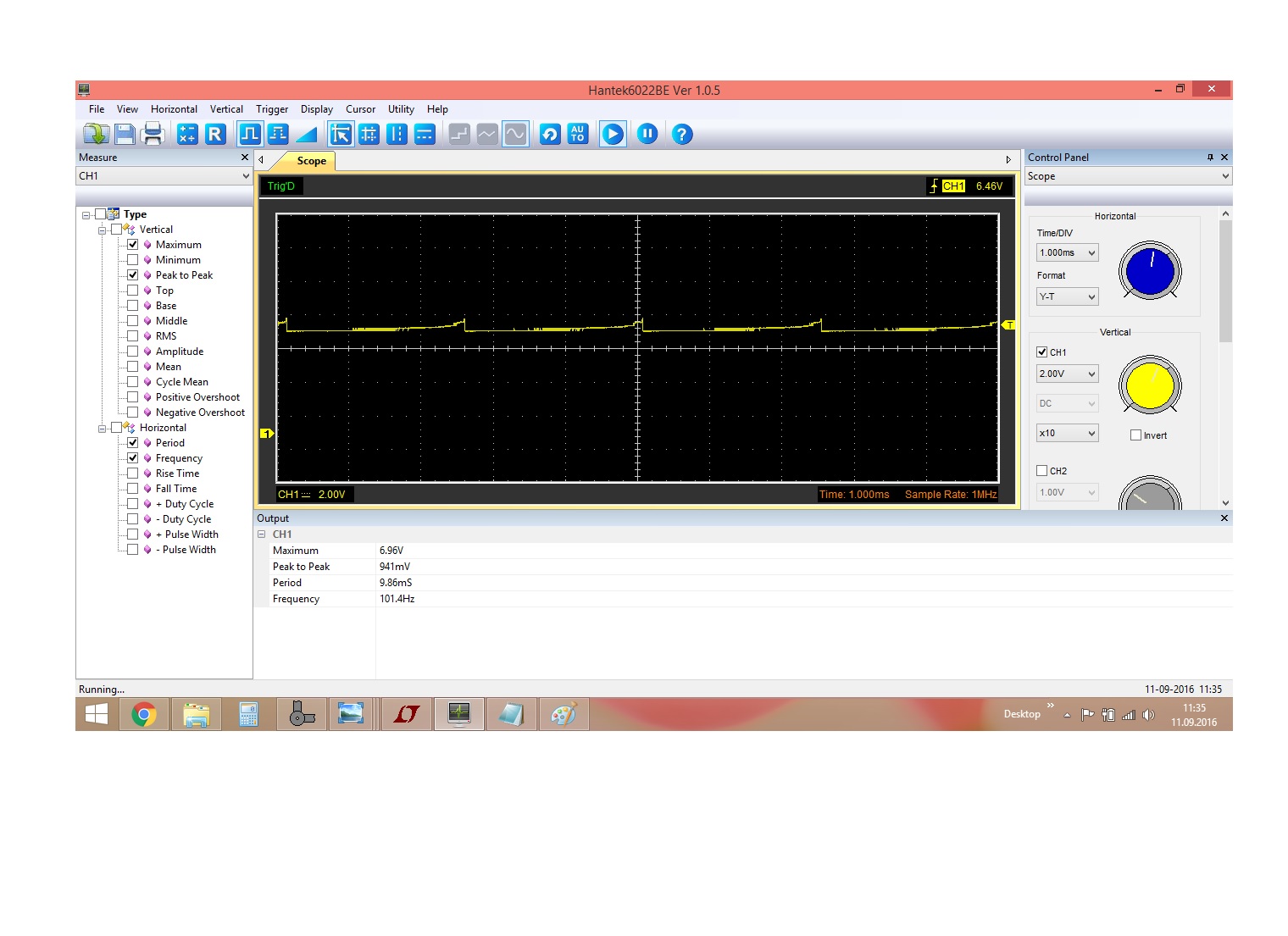

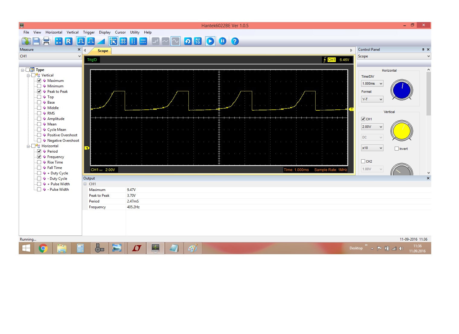

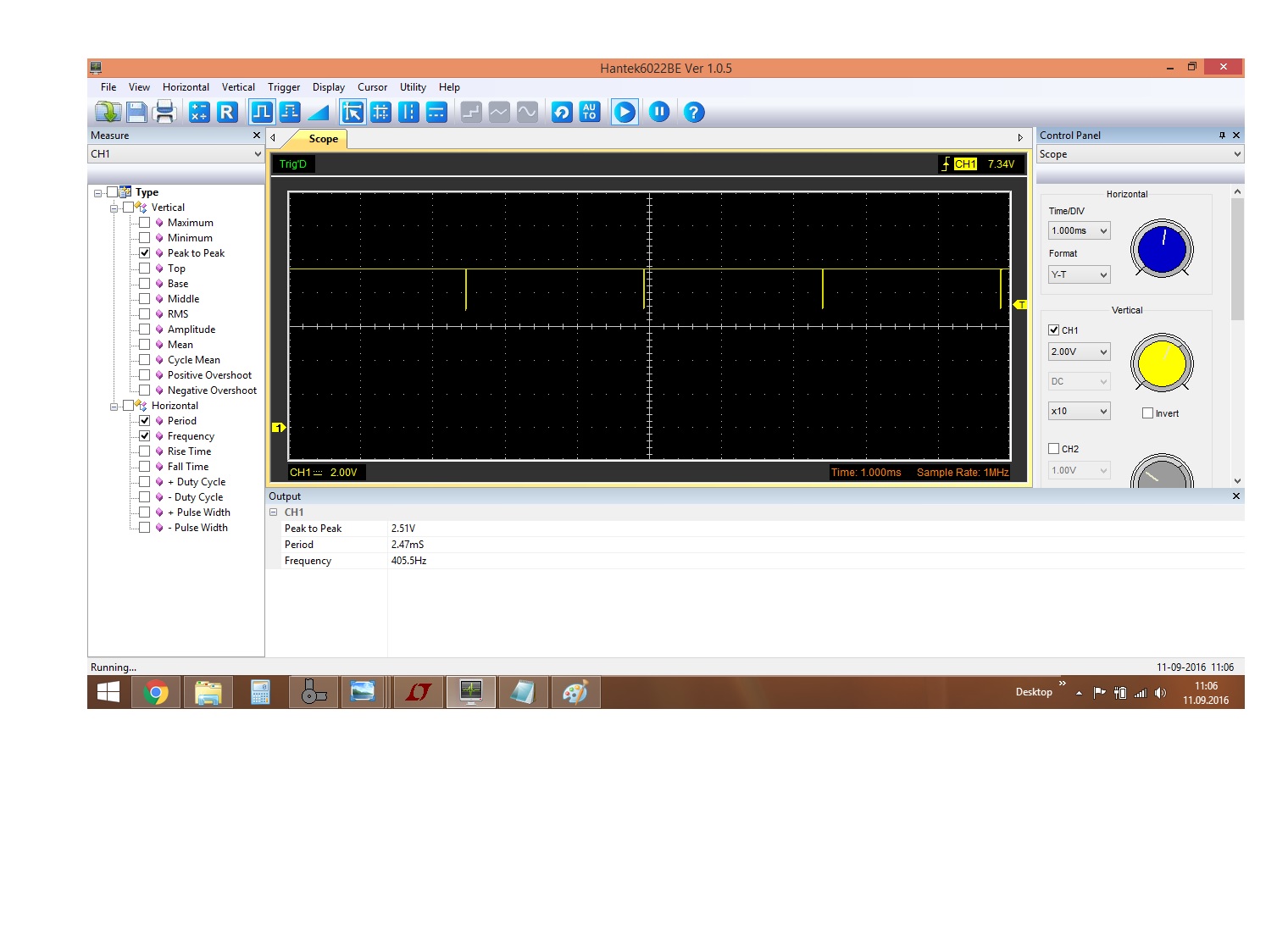

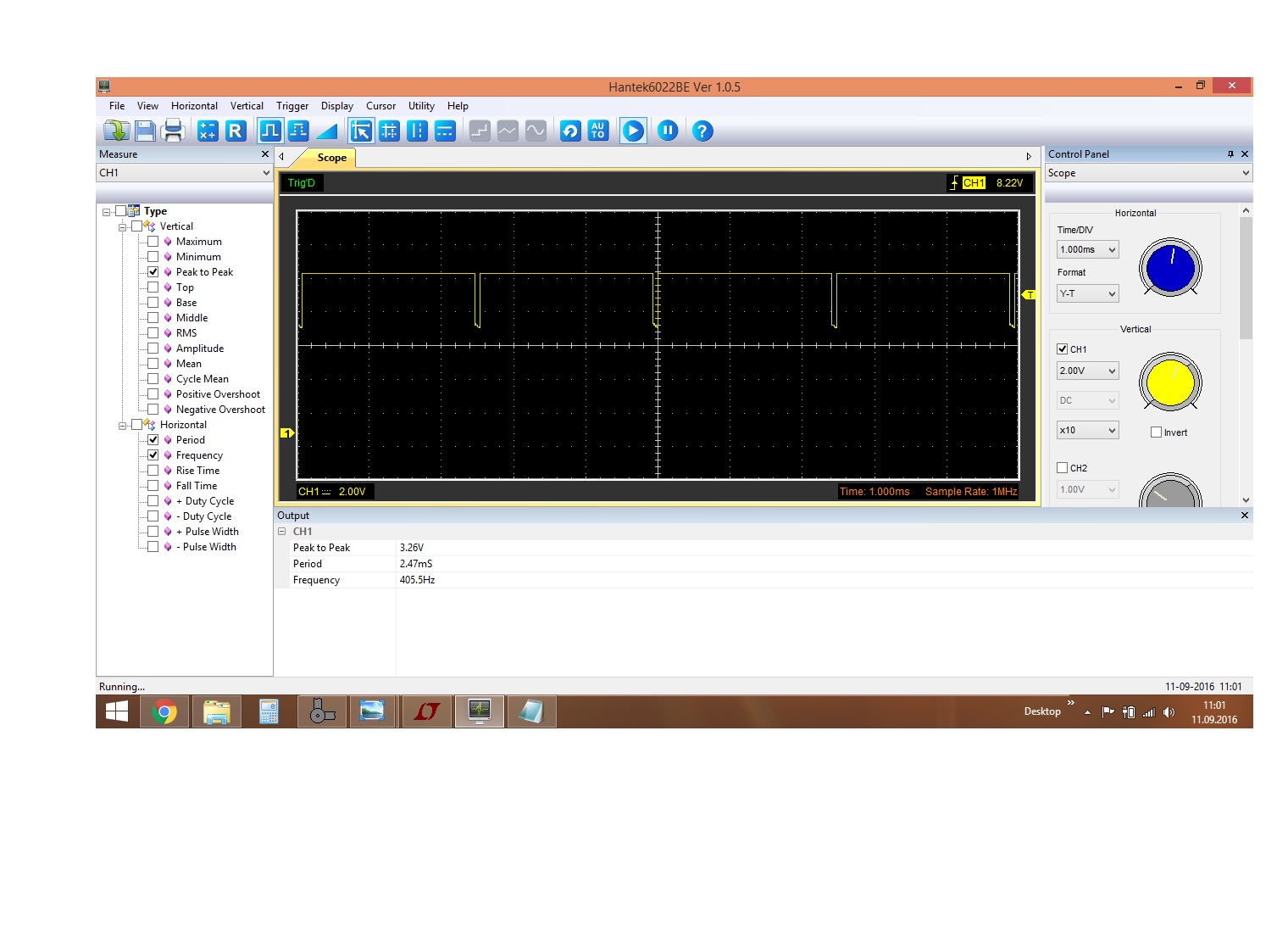

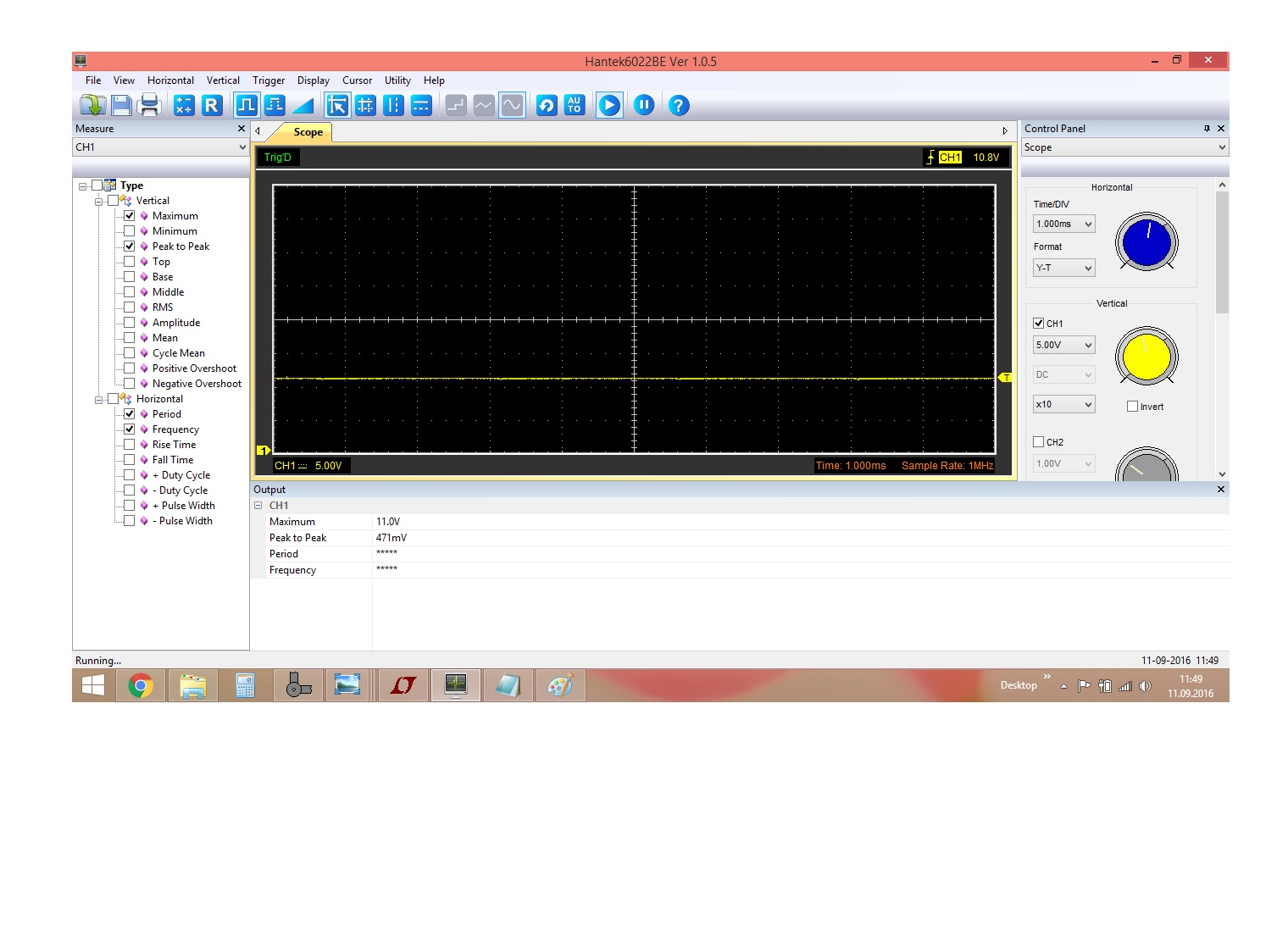

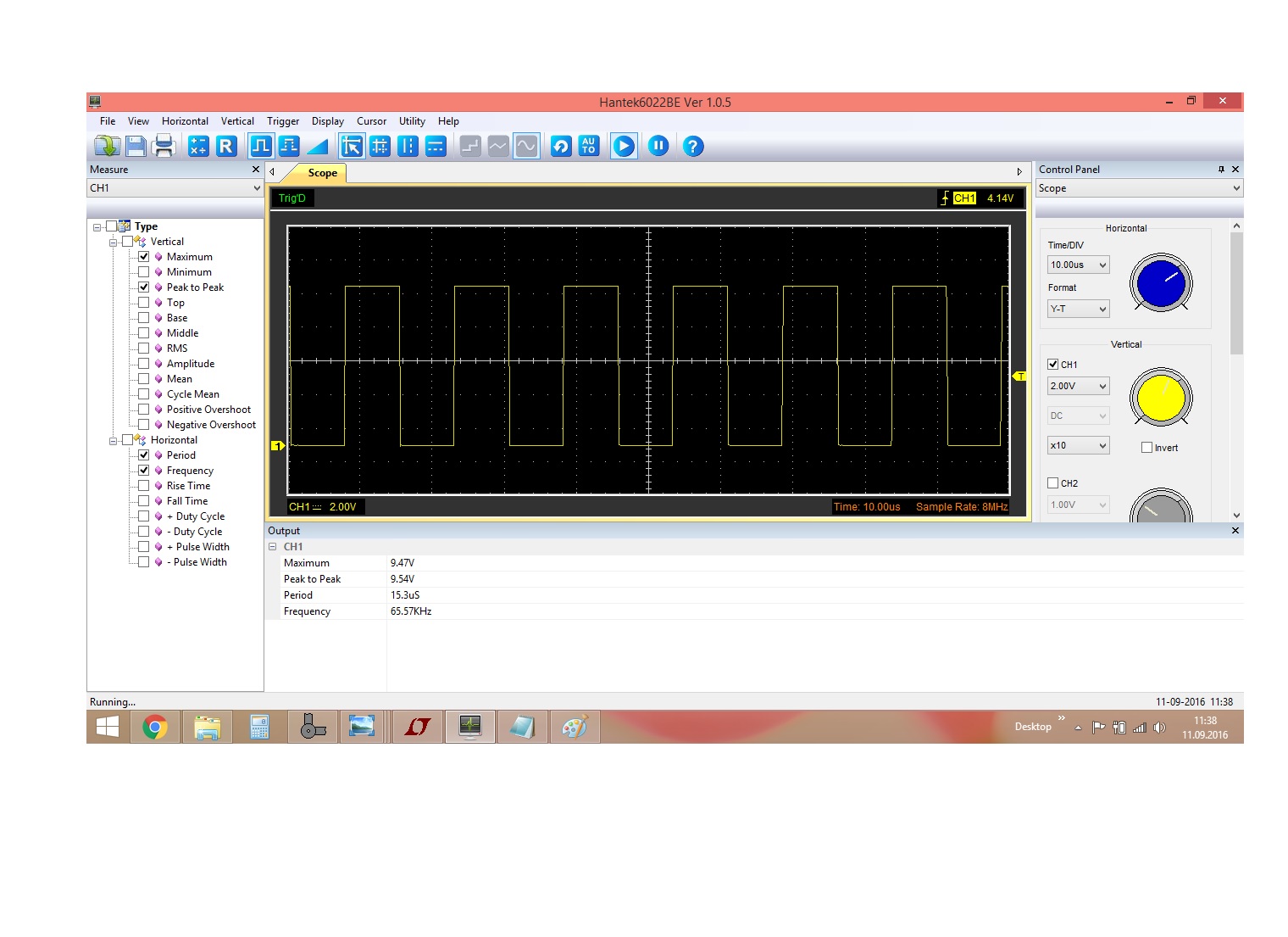

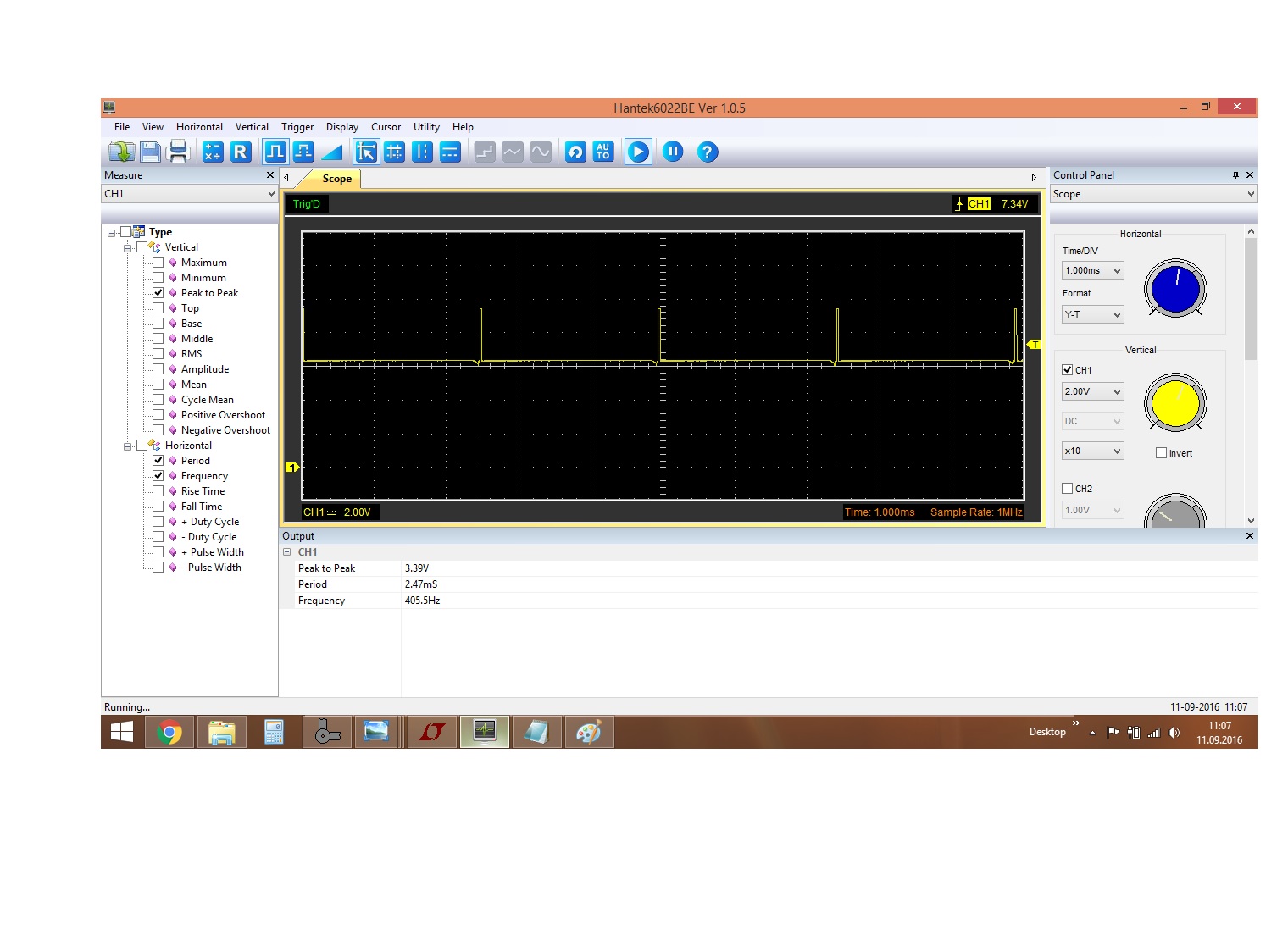

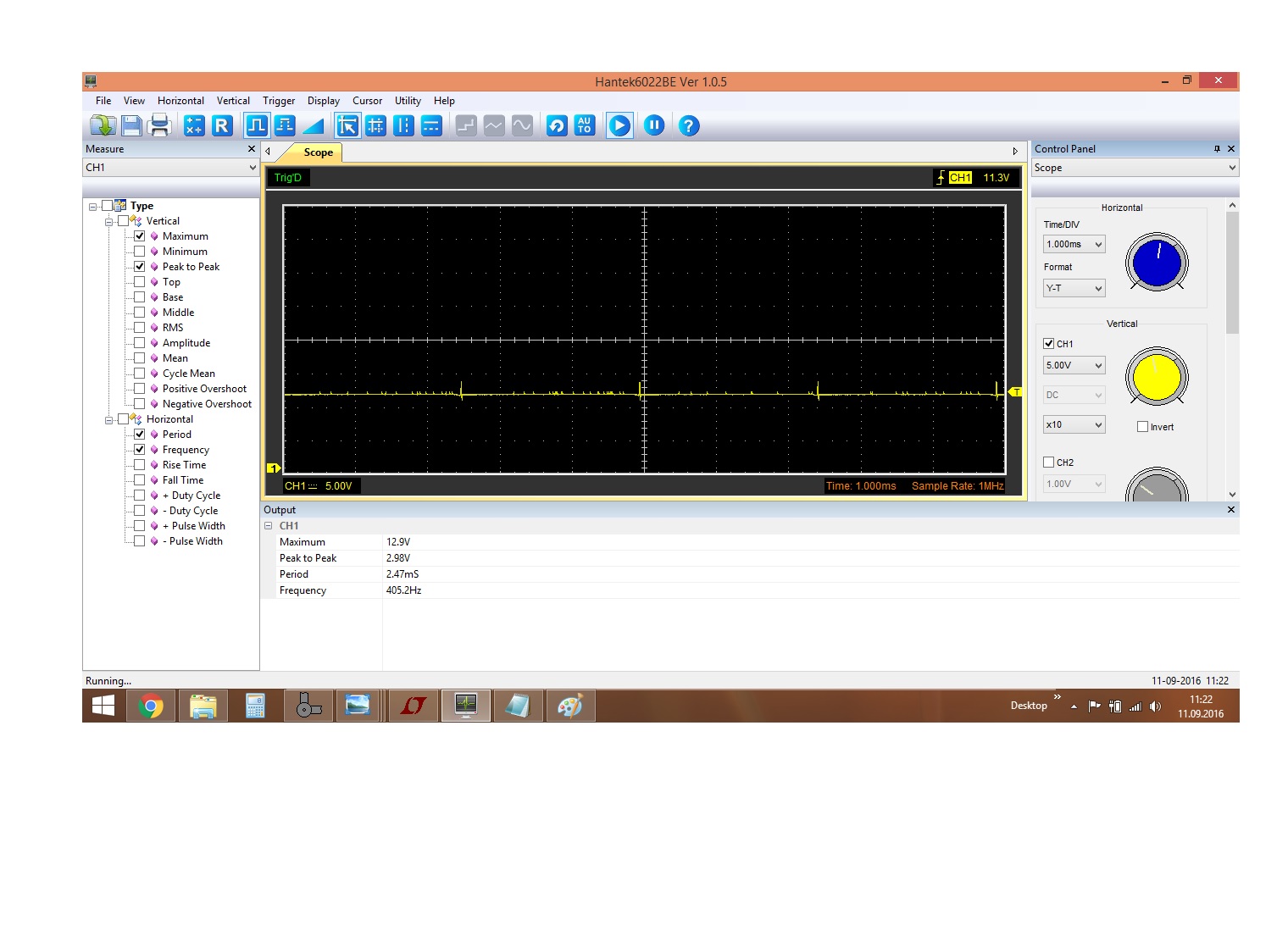

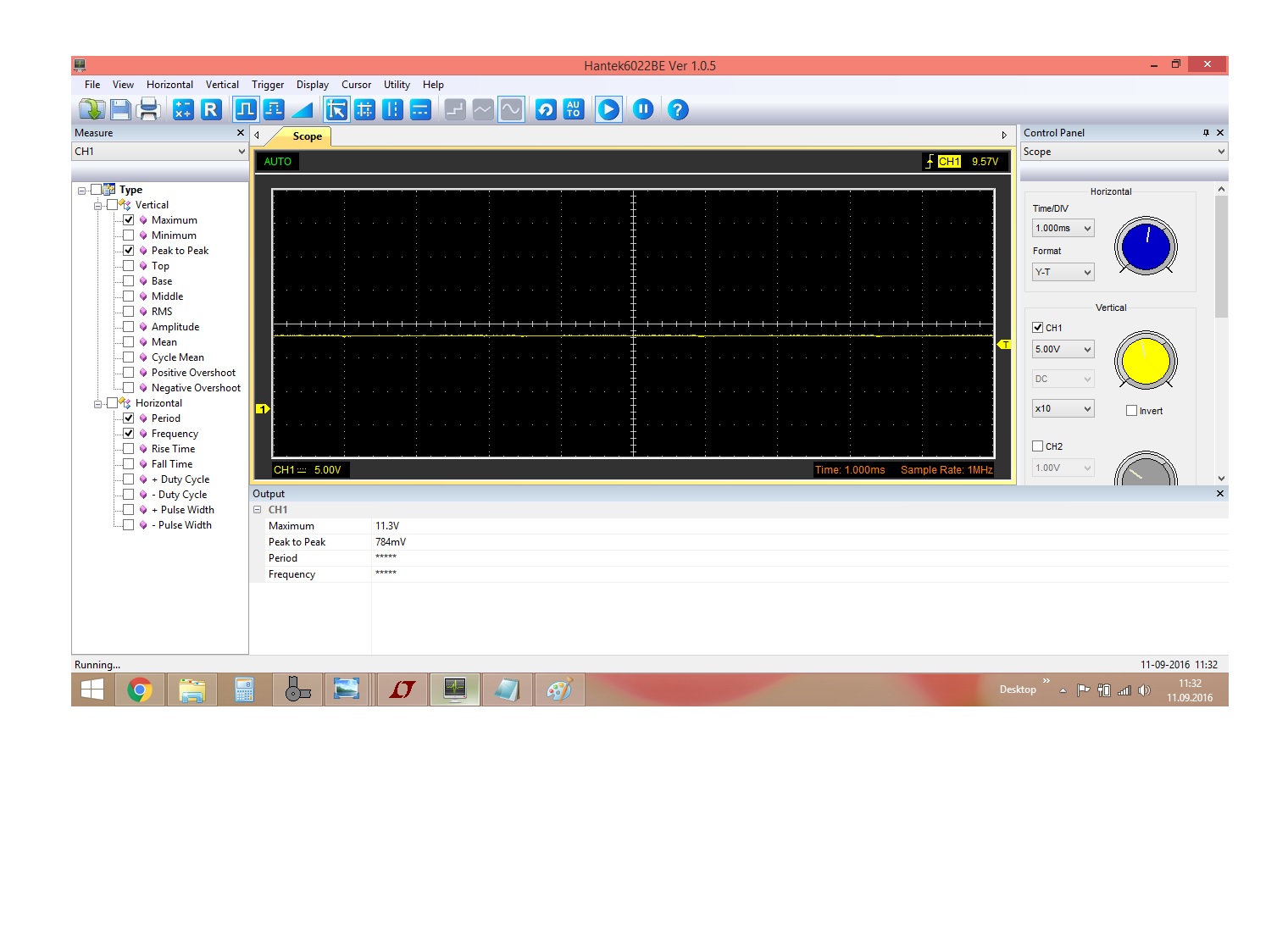

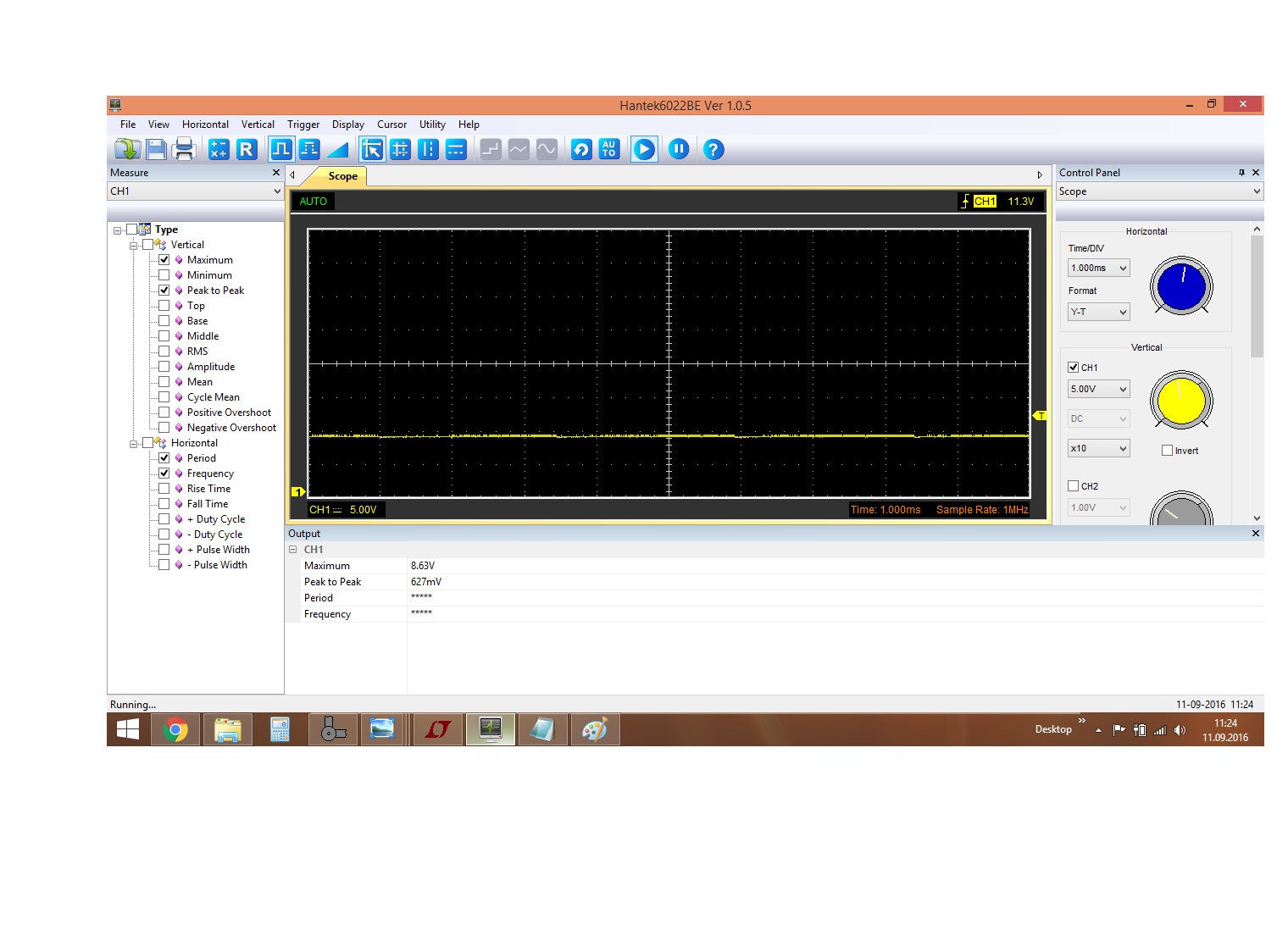

                      • Okay I also made some measurements, yesterday they was not correct, because the battery was empty.
                        Yes Arief, be careful with power supply, first you have to get the correct value +5V
                        after charging pump 555 and the two transistors!! Do not put any other IC in your board,
                        before you check all IC sockets, they must have the proper power supply.
Name:	battery voltage.jpg
Name:	555 pin 3 charging pump.jpg
Name:	Oscillator 555 pin3.jpg
Name:	output 709 pin 6.jpg
Name:	4066 pin 13.jpg
Name:	4066 pin 9 without target.jpg
Name:	324 pin 1.jpg
Name:	324 pin 7.jpg
Name:	4066 pin 9 with target.jpg
Name:	324 pin 8.jpg
Name:	324 pin 14 without target.jpg
Name:	324 pin 14 with target.jpg

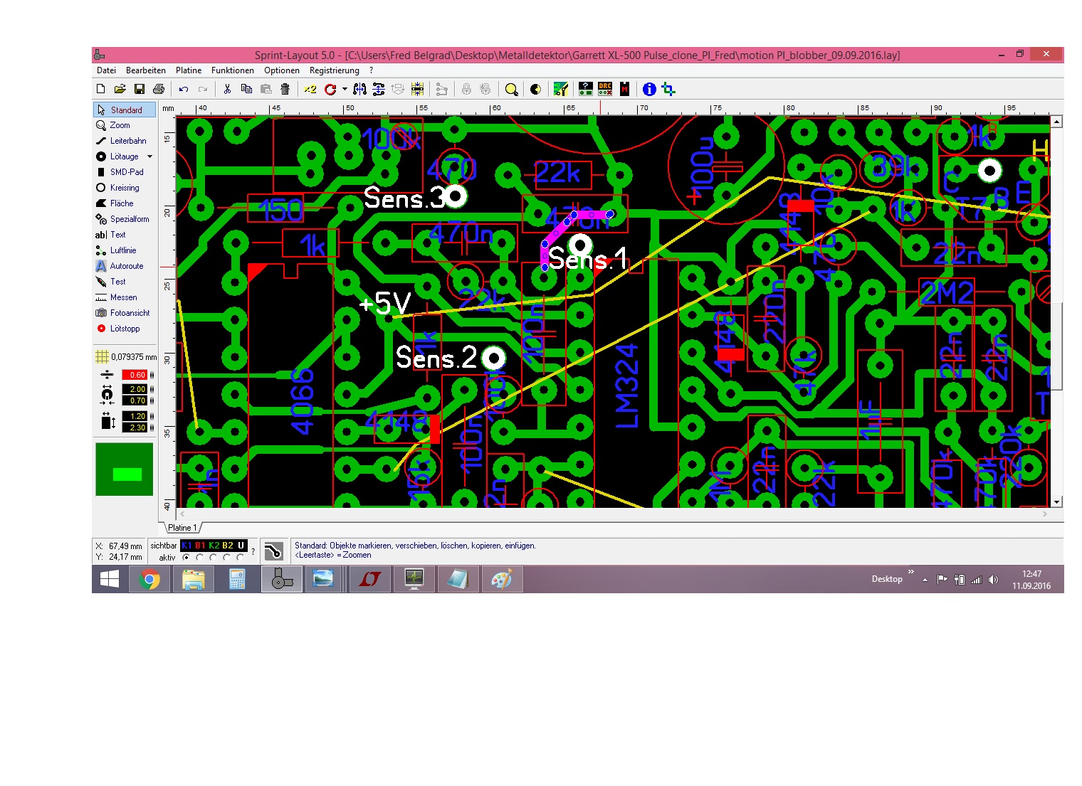

                          • Did blow all the ic? The input of 78L05 is 12v output is same, is it dead?
                            • That is possible, with too much power supply.
                              Sorry friends, I found a mistake in my layout file.
                              I was thinking about the wrong value in the picture from reptooyep, around LM324.
                              Please try to change the connection!
                              I will look further for other faults of course...sorry!
Name:	wrong connection near 324.jpg
