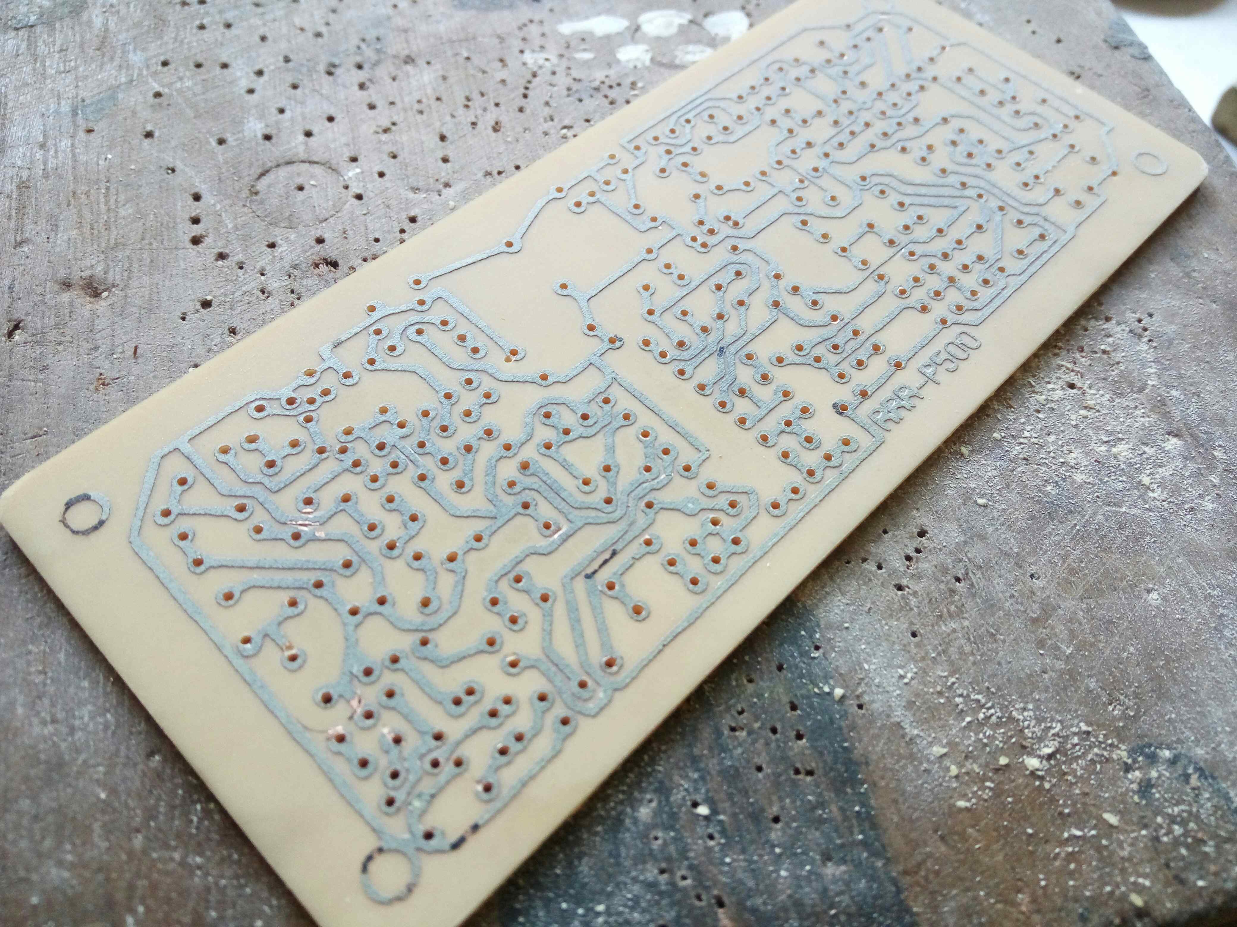

      Just get 0.5 enamel wire, will solder it all tonight.
      The pcb copper is very close to each other, should do manual way to seperate them, i hope this work.

        Nice work !! You should test the continuity if you have doubt. You should also do the same after soldering to avoid shortcuts.

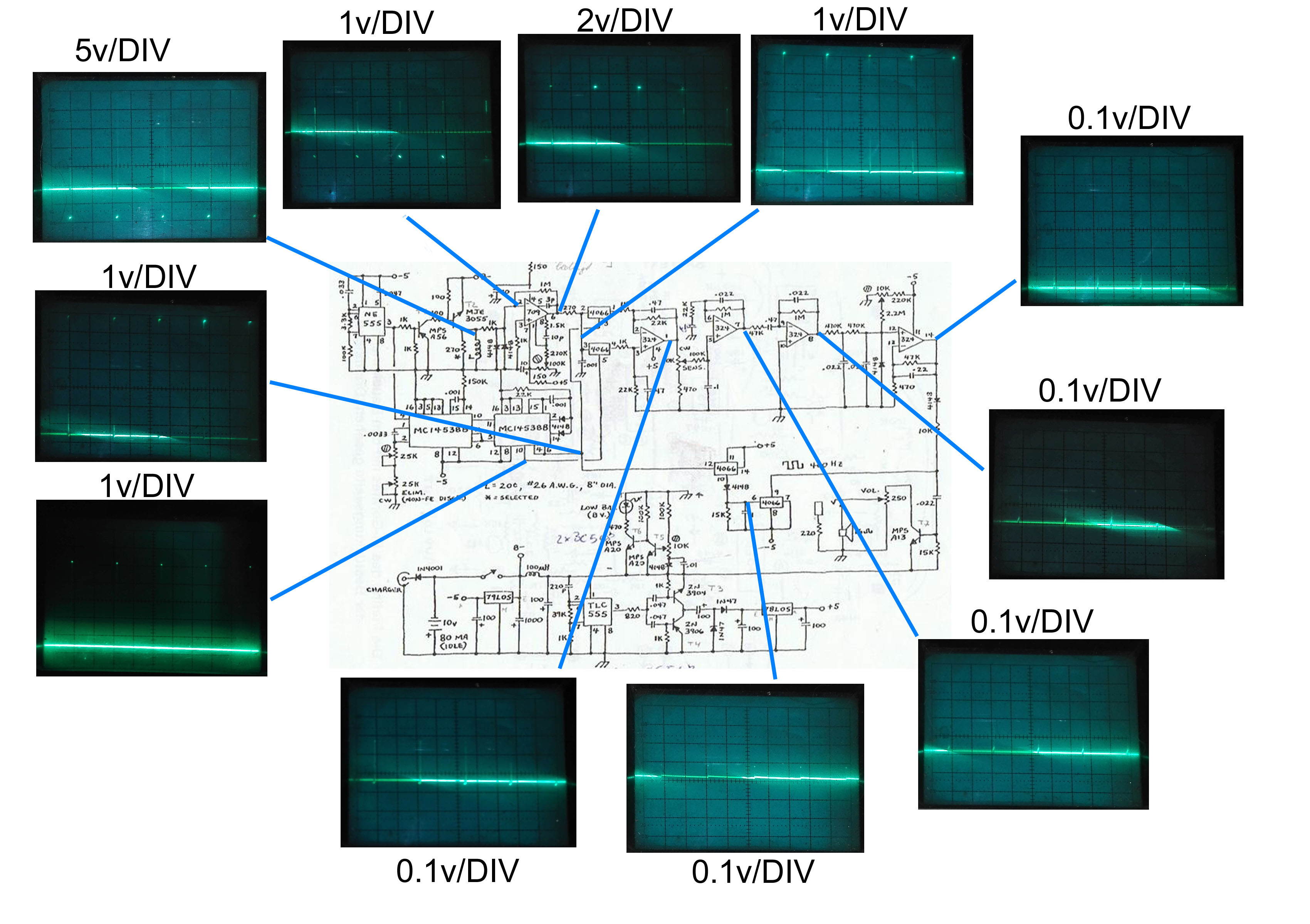

        Fred, i took pictures of some points on the board. Can you have a look ? I've put a LM318 in place of the 709. the output looks nice.
        On the output 9 of the 4066, i should have a 400Hz signal but i have nothing.
        The outputs 1 and 4 of the 4066 are about 100mv peak but the input is few volts. Is it normal ?

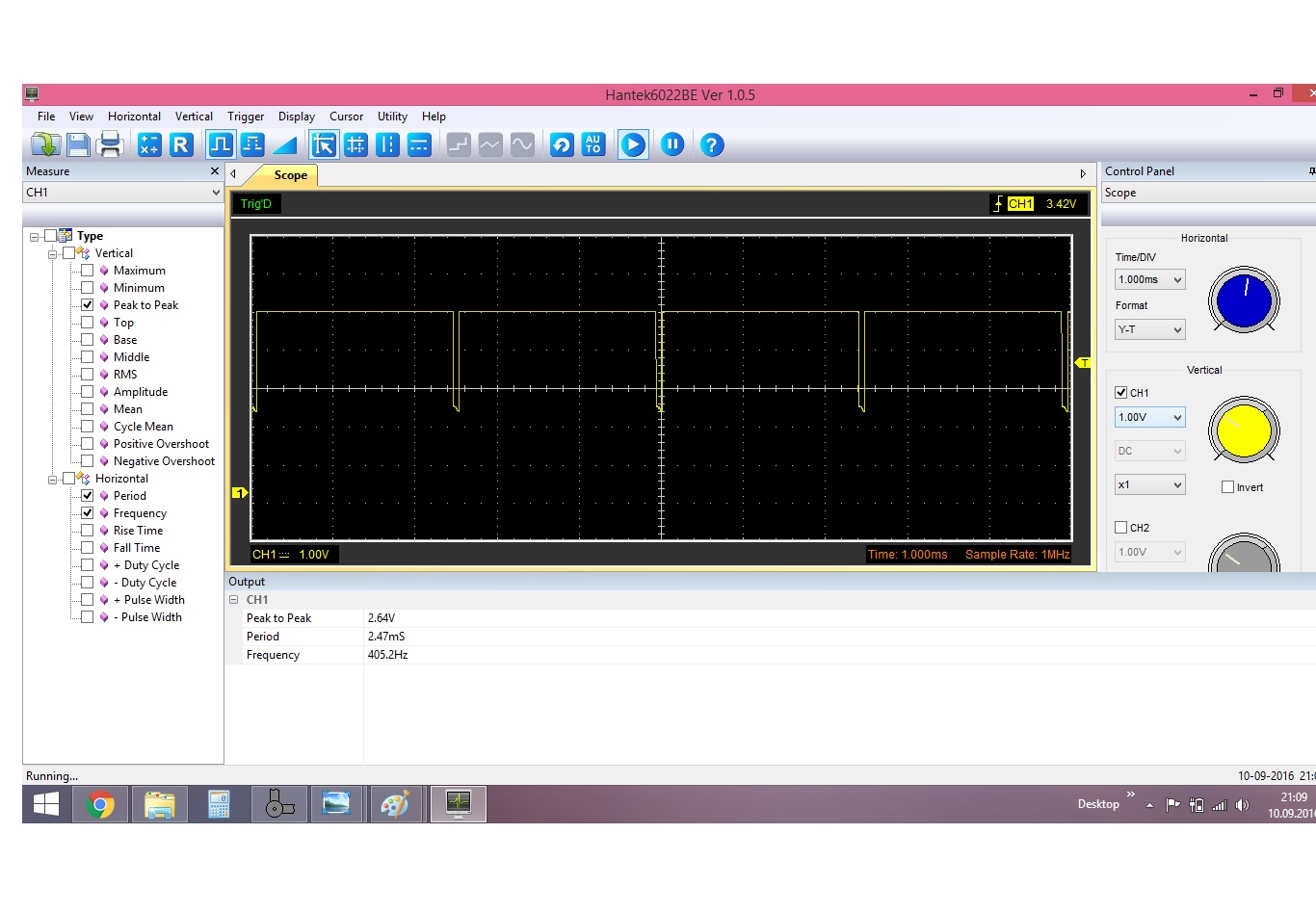

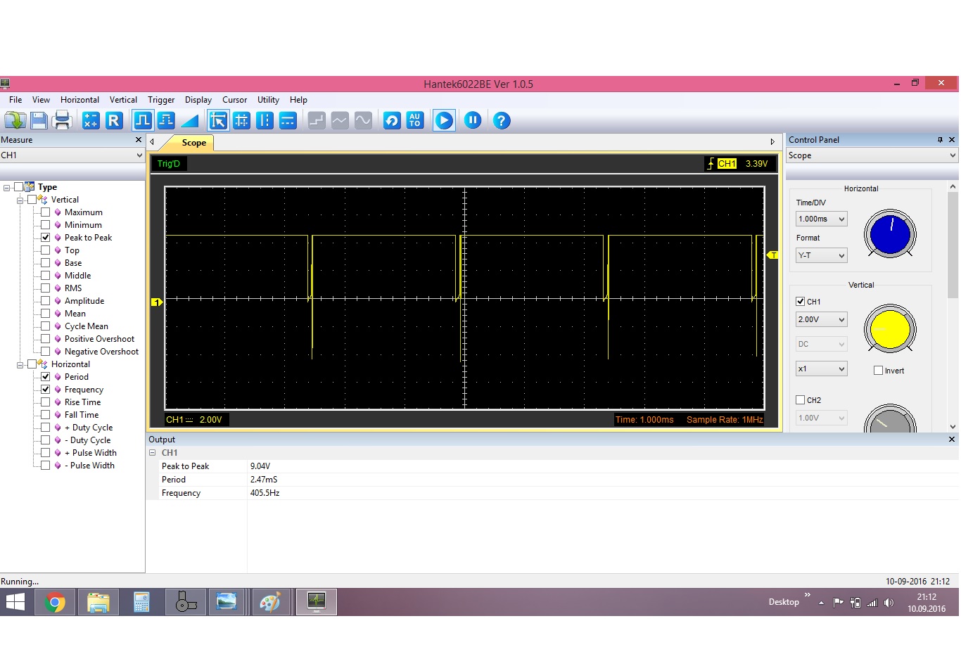

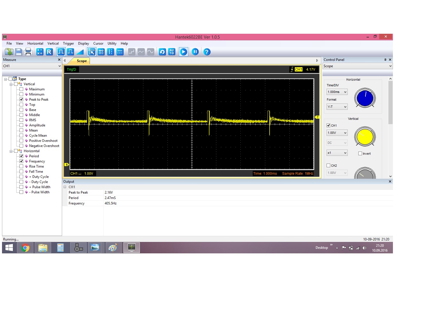

          Well, I have opened my box, to take some measurements.
          I have taken some screenshots.
Name:	Oscillator 555 pin3.jpg
Name:	output 709 pin 6.jpg
          The outputs of 4066 1 and 4 shows me 5Volt, also the outputs of LM324 1,7,8,14 always 5 Volt.
          Unfortunately my battery was empty, as I want to recheck this. Tomorrow I will continue..

            Have you seen my troubleshoot picture ?
            The output of my 318 seems good, according to your screenshot
