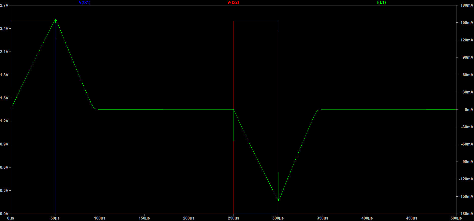

              The reason is the TX/coil current waveform... The detector is the Fisher Impulse which I believe was designed by Dave Johnson (Dave J). That is the problem I have with referencing sample time relative to TX-off. In my opinion, sampling needs to be referenced to the trailing boundary of the coil current waveform envelope. If you reference the sample timing to the trailing boundary of the coil current waveform enveope, the sample time for the Impulse becomes ~15 usec.
                Interesting about detecting a 3usec TC target with a 50usec delay. I'll have to try and understand how it does it.
                I'm curious to.
                  A view of the Impulse coil current in relation to TX pulse.
                  The impulse is a bipolar TX. By referencing the sample period to the trailing edge of the coil current envelope, the sample delay is < 15 usec (closer to 5).

                      That is the circuit! Note in the bottom right in the info block "FISHER - IMPULSE".
                        The focus on the impulse is probably dragging Green's thread a little off track. The reason I introduced it was to emphasize two points. (1) "minimum sample delay" to what reference, and (2) a fast coil circuit is not the only way to achieve detection of small resistive targets... there are other methods. I think the discussion of small fast tau target detection and the focus on the religeous need for ultra fast coils actually deserves it's own thread. There are a lot of moving parts to the physics that need to viewed and understood as an integral and not in isolation. There is no "holy grail"!!

                            If the objective is to measure the TC of AWG28 solid wire and it can be done without a fast coil circuit no problem. I've always referenced to coil off command thinking that made the most sense, maybe not. If there is a better way, I'm all for it.
                              ... I've always referenced to coil off command thinking that made the most sense, maybe not. If there is a better way, I'm all for it.
                              I have wrestled with the refernce point for well on to 2 years now. For it to have any meaning, "sample time" must have the same reference from circuit to circuit. Personally, I have come to using the point to where coil current has decreased to 1 mA, for my personal comparisons. That way, it takes into account the actual removal of excitation of the target and takes away some of the mystery of why one particular detector appears so sensitive to fast tau targets and another is not.
                                How do you determine when coil current has reduced to 1mA?
