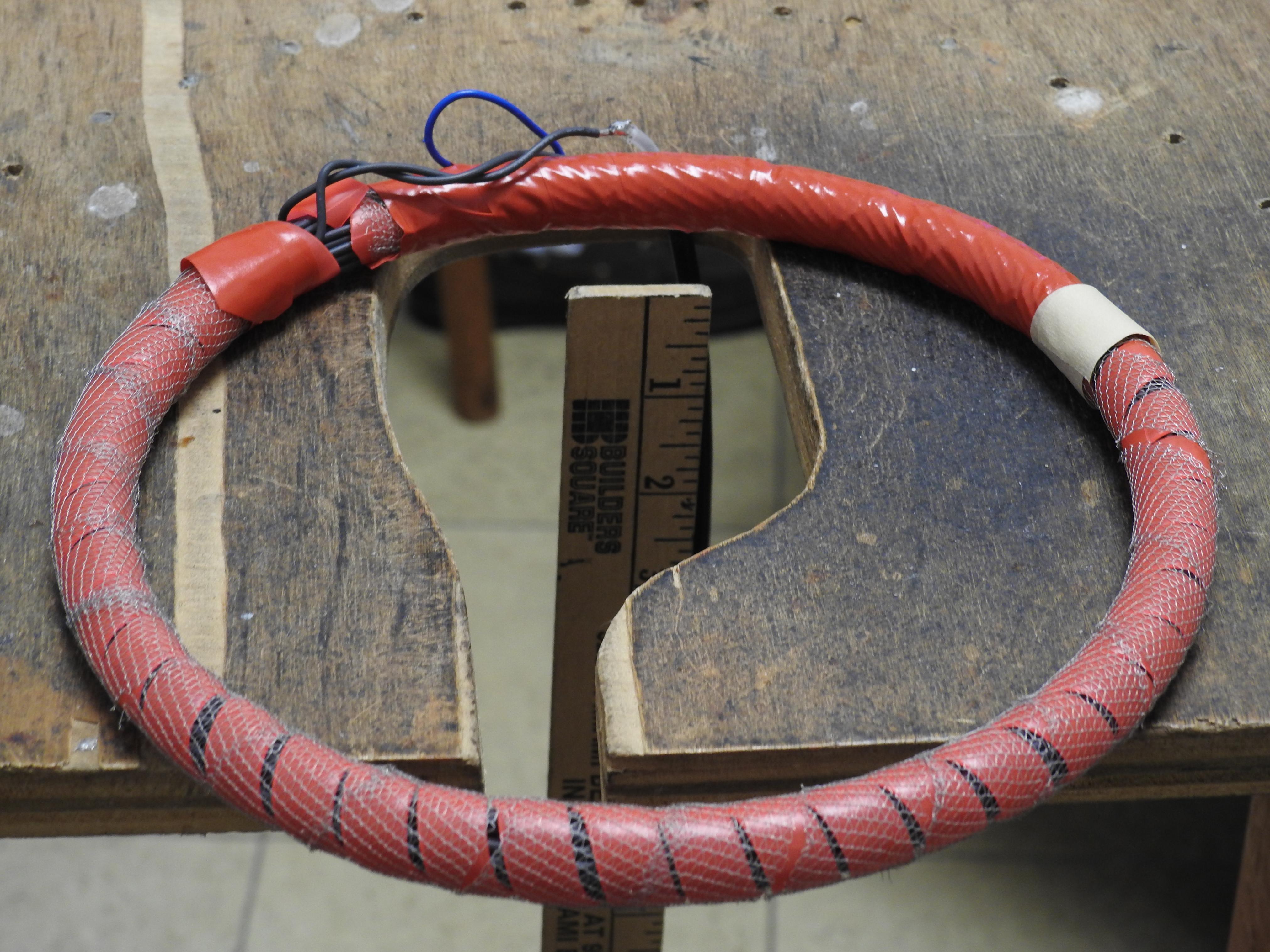

      With the little white coil you were useing, was it shielded ? were did you connect the shield ? thanks

          Yes the coil (8in) is shielded. The bare coil is held with polypropylene spiral wrap and then shielded with Scotch 3m #24 tape. The coil shield wire is connected to the RG-58 shield. This method I learned from BBsailors article and some of Eric's posts. see photo of a similar winding.

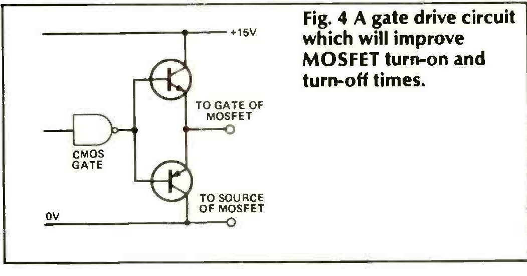

                          My thought as well for the transformers. There must be a better way of achieving this with discrete mosfet drivers, has anyone looked into that?
                            I can suggest a push pull topology to drive the mosfet. Winding toroids ain't my idea of a fun Sunday.

                              Winding is the easiest part of a story.
                              Question is in proper type of toroids and wire.
                              Various toroids are having various permeability.
                              Also the most closest wire specs to one used by initial author.
                              That has been always the headache.

                                Sure, so many parameters to be considered, requiring hours upon hours of tests. But once it is gotten right, then it will be great.
                                Problem is that this method is not easily transferrable to another DIY'er, because another man must source correct toroid, correct wire size and correct spacings of windings and then scratch his head when inductances and performance don't match the other guy's toroid.
                                This is what is known as "one man's toroid is another man's hell!"
