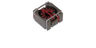

                    As for reducing the footprints, I saw this picture. Something for the future, a special purpose surface mount toroid, tailor-made for your needs.Click image for larger version

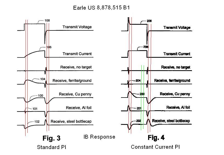

                            I agree with all of the comments about the transformers being a pain. But after JL, MDToday and I went through the no name Chinese toroids. We have found the right materials for the cores. These can be purchased through Digikey, Mouser and probably Farnell for under a $1 a piece. Then add 4 to 8 turns for a primary and 14 to 20 turns for the secondary. You have a gate drive transformer. Unfortunately three opamps and a few transistors isn't going to get you a ground balancing discriminating pi. Or a multi-frequency vlf or hybrid detector. Thus the next level.
                            So why the complexity? The Vallon, Dave Johnson and John Earle circuits all have one thing in common. They use a reservoir capacitor which holds a high voltage charge. When the Tx is triggered on, 75 to 220 volts is dumped into the coil. The current ramps up in micro seconds to almost a constant state. Johnson and Vallon use the alternating flyback energy to charge the holding capacitors. The alternating flyback is why bipolar is needed. I assume a mono polar pi with a boost supply could achieve constant current? Earle's is not clear to me, if it regenerative or switch mode boost supplies? The key here is constant current in the Tx coil, at this point ferrites become less detectable. Sampling during the Tx period with an IB coil, allows us to determine ferrous/nonferrous. On a standard pi, the current continues to flow during the TX period so it is affected by the ground. The relevant patents are listed below which go into fine detail. See below JPG cut and paste from US 8,878,515 which summarizes cc vs standard pi.

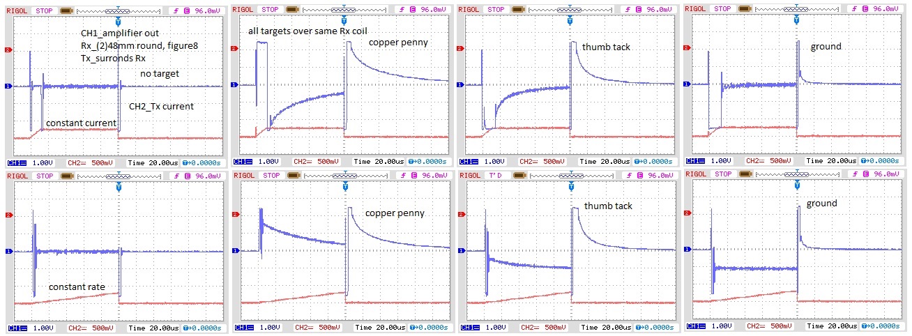

                            I've been trying to understand why the complexity. It's being done, JL's thread for one.
                            I'm thinking need to look at X signal to determine ferrous non ferrous, when current is changing or very shortly after. Can't determine ferrous non ferrous after current is constant at zero or some value. The JPG constant current traces https://www.geotech1.com/forums/atta...1576345487show the penny and bottle cap to be opposite polarities, true during charge and discharge not after current is constant. Ferrites are most detectable during charge and discharge. Maybe I'm missing something or there are other reasons to to do it?
                            Including some scope pictures. Not the same constant current(takes longer to charge than discharge)but I think show polarities for ferrous non ferrous targets.
                            Tx current reference(amplifier common)is 2.5V above zero current so zero current is -2.5V.
                              Hi Green, I am no expert. I just study the patents and do actual experiments.
                              Pure ferrites don't develop eddy currents, so once the current quits flowing their influence on an inductance balanced coil decrease. While conductive metals develop eddy currents and continue to affect the coil balance after the current becomes steady . Iron exhibits both a strong X and lessor R component, this affects the coil balance in the opposite direction. Sorry, I can't give a better explanation.
