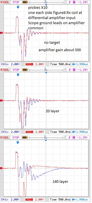

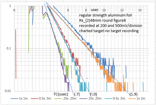

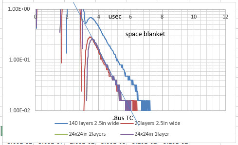

                          What I tried so far. Didn't get a usable signal with two mono coils or the 8inch figure8 Rx. Got a usable signal with 48mm figure8. Decay looks good but doesn't make sense. Including a chart. Tried to find aluminum thickness for a space blanket to calculate what TC should be without success. Just replied to show I tried, will try again. Might need to change something to measure a TC less than .8us.
                                More tests. I think the reason the decay didn't make sense(REPLY #57) is a large input causes the amplifier to overscale and the decay is the amplifier stabilizing. A large ferrite core toroid causes the same decay signal. Recorded the coil signal with the 20 and 140 layer targets reply #57. Differential Rx coil signal with the 140 layer target over 2V, 6mV over scales the amplifier. Didn't find the aluminum thickness for the space blanket but did find 3 to 50nm thickness for metalized Mylar. If I did my math correctly 50nm would give about .1us TC for a piece 24 inches square. Would have thought the 140 layer target might chart over 1us TC. Maybe to much space between layers? The layers were compressed between two layers of cardboard, think mostly Mylar spacing not air. Charted a 1, .5, and .25 inch piece of regular strength aluminum foil. Think the next smaller piece should have a TC half the larger. Think maybe my circuit response is causing the shorter TC targets to chart higher than expected. Think coil wire size, coil L/Rd and amplifier response effect the accuracy of he charted decay. Think their TC should be at least half(probably less)the desired target TC? To record a .1us TC, wire size AWG34 or less, amplifier response about 3MHz and coil L/Rd about .05us(circuit resonance=6MHz)? Having a salt target would be nice. Search salt gives 4 pages, search salt in the title gives 1 page. https://www.geotech1.com/forums/show...highlight=salt a thread that has some replies for salt response. The replies suggest a TC closer to 1us than .1us. I'm thinking if the 24 inch square piece of space blanket has a TC close to 1us I could measure it. Don't know what salt TC is and how much it varies with location? More questions than answers.
