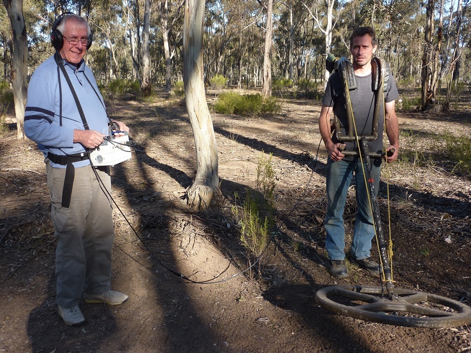

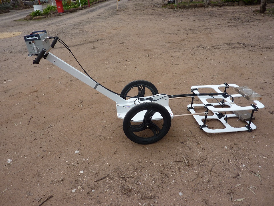

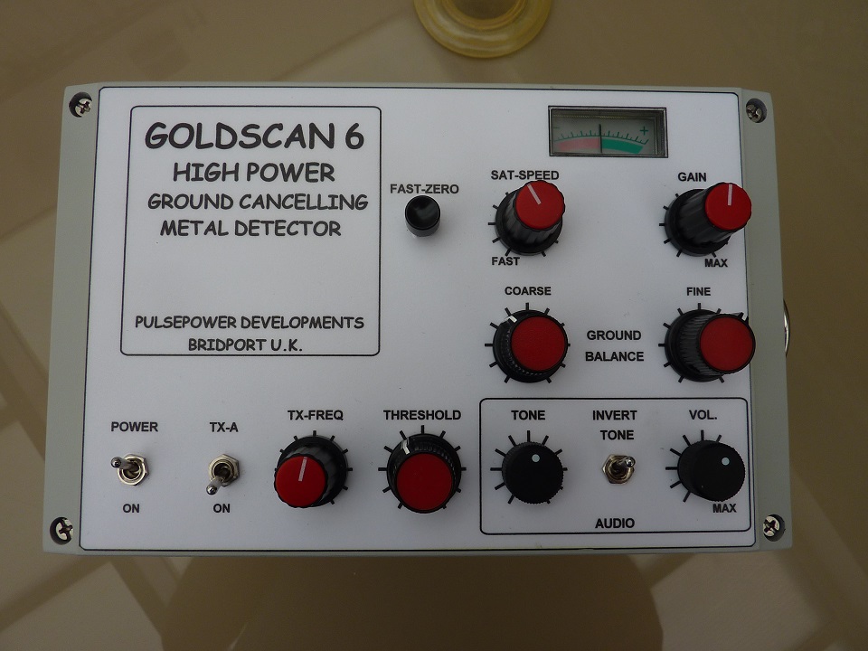

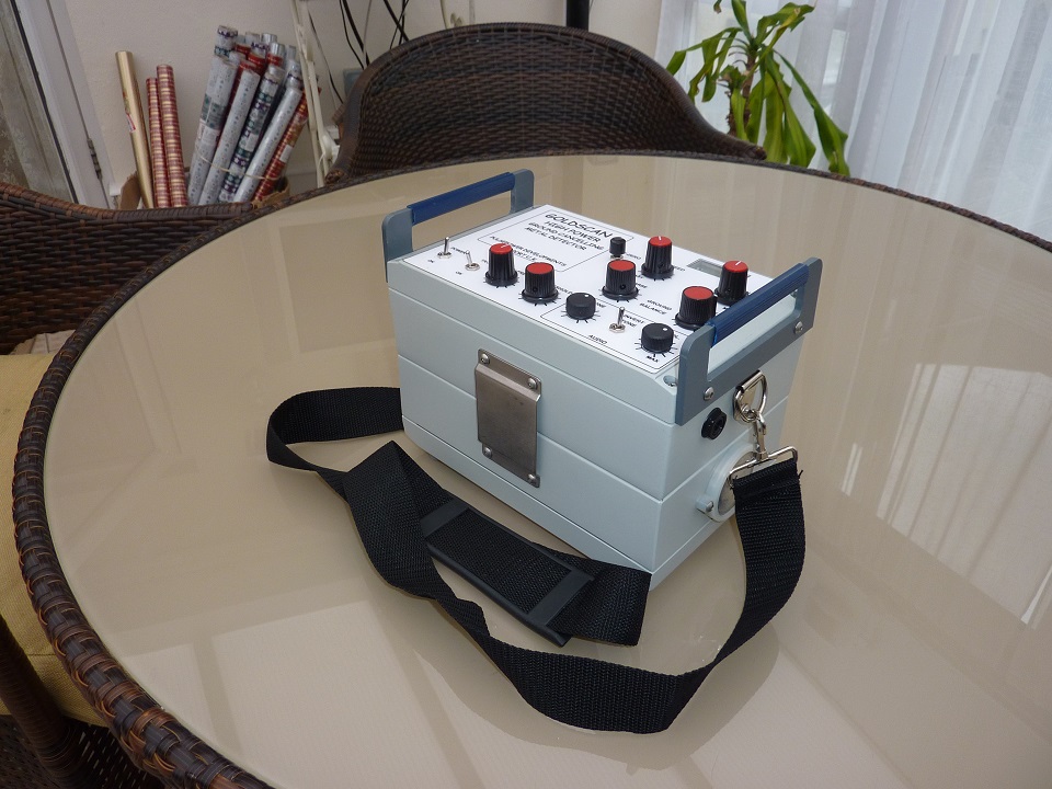

    Problem solved in 2012 with Goldscan 6. High power TX with Fan cooling, 24", or larger, coils which can be differential for noise cancelling. Waist or trolley mounting, GB that works in Australia which has much stronger mineralisation than anywhere else. Not a DIY project but have one for sale for GBP5000 (freight extra) with 24" mono coil and shaft. The one possible DIY bit is to make your own trolley with no metal parts.

            [ATTACH]47327[/ATTACH] [ATTACH]47328[/ATTACH] [ATTACH]47329[/ATTACH] [ATTACH]47330[/ATTACH]
            Wow..this MD is so nice..but i think its very expensive and i cant afford it at this moment..maybe sooner or later ������ how much is this GBP5000?
