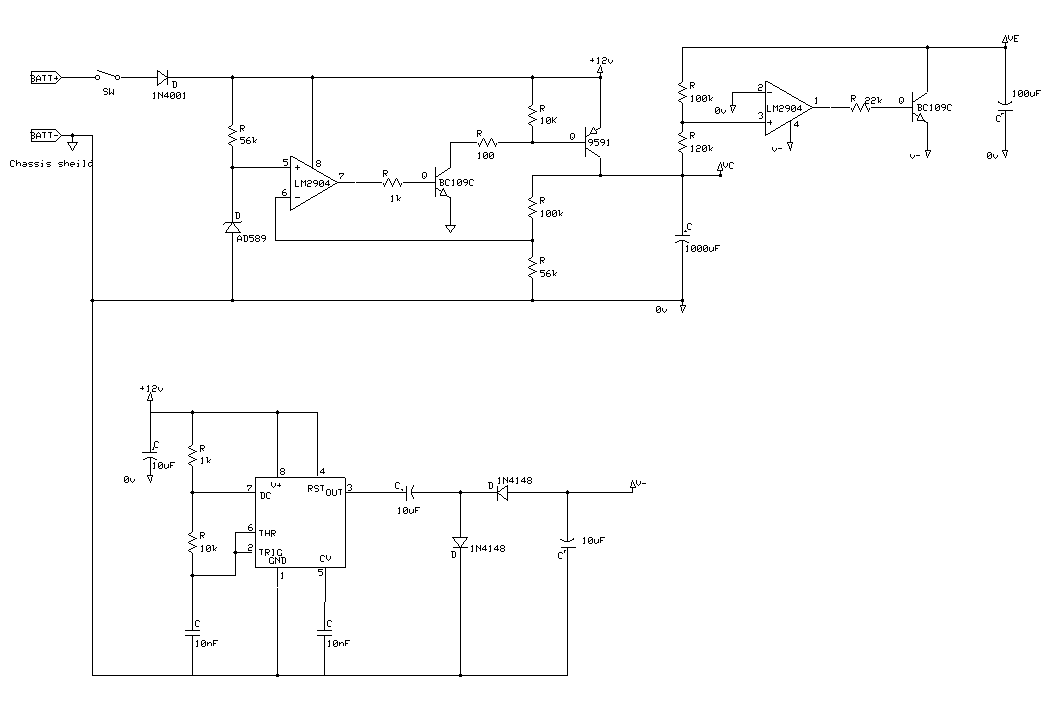

        Here is the modified power supply circuit I intend to implement. I use a 555 timer as a negative voltage generator. Now somebody can tell me if this circuit can work in place of the original. I think I'll be needing a replacement for the BUY92 transistor.

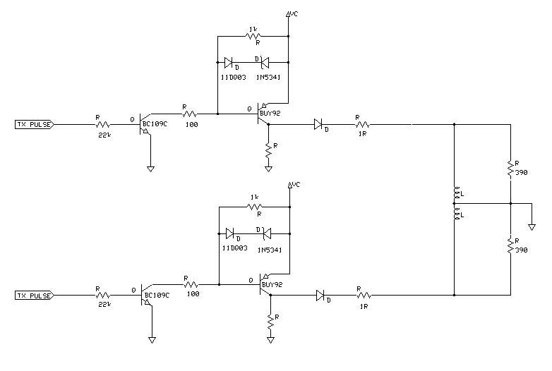

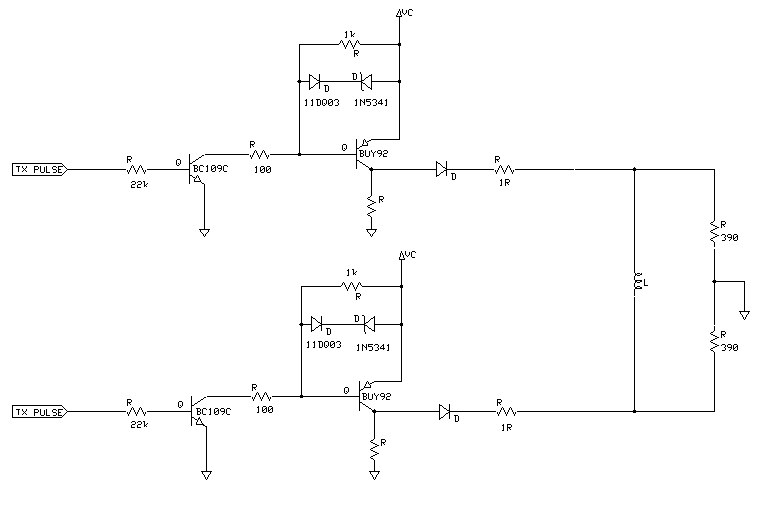

          Now I will have a look at the bipolar drive circuit.......more BUY92's.....overall the two halves of the circuit are identical. I'll redraw the circuit so it can be more easily interpreted. It's time to have a look at the BUY92 data sheet in more detail. Here is the datasheet for the 1N5341 zener. And if I'm seeing right, a schottky.
            Now here is a clearer view of the bipolar TX drive circuit, much easier to follow. Seems uncomplicated. Now to figure out just how it works.
            Carl, anything to say?
            I need to know what are the pulses driving this array. That's going to require modeling the timing circuitry.
              Looks about right.
              I use 2N3904 & 2N3906 for all my generic bipolar needs.
                You need to add a center-tap ground on the coil... the '108 uses bipolar pulsing by alternately pulsing each side of a center-tapped coil. The SK2 side therefore generates both a negative flyback and a mutually-coupled positive flyback that are used as the RX signal. Same thing happens on the SK1 side, except those drive comparators used for (it appears) fault detection.
                  I appreciate your feedback Carl, so the coil is definitely centre tapped, I have amended the schematic.
                  I think the comparators are supposed to monitor the symmetry of the drive train pulses, after all, you want fairly equal energy dissipation about the centre tap of the coil. I think I just confused myself.

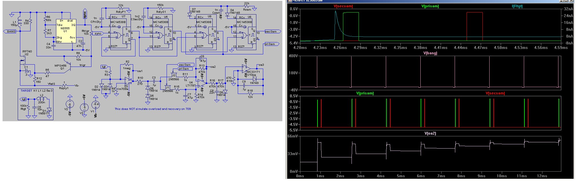

                  Anyways, I now move on to ltspice simulation of MC14538's, and associated circuits. I have to look for a model for the 4538 and others.

                      I found this model for a CD4538 here on the forum, does anyone have other models, or can offer any advice?
                      I also see somebody did this simulation of garrett XL500, you can see 14538 in it. Now if only I can find the thread where this came from.
                              Hi Dbanner do you still have the .asc file for that xl500 ?, saw it years ago but lost the file, thanks.
                                No, it is not my file. porkluvr posted a screenshot here:
