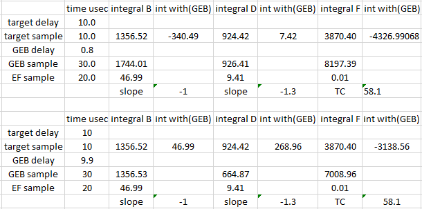

    I'll post a simple diagram tomorrow. What I have been doing 100us Tx, Sample delay 10us, sample1 10us, GB Adjust(delay) 0 to 50uS, GB sample 30uS. This repeats for the negative cycle. Signal = (Sample1 + (-sample1)) - (GB + (-GB)). The differential integrator takes care of the sign on the negative samples by inverting them. Not sure if this is the best way, probably better schemes. If you change the sample delay the GB needs re-adjusting.
    Tried your timings with Excel. With ground slope -1 and -1.3. With bipolar Tx adjust GEB delay until target sample and GEB sample are the same. With unipolar Tx adjust delay until[int with(GEB)] is minimum. I have been setting GEB delay about 4us and GEB sample about 100us. Adjust target delay 6 to 20us, then adjust target sample to adjust ground balance. Not saying it's a better way. Either delay or sample time could be adjusted to ground balance.
      Nice spread sheet Green. There are numerous combination that would work as long as you can get the teeter totter to balance. If you didn't see it already, here is a video of the scheme I used https://www.youtube.com/watch?v=HKHWsdSx6Bw
