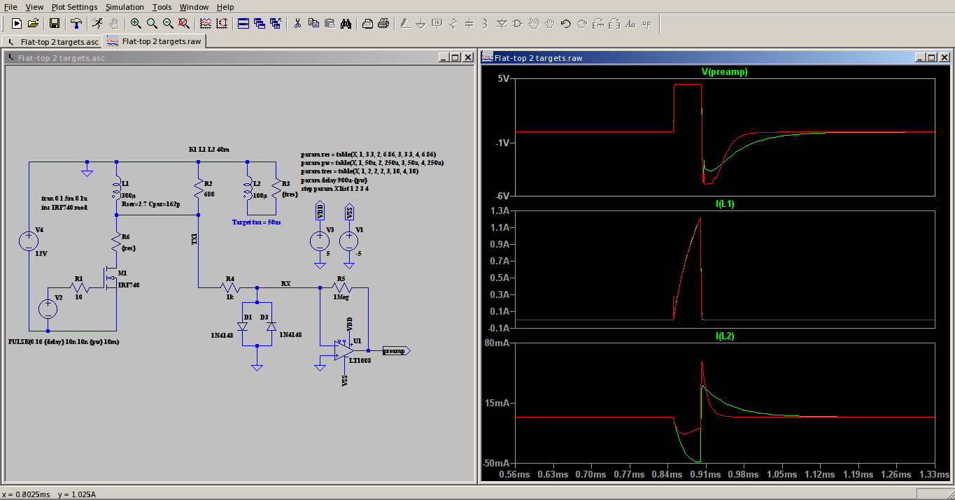

    I'm gonna offer a different explanation. Suppose that the TX pulse width is wide enough that the coil current has flat-topped and target reverse eddies have decayed to zero. The TX current then steps to zero, and this step induces a step EMF in the target. The induced EMF is the same regardless of the target (EMF = -dPHI/dt). The EMF produces an eddy current i = EMF/Z (where Z is the "impedance" of the target, which is a combination of metal conductivity, skin depth, and size/shape) and the eddy current produces the reverse magnetic field sensed by the coil as another EMF (the voltage you see with the scope).
    Nickels have a higher "impedance" than quarters so you would expect the initial eddy current to be lower, and thus the initial reverse field to be lower. But all this assumes a starting eddy current of zero at the TX step. If the TX pulse is not wide enough, then targets will have a reverse eddy current flowing at the TX turn-off step and this directly subtracts from the t=0+ forward eddy. High tau targets require a much wider TX pulse to kill the reverse eddies so for a given TX pulse width you should see a progressively lower starting RX voltage for progressively higher taus.
    A way to test for this is to widen the TX pulse and see if the higher conductors start increasing. Eventually they should surpass the nickel.

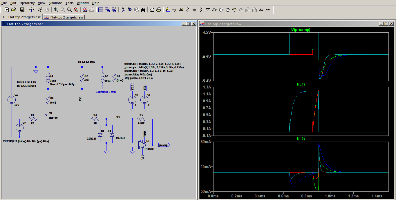

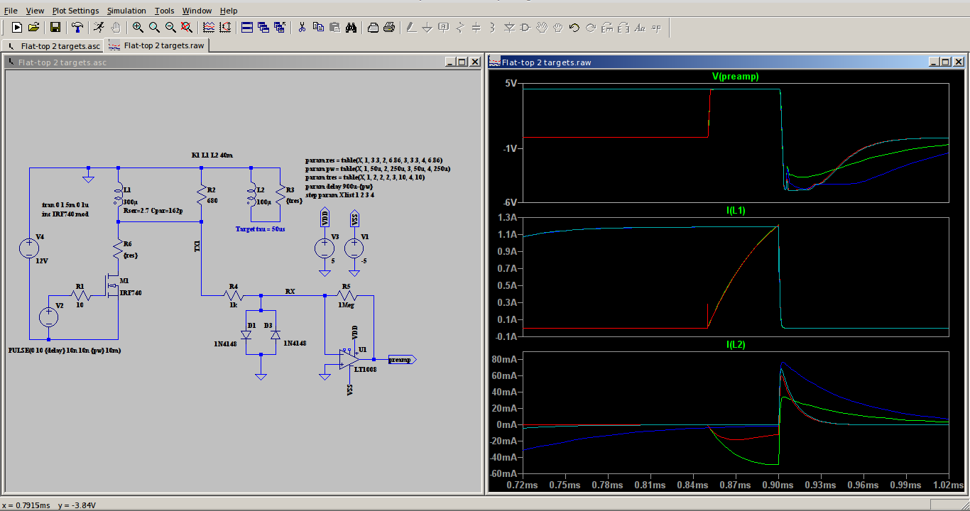

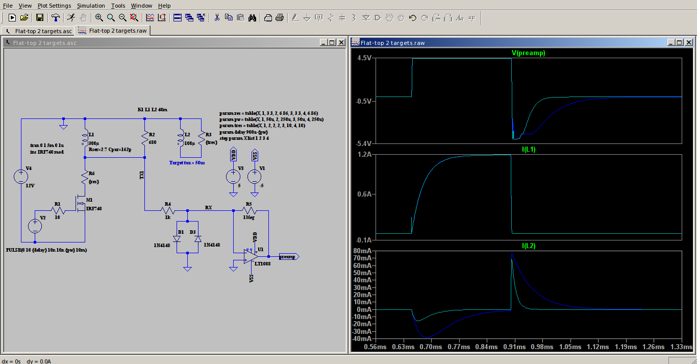

      To demonstrate what Carl is saying, please see the attached LTspice simulation results.
      The simulation does 4 runs:
      1. Series resistor 3R3, TX pulse width 50us, target tau 50us
      2. Series resistor 6R86, TX pulse width 250us, target tau 50us
      3. Series resistor 3R3, TX pulse width 50us, target tau 10us
      4 .Series resistor 6R86, TX pulse width 250us. target tau 10us
      Detection Depth Sim: shows all 4 simulation plots together.
      Detection Depth Sim - zoomed in: shows a closeup view of all 4 plots.
      Detection Depth Sim - flat top: shows the plots for the 50us and 10us TC targets with flat-topping. In this case you can see that the strongest signal comes from the target with a tau of 50us.
      Detection Depth Sim - no flat top: shows the plots for the 50us and 10us TC targets without flat-topping. In this case you can see that the strongest signal comes from the target with a tau of 10us.
          Thanks, I was going to add that somewhere there is a thread on this topic with lots of sims, but then my Internet went out.
          BTW, it's not enough to flat-top the current; it has to remain flat-topped at least 5x longer than the longest target tau you are dealing with. That could be a very long time, by PI standards.

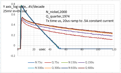

            https://www.geotech1.com/forums/atta...4&d=1588518934 chart from reply #7. Tx is 20us ramp to .5A with constant .5A for 4980us. Should be long enough? Maybe I'm doing something wrong?
                Oh, I see. Yes, 5ms should be long enough. Time to rethink.

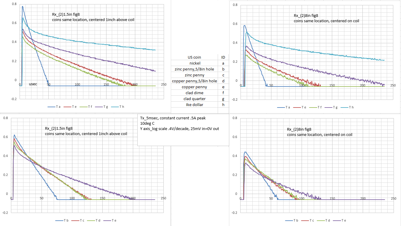

                    Charted a nickel and quarter again to see if I get similar results. Tx on time, 75us, 150us, 300us and 600us.
                    I'm guessing the nickel would have a larger signal if it was 1/2 the diameter of the quarter

                      I have wondered about area under the curve. If I double peak Tx current target Rx signal doubles. Tx energy increases 4 times, does signal double because Tx out Rx back. I recorded amplifier out, no target and target. Subtracted no target from target and averaged signal from 8us to 108us. Quarter(.239V) nickel(.133V). Maybe my method isn't the best, wonder what you get if you try to measure average.

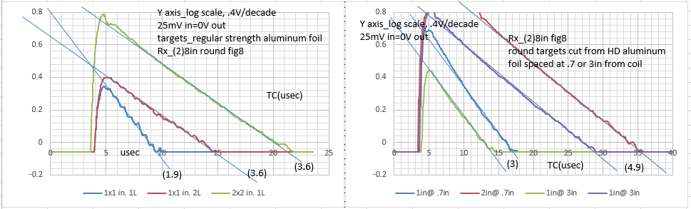

                            A test with 1inch square vs 2inch square aluminum foil targets. 1 layer targets have a different decay rate so the 2inch square target is 8 times(9 divisions on the chart) the 1inch square target at around 6us only. The 1inch 2layer target has about the same TC as the 2inch 1 layer square target so the difference is consistent(about 8 divisions)6.4 times not 8 times. Tried with a round target this morning. 1inch and 2inch diameter targets have a different TC so they would be 8times different at one time only the same as the square targets. What is the reason or math why signal amplitude is proportional to the cube of the diameter? Wondering if I'm doing something wrong.

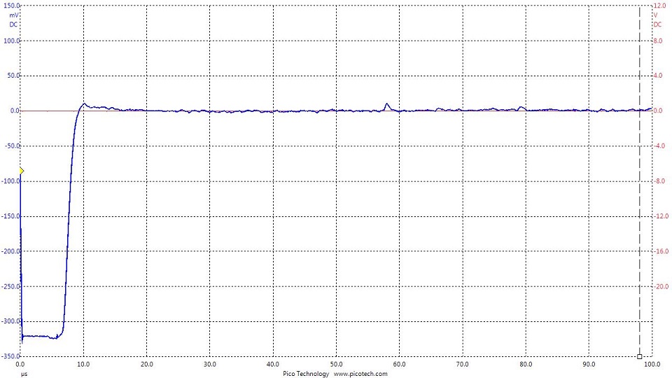

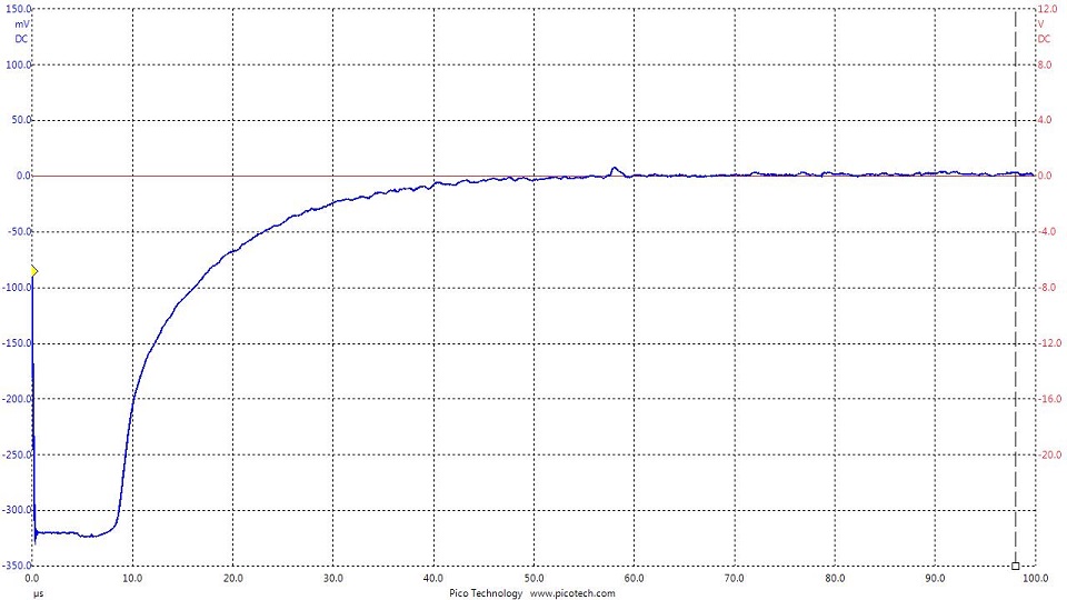

                              Here are some linear plots which show why the detection range is greater for a Nickel than for a Quarter, or even a Dime.
                              The test setup consists of a Tx with a HER208 series diode to minimise the capacitance seen by the search coil. Pulses are not constant current but are 350us duration and 2A peak. Search coil is 8 inches diameter with coins placed on a platform 1.5 inches from the base of the coil and on axis. Rx is a NE5534 and NE5532 giving a total gain of 500. Waveform is inverted with maximum signal at the -3.25V saturation level. X axis is 10uS - 100uS. Comparisons are taken on the 10uS line. Probe was set to x10. Hence the Y axis values should be multiplied by 10.
                              The first plot is the response with no coin. Click image for larger version
Name:	no signsl.jpg

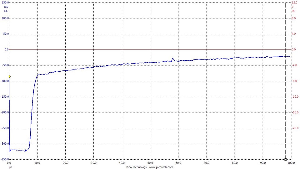

                              The next plot is for the GB cupro nickel Shilling. Click image for larger version
ID:	357309 This 1954 coin was set 1.5 inches from the coil centre so that the maximum signal just drove the amplifier near to saturation at the 10uS time and -3V. The TC of the decay is close to that measured by Skippy.

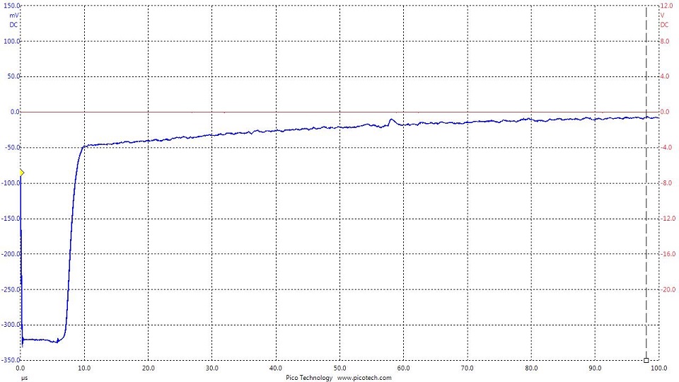

                              The third plot is the clad Quarter. Click image for larger version
ID:	357305 Here we see that the starting amplitude at 10uS is very much less than the Shilling, but continues for a longer time. On expanding the timebase, the waveform finally merges with the noise ripples on the 0V line at400uS, compared to the 65 - 70uS for the Shilling.

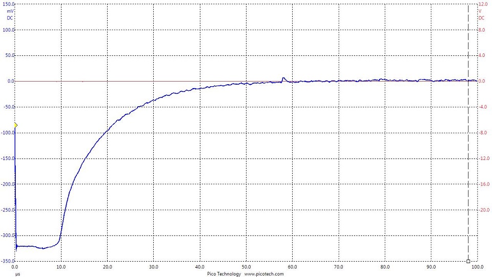

                              Fourthly, the Nickel. Click image for larger version
ID:	357306 This has the same metallic composition as the Shilling, but due to its smaller diameter, has less amplitude.
                              Last a Dime. Click image for larger version
ID:	357307 Again, a small coin similar to the Quarter in composition. It also displays a low starting amplitude but long TC.
                              Eric.
