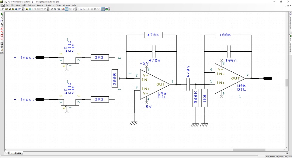

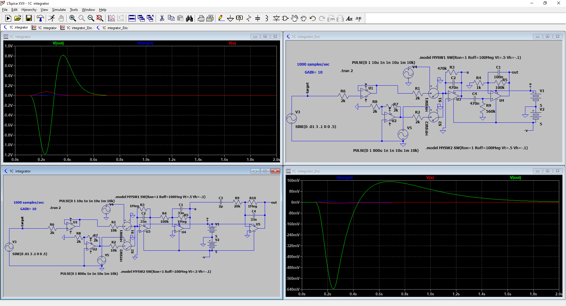

        • Starting to draw schematic for testing the large coils I'm making to see if I can detect a quarter at 24inches. Compared integrator I used for my last bench circuit and Eric's reply #55. What should integrator out waveform look like when target is swept across the coil? I look at point (a) with a voltmeter when plotting static targets and point (out) for sweeping targets.

          Probably for bench testing it doesn't matter. What should it look like for a detector?

          • Point 'a' should look like a Gaussian curve, as in the upper-left plot. 'out' is the first derivative of 'a', and again the upper-left plot show a classic response curve.
            Question: did you intend U2 to invert the preamp signal? R8 is grounded.
              U2 was the invert signal in another analysis (EF sample). Grounded it so I was just looking at a target signal.
