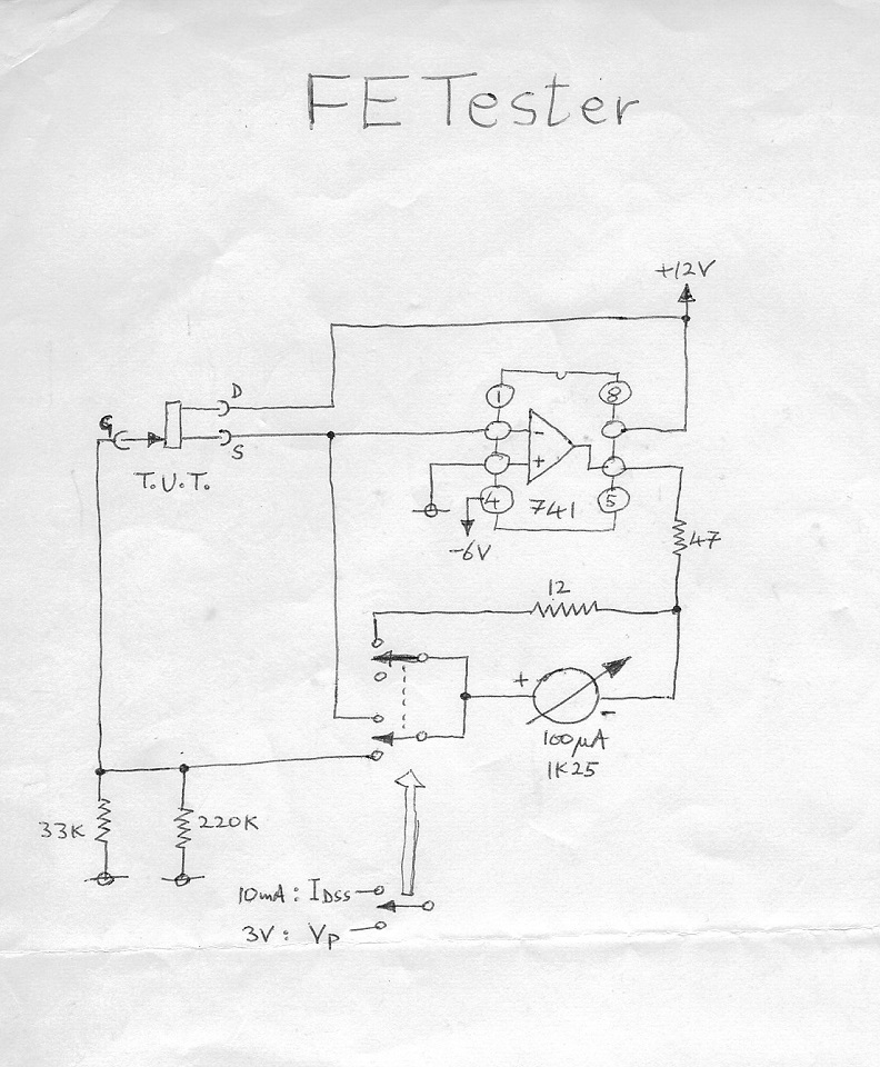

                  For the record, here is the schematic for the FET tester that I have used since the 1970's. vis the 741. Now, I would just use the 200ohm range on the multimeter with a fixture to plug in the jfet and which shorts the S to G. J112's also work fine and give a lower rDS(on). VGS(off) is a bit higher though, with a max value of -5V, but most read about -3V.

                  Eric.

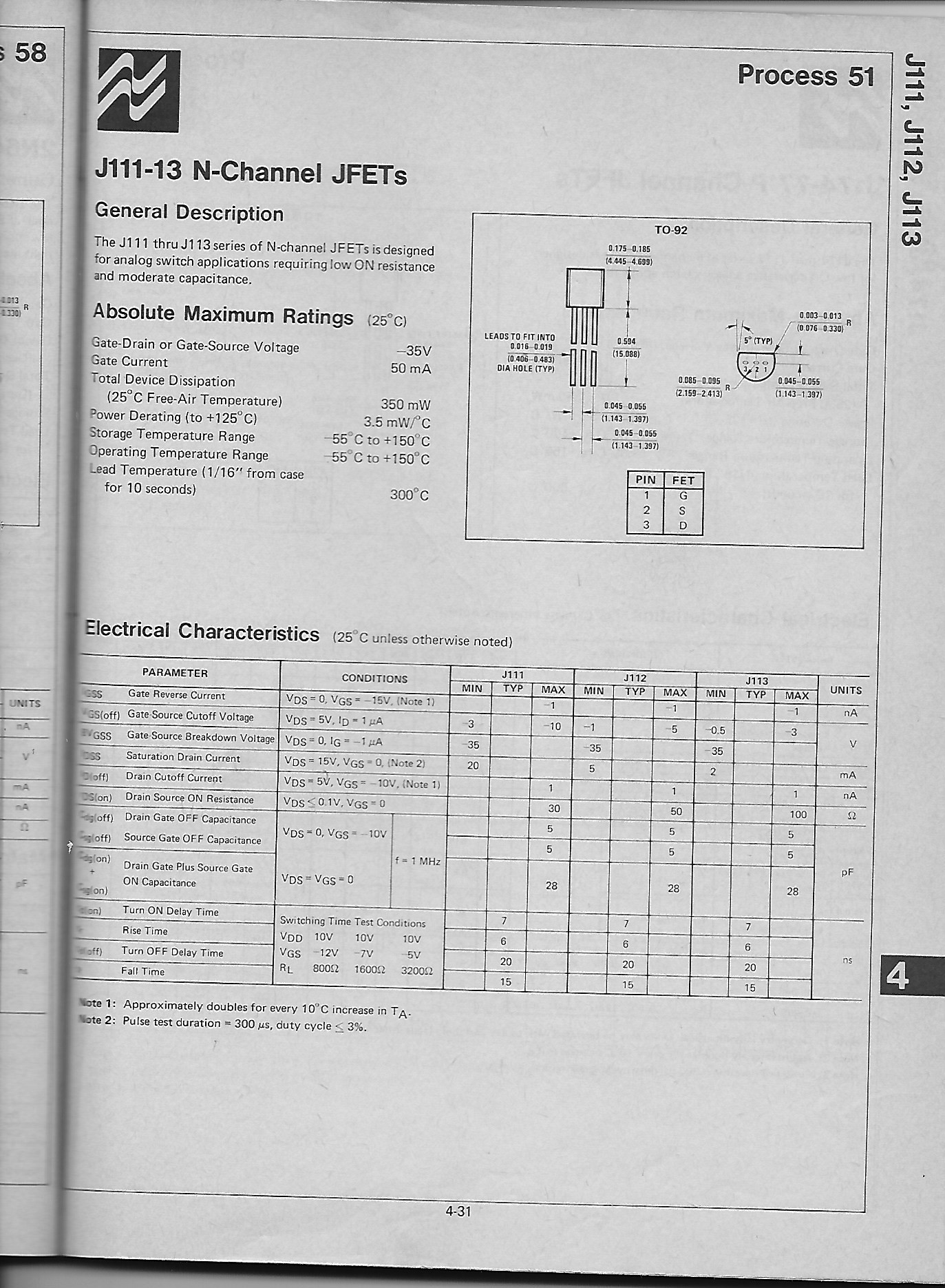

                          Yes, that is correct. J111 and J112 have higher turn off voltages and higher IDSS. On resistance is lower too. See data sheet. Click image for larger version

                            Yes, that is correct. J111 and J112 have higher turn off voltages and higher IDSS. On resistance is lower too. See data sheet. [ATTACH]50493[/ATTACH]
                            Eric.

                              What I actually meant was the higher the VGSoff is amongst my collection of J113 fets
                              is the higher the IDss of those fets
                                From my limited knowledge of semiconductor production techniques I would think that J111, J112 and J113 are all made as one batch and then sorted according to their electrical characteristics i.e.VGS(off), IDSS etc. The fact that they are all 'Process 51' supports this. Higher VGS(off) in a J113 results in a lower RGS(on) and hence a higher drain current; although this is a pulse measurement as per note 2 on the data sheet. This follows through to the J112 and J111. However, J110 is a different process and on a different page in the data book. Many of the characteristics are similar to the J113 but it does not work without modification to the source circuitry. It is 'Process 58' and encompasses J108, J109 and J110.
                                Yes, I have just noticed that toward the front of the data book, the various processes are listed, together with the die construction. The dies for Processes 51 and 58 are quite different
