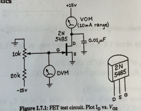

                          Hello Eric, just received a bunch of J113 fets, I have a transistor tester that tests jfets, what is the most important parameter to look for when trying to match them IDss ? thanks.
                          • #88
                            What I measure is VGS(off) which is the gate source cutoff voltage. This appears to have a direct relationship to the drain source on resistance, which is what we are really interested in. So if we have two devices which have the same VGS(off) then the on resistance should be a reasonable match. The National data book I have only gives a maximum value for rDS (on) of 100 ohms. No minimum or typical. Data gives VGS(off) as between -0.5V and -3V. I have just measured one of my J113's and got a reading of -2.6V.
                            Eric.
                            • #89
                              • #90
                                Eric.
                                Hello Eric, thanks for the reply, thats an interesting approach using VGS(off), most of the testers I have seen used IDSS for matching, I have a digital transistor tester and looking at the display it gives three readings, one is Zero current @ XX volts, one j113 tests at 2.7 volts so I guess that is VGS off, I dont have a handbook for it.
                                But IDSS is all over the place.
                                I will build this manual simple tester , I think it will give a better indication of VGS, we are getting down to zero temperatures over night now , hard to get into work shop
