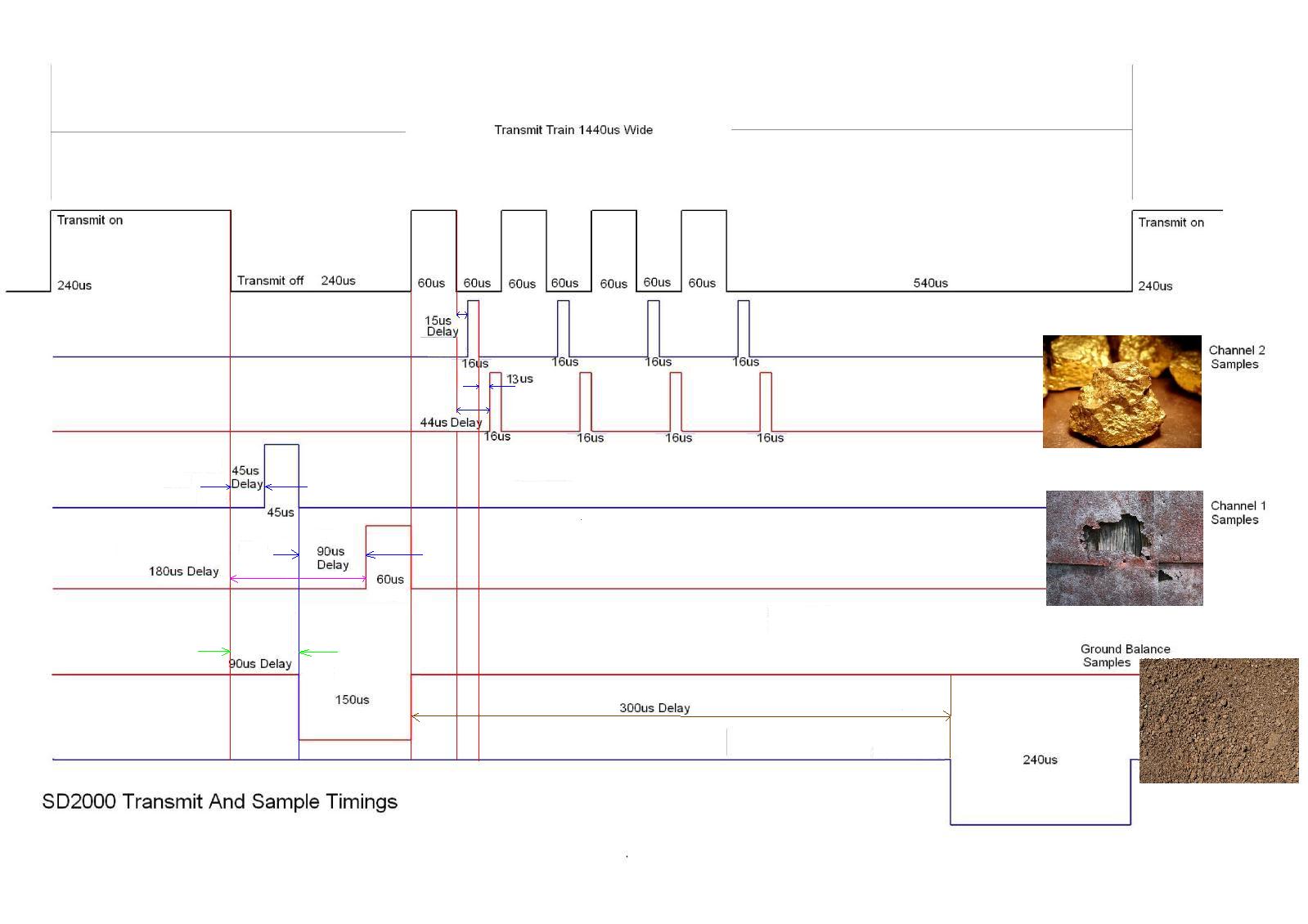

                Carl do you recall when they take target and efe samples ? is it after all the long and short tx pulses finish ? thanks
                Here is a timing diagram of the SD2000. sampling is done after each TX pulse. From my experiments a 240us pulse is good for all long TC targets whereas 60us is enough for short TX targets and also decreases fly-back Voltage as Carl points out and allows earlier sampling.

                In my HH2 I also have a 10 Ohm resistor is series with the coil & MOSFET to reduce the Tau of the coil during TX. This increases the rate of the current into the coil and gets to a constant current sooner (flat topping). This reduces the finial current in the coil and reduces the peak fly-back Voltage.

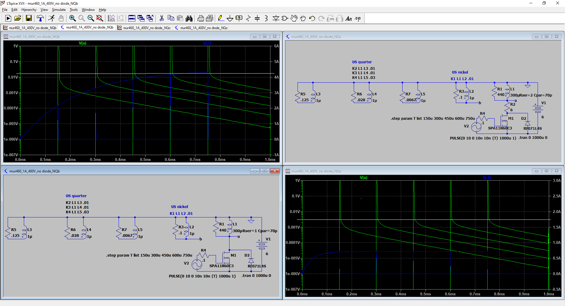

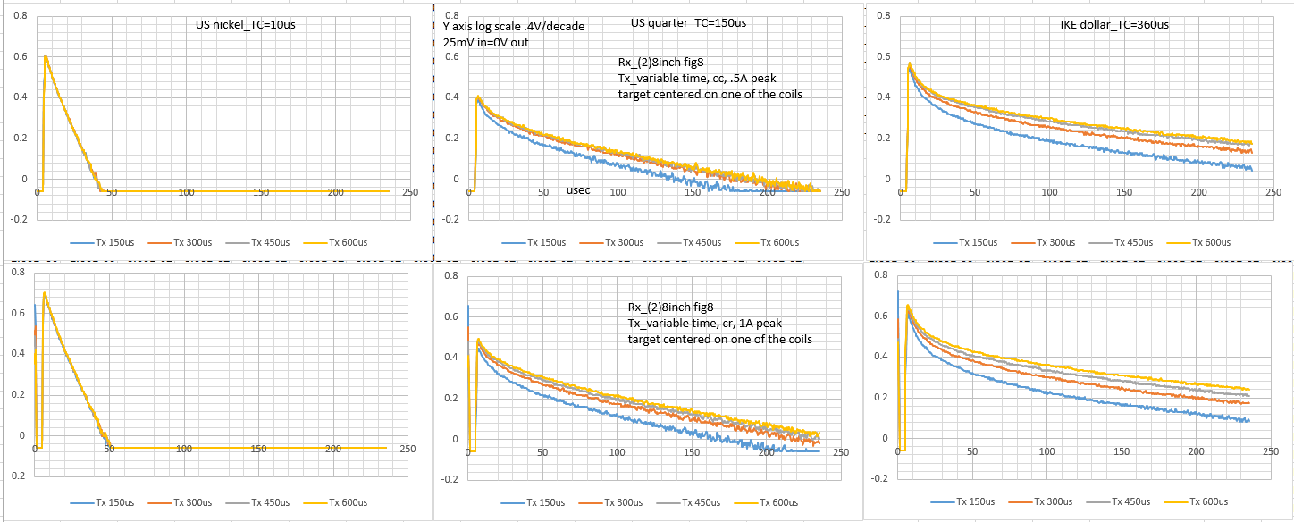

                                My bench circuit has two modes. Constant current, ramps to .5A in 20us then stays at .5A for rest of Tx on time. Constant rate, ramps to 1A in Tx on time. Both modes same average current for Tx on. Constant current, Tx on times 3 an4 target TC's not much different than 2TC. If I understand the theory correctly, at 1TC subtract 36.8% at 2TCsubtract 13.5% at 3TC subtract 4.9% at 4TC subtract 1.8%. 4TC on time twice the average current of 2TC on time for a 11.7% increase in signal. Don't know if could detect a difference in detection distance in a blind test switching between 2 target TC or 4 target TC constant current Tx on times. See a difference between 1, 2 or 3 target TC with constant rate, still the increase in signal is less than increase in average current. Including a test with a nickel, quarter and a IKE dollar varying Tx on time 1,2,3 and 4 quarter TC's. Think 2 target TC on time is enough. 300us for the quarter but 300us is less than 1TC for the IKE dollar. Looks like desired average current effects in Tx on time. One division is 26%increase in signal for the test charts.
                                Tried a spice simulation also. Series resistance 8ohms, some increase from 1 to 2 target TC. Series resistance 1ohm, some increase from 1 to 2 target TC and some from 2 to 3 target TC maybe due to increase in peak current.
