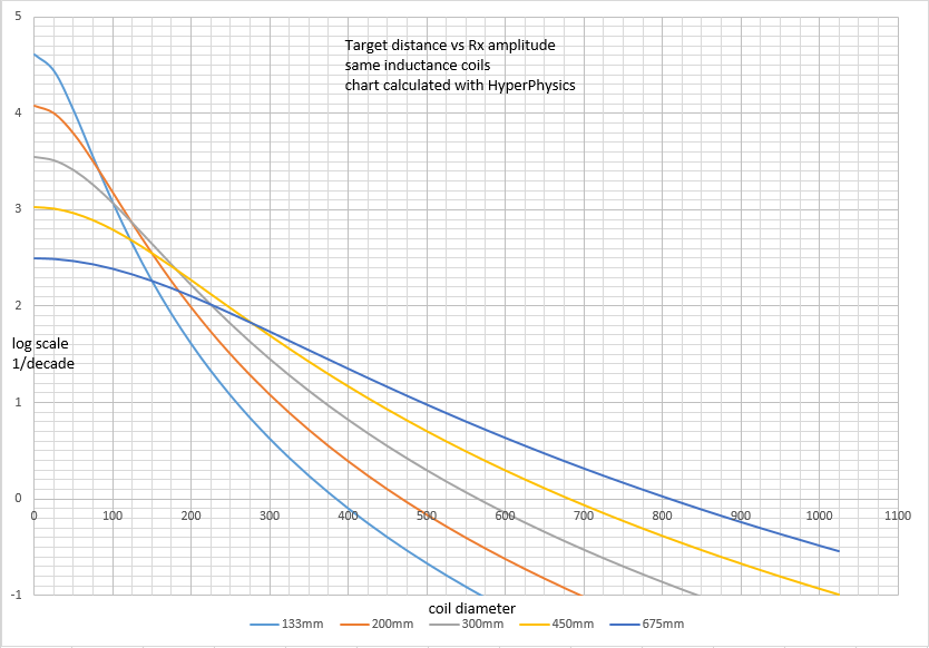

      Green,
      The charts you posted are about what I expected from theory and my experiments.
      A low TC target (nickle) didn't increase response with long TX times but a quarter did up to 2-3
      TC and same with the Ike dollar.
      As was posted above an increase of TX time from 2 to 3 target TC increases TX current (magnetic field) by less than 2%. So a TX pulse of 2 target TCs is a good trade off between target response and total detector current draw.

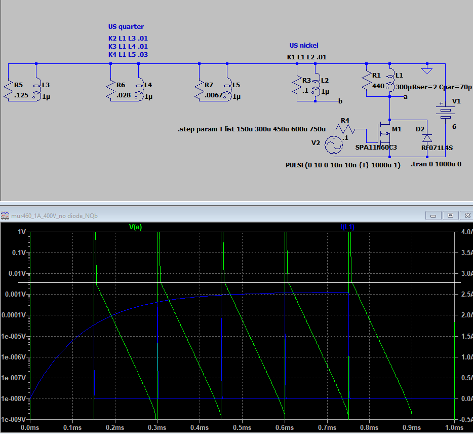

          Change in signal strength should be proportional to change in battery volts if nothing else changes. 6 to 12 volts doubles signal. 12 to 15 volts increases signal by 25%. One division on chart is 26%, three divisions is double. With a 8inch coil, 25% increase in signal increases detection about 3/4inch at 16inches. Doubling signal increases detection about 2inches at 16inches.
          We have coil on TC and target TC. Looks like Tx time on should be 2 times target TC. What is the procedure for selecting the best coil TC once Tx on time has been defined?

                  I continue to object (as I have in the past) to some of the descriptions of how things work. We are not trying to saturate the target during the TX-on time. That would imply that we are trying to build up a to maximum eddy current. When the coil is energized it will induce eddy currents in the target, but those eddy currents are in opposition to the eddy currents that are created by the turn-off (flyback) event. Residual on-time eddy currents will therefore subtract from the turn-off eddy currents and reduce overall detectability.
                  Instead, we want the on-time eddy currents to die out to zero. To do this, you would extend the TX-on time not only long enough for the TX current to flat-top, but also for the target eddies to decay to 0. If the coil tau is, say, 150us, and you are looking for small nuggets, then 450us (3 tau) might be enough. If you are looking for Atocha silver bars then maybe you need 10s or 100s of milliseconds because the target tau will extend eddy settling long past the coil tau.
                  I have long questioned how much of a difference this really makes, especially with targets that have a tau shorter than the coil tau. As you extend the TX on-time to minimize the subtractive effect, you also extend the off-time flyback due to the higher coil current and so the sample delay must be extended. It is a trade-off, and I'm not sure where the trade-off cross-over occurs. For high-tau targets it may make more sense because the off-time peak of the target's eddy response occurs at 1*tau (the target tau, not the coil tau) so if that tau is 1ms it makes no sense to try and push the sample delay to 15us where there is little signal anyway. You want to sample at/near the peak.

                        https://www.geotech1.com/forums/atta...0&d=1570406043 changed L1 Rser to 2R for 150us coil TC. Changed target to the nickel, closer to small nuggets. Ran a simulation. Don't see why 450us might be enough. Signal at 150us on time is lower than the other on times(less current at turn off)signal looks to be close to the same for the other on times. I have been thinking we were trying to make Tx on time 2 or more times the target TC not the coil TC. What am I missing?
