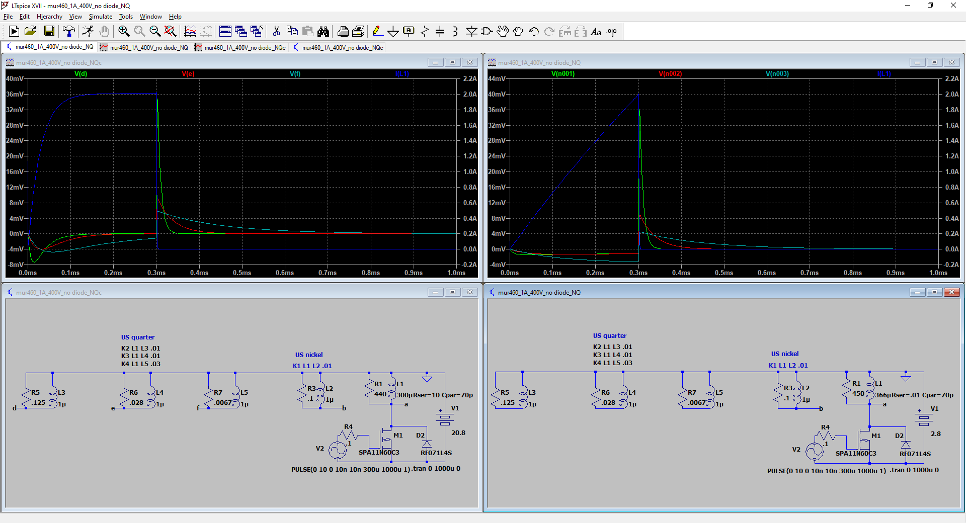

                  Interesting Spice simulation that does show Target response verse series resistance with coil.
                  The first sim, with coil R = 10mOhm, it takes a long time for the current to peak (flat top) and the target response is greatest with largest coil current.
                  The last sim, with coil R =10 Ohm, the current peaks (flat tops) much sooner so TX pulse time can be shorter to obtain the same response.
                  These sims were with a short TC target (US nickle) and as I have stated in above posts a short TX pulse works.
                  I would like to see these same sims done with a longer TC target, US Quarter.
                  Also, why are the coil inductance and damping R different in the three sims? They should all be the same then ONLY change the Series Resistance.
                  To throw in another factor: A larger series R gets the current to peak sooner. This allows shorter TX pulse times. This then allows high pulse rate (pps) which is known to improve over all detector sensitivity IF the integrator stage has the optional values of C & R. Read posts by Eric Foster about this.
                  Target signal and Rx signal are proportional to Tx current at Tx off if every thing else remains the same. https://www.geotech1.com/forums/atta...1&d=1570599081
                  Coil inductance and R damping are the same in each sim. Tx current was set the same at 300us(2 TC's for a quarter)by adjusting PS volts. Maybe shouldn't have stepped Tx on time. Included the zip so anyone could try what the wanted. https://www.geotech1.com/forums/atta...2&d=1570599224
                  Think minimum coil resistance gives the most signal if battery power is the same. .01 ohms coil resistance is difficult, wondering if coil TC 1/2 of Tx on wouldn't be a good choice.
                  Zero R gets the current to the same current sooner if the PS volts is the same.
                  Including a sim with the quarter.

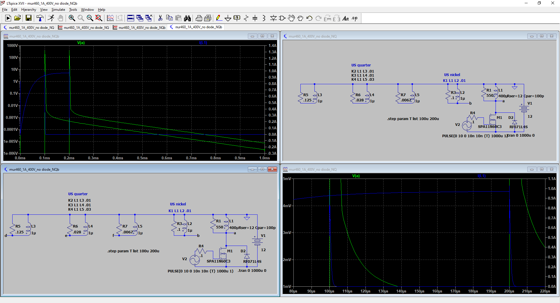

                    As I stated in a post earlier, going from a 100us TX pulse (12 Ohm total series R and 400uH coil = 33uS coil Tau) to 200us TX pulse increase the response distance of a US silver quarter by 20%.
                    The response distance for a US nickle did not increase since a nickle has a short TC (low conductivity) verse a longer TC for a quarter (high conductivity).
                    • #85
                      As I stated in a post earlier, going from a 100us TX pulse (12 Ohm total series R and 400uH coil = 33uS coil Tau) to 200us TX pulse increase the response distance of a US silver quarter by 20%. reply #84
                      Tried your example with spice simulation. Signal increased from 3mV to 4mV with 10us delay, 33% increase in signal. Using https://www.geotech1.com/forums/atta...4&d=1570460303 a 33% increase in signal(about 1.3 divisions on chart) predicts maybe a 5% increase in detection distance. Wondering why such a big difference(5% to 20%).
                      • #86
