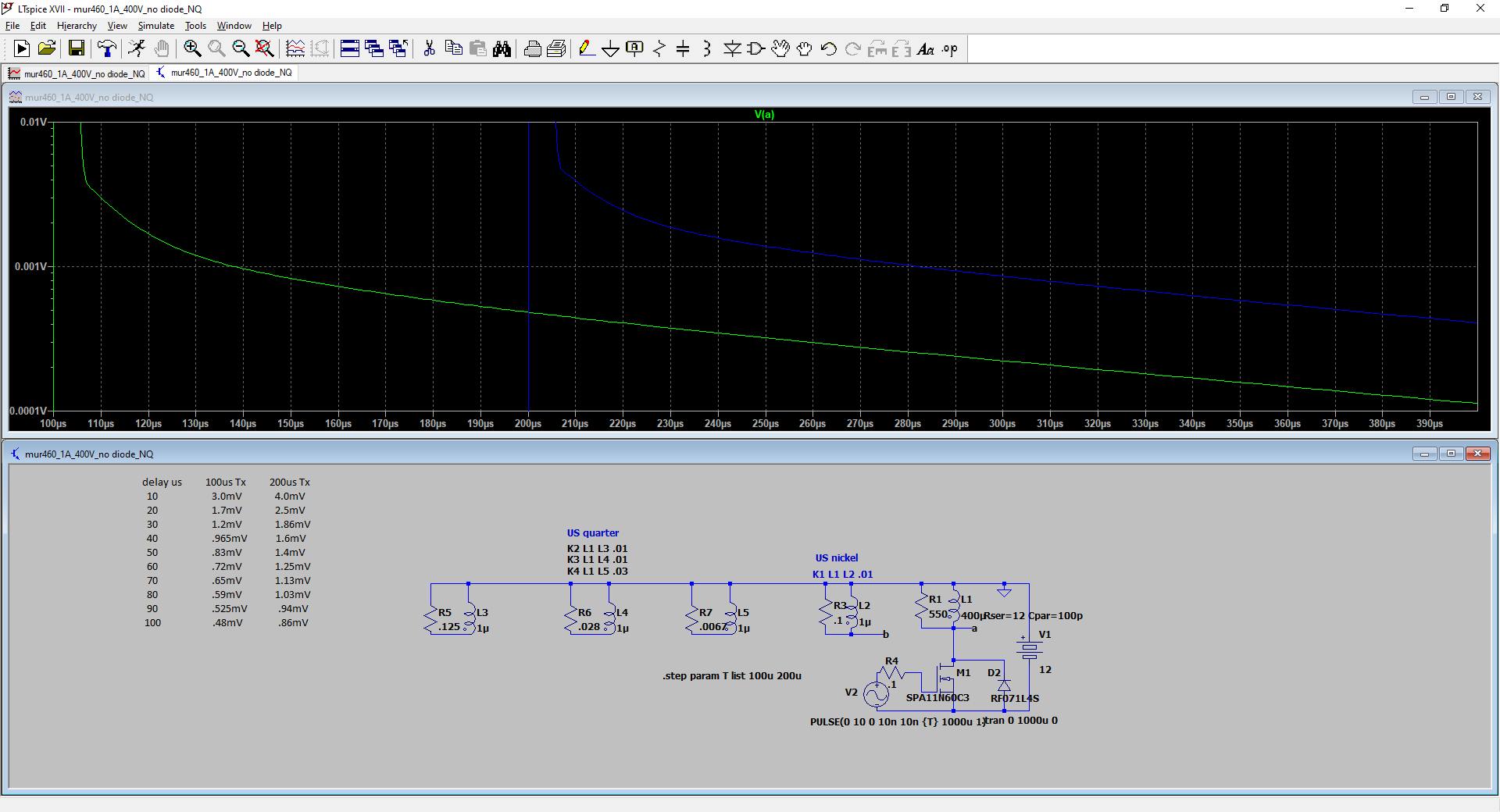

      I would say additional Gain in the pre and post amps, then 1500pps into 100nF/100k Ohm integrator. Plus the use of the Three sample method with a Long second sample (~110us) to detect/disc high conductors.
      Forgot about second sample. Greater gains at longer delay times for the 200us Tx. Still not double the signal, maybe missing something else. Does depend on quarter simulation being correct.
      • #93
        Note in your sim that at 100us after TX off the signal is double for a 200us pulse than for a 100us pulse. Remember that long TC targets do not have a high signal early in sampling compared to short TC targets. The signal increase is later. This is fairly easy to see is your spice sim and also doing the math for target TC's in excel.
        Yes, and the longer integration time into the 100nF cap as well as the pps (& sampling) rate.
        Much of the sensitivity in a PI detector is in the integrator stage.

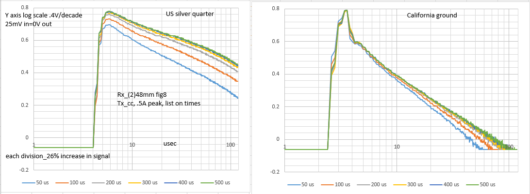

                      • Charted a silver quarter, constant current flat tops after 20us. Tx on time, 50, 100, 200, 300, 400 and 500us. Charted some California ground also.
                        Not much increase in signal after 300us with either target. Both targets have a greater increase in signal at 50us vs 10us after Tx off. Appears greater increase in signal with the quarter at longer of times gets canceled if detector is adjusted to cancel ground signal.

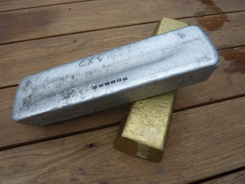

                          Many years ago I held one of these at a treasure show, I recall it was 70+ pounds. It belonged to Carl Fismer and was for sale. I wish I had the money back then to buy it.
                          Ahh---- the Atocha big pile; that brings back memories of the early 1980's. The ultimate in large conductive objects where you are dealing in milliseconds, not microseconds. Nowhere near saturation even with a 1.5mS Tx pulses. Unfortunately I only have two bars left now which make great doorstops.

                                I'd better come clean now, as I can't have members getting worked up. Even worse, I might get an extradition warrant to face charges. Those bars are just aluminium replicas of the same size and shape as the real ones. Understandably, Treasure Salvors were not keen to even loan one for tests, although I did have access to one of them in the US when working with TS. A few were found prior to locating the 'big pile', which was Mel Fisher's main priority when he found Spanish archive records showing nearly 1000 seventy pound bars were on board. The top bar in the picture has a hole bored from one end, several inches into the bar so that I could prove by inserting a ferrite cored coil, that an external pulse field would take some relatively considerable time to penetrate. Even with the less conductive aluminium it was a few milliseconds. Decay was also as long. Mint marks on the bar were done yesterday with marker pen. The bottom bar was sprayed with gold paint a few years ago. They make a good talking point with visitors; useful as door stops, and the top one for ironing the carpet when it gets rippled - hence the shine.
                                Eric.
