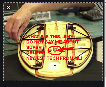

                  all doing ML is the preamp in coil. that gives the grow of depth on 1-2 inch. just that. all another are just mind control manipulation tricks, bare naked adwertizings, misleading
                  of people.
                  i say again x-Terra 'true digital V-FLEX tech' is in reality ANALOG signal transmit from a coil and NOTHING OF DIGITAL.
                  these tricks in their opinion would be blocked all attempts to copy ML coils, but NEL HAD COPIED THE CODE AND DOING TWO-FREQUENCIES COILS
                  setted TWO MICROS at coil pcb. ML must cry!
                    ML NEVER SAY YOU JIM ABOUT THE (THE) PREAMP in THE (THE) COIL -! he does just fantazy to invent new slogan on every his new detector and that is just for misleading of YOU -! we recall that as the capitalistic way of lies and deceit.

                      I worked on a square wave PI system at White's, the concept has some performance advantages. It's certainly not just putting the preamp in the coil.
                      The X-Terra has normal analog TX & RX waveforms, I don't recall that Minelab ever said differently. The digital "VFLEX" part strictly pertains to a digital ID chip in the coil that tells the detector what frequency to run.
