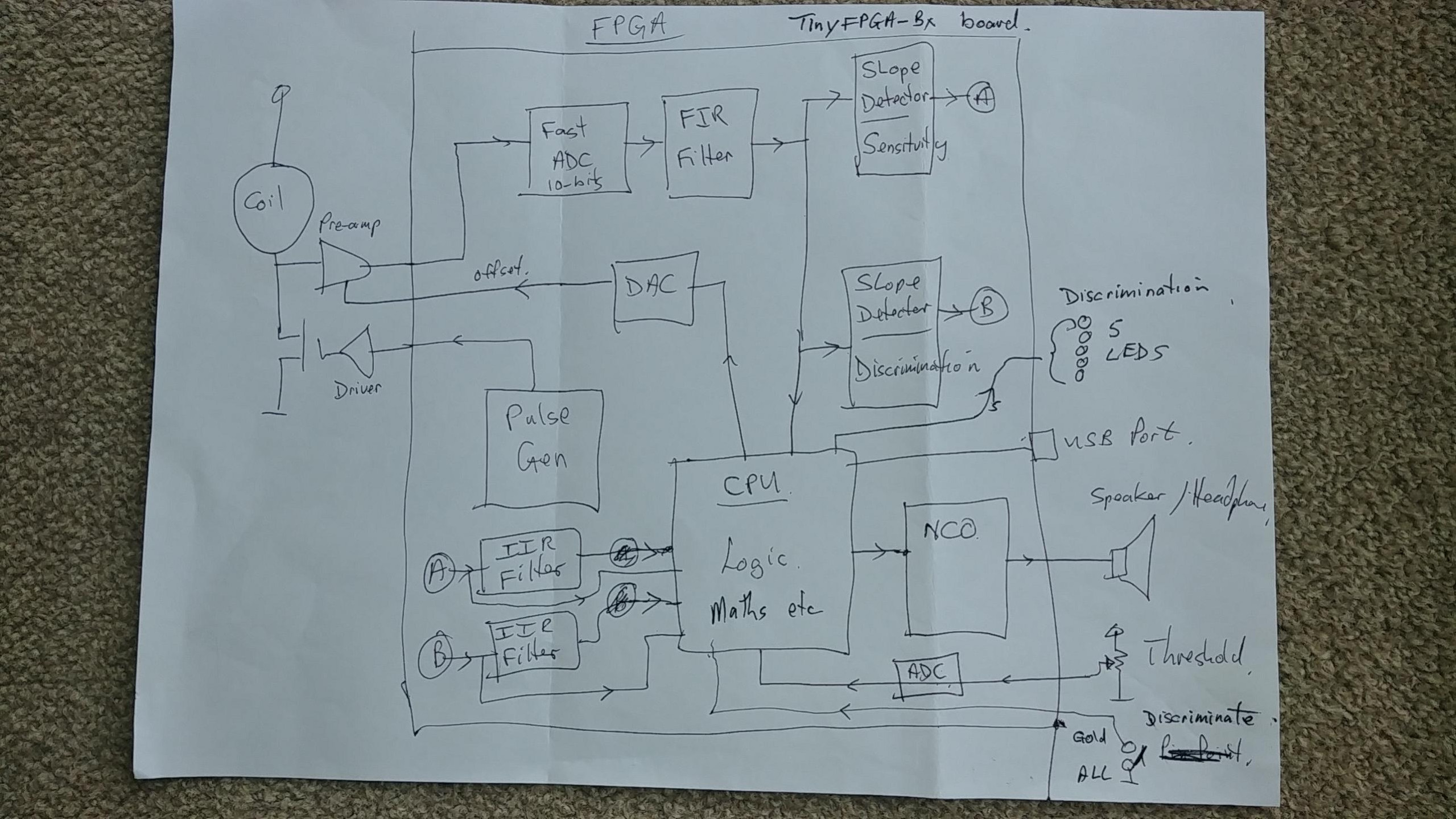

    I have attached a rough block diagram, I would really appreciate it if someone else, could put this in a better (electronic)form

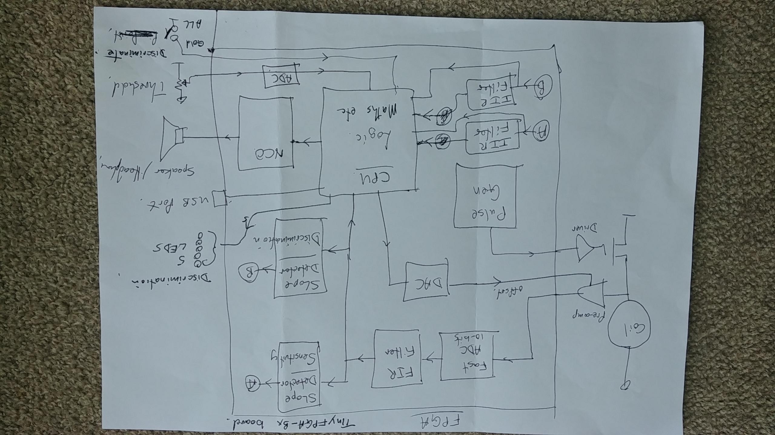

ID:	371316 <= Why is it that every time I post an image from my camera, it is upside down, though looks ok on my computer ...

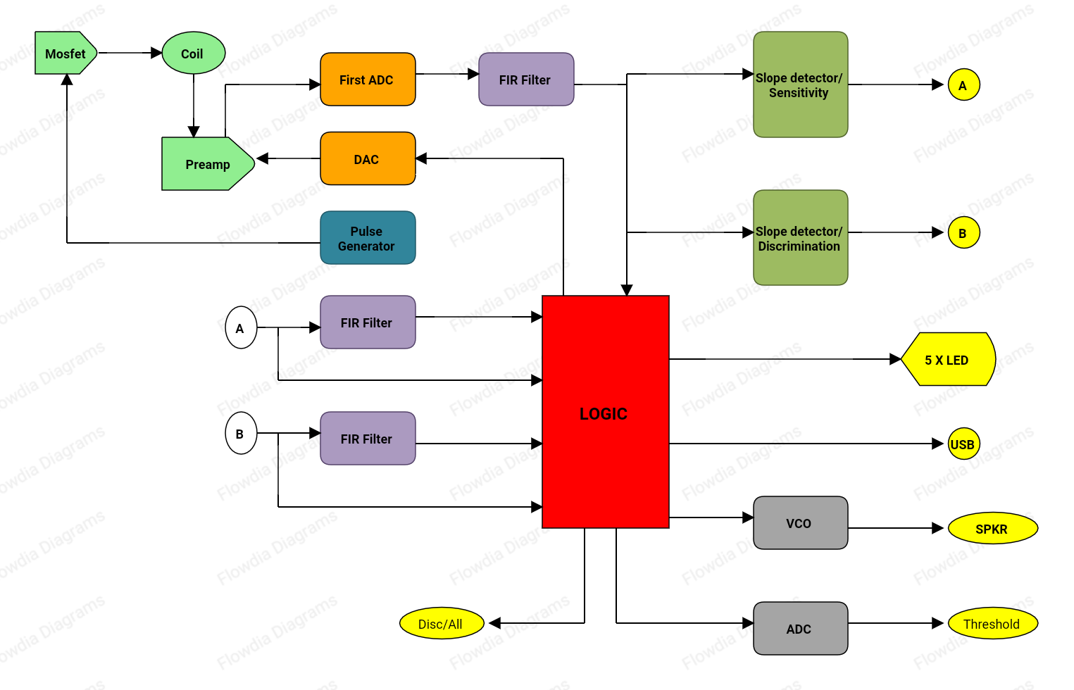

    Also, here's your block diagram the correct way round.

                I've just examined the 'upside down' block diagram. And the raw jpeg image IS upside down, and presumably meta-data states 180o rotation.
                This may help you get pics to upload correctly in future.
                  I can re-draw the block diagram, no problem.

                          Aha! got it!
                              I will try with 16-bit ADC, thanks for rotating the block diagram
