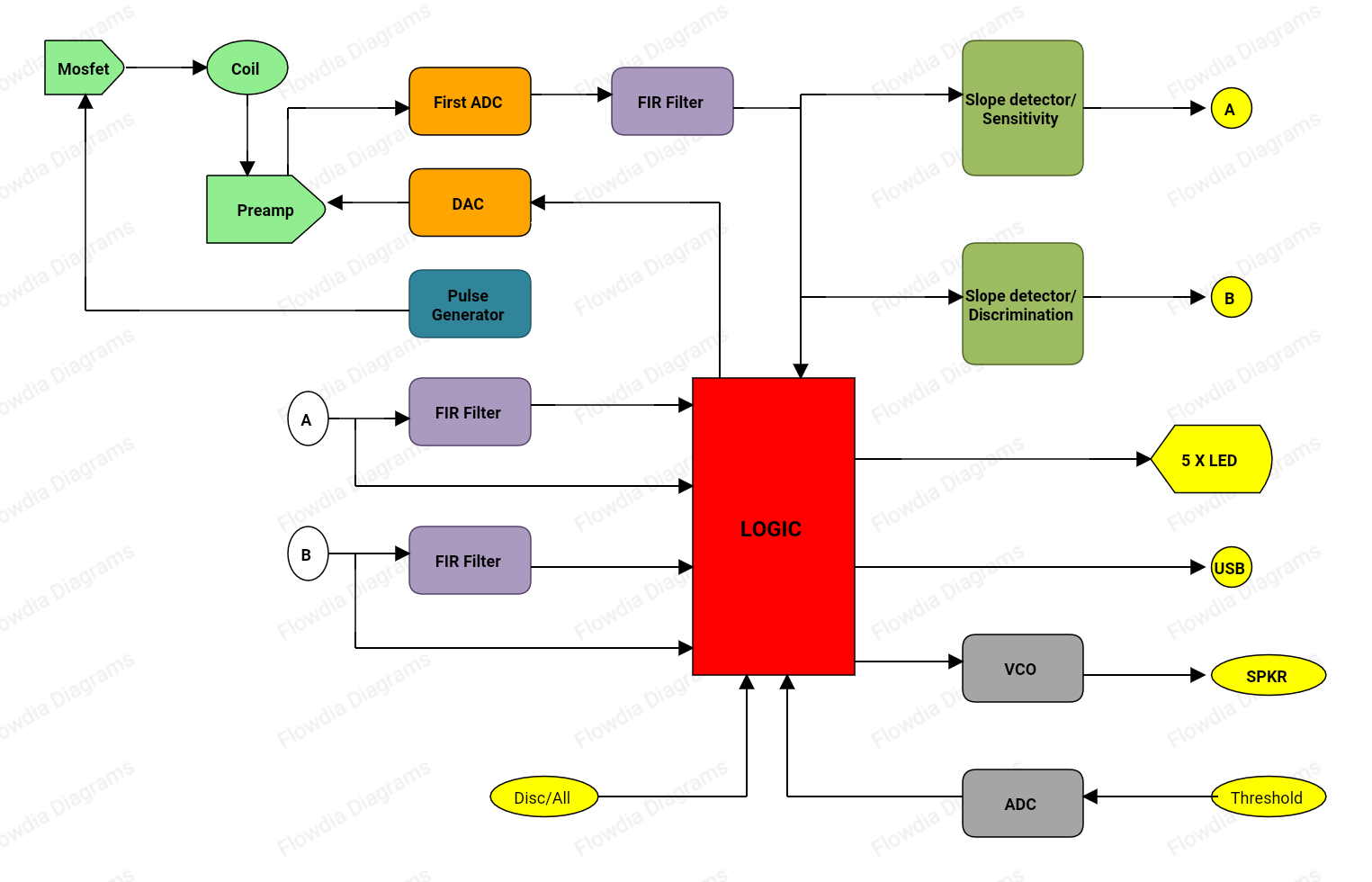

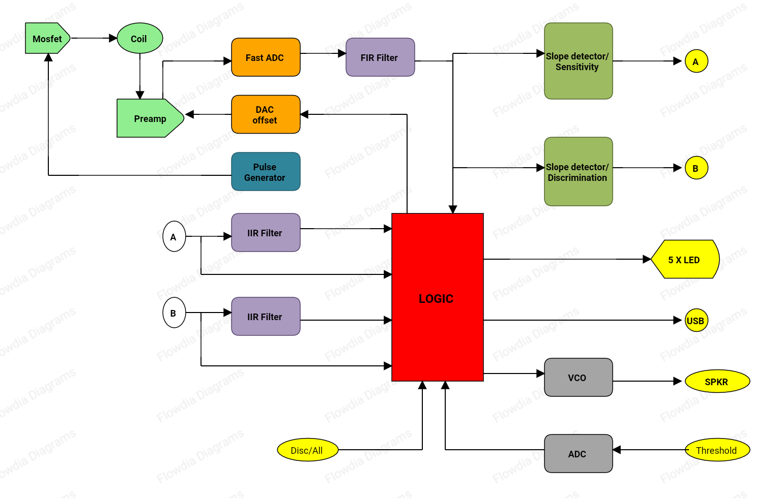

        Some arrows were pointing in the wrong direction.
          DB : two of the filters are IIR ( Infinite Impulse Response) not FIR.
          Could the (1)'s and (2)'s simply be joined with lines ?
            Yes, I used the upside down photo to redraw the diagram. On a small android phone it is a little hard to see.
            I will make the corrections. Also I put first ADC instead of fast ADC.
            I think all is well now.
              What do you mean, please explain.

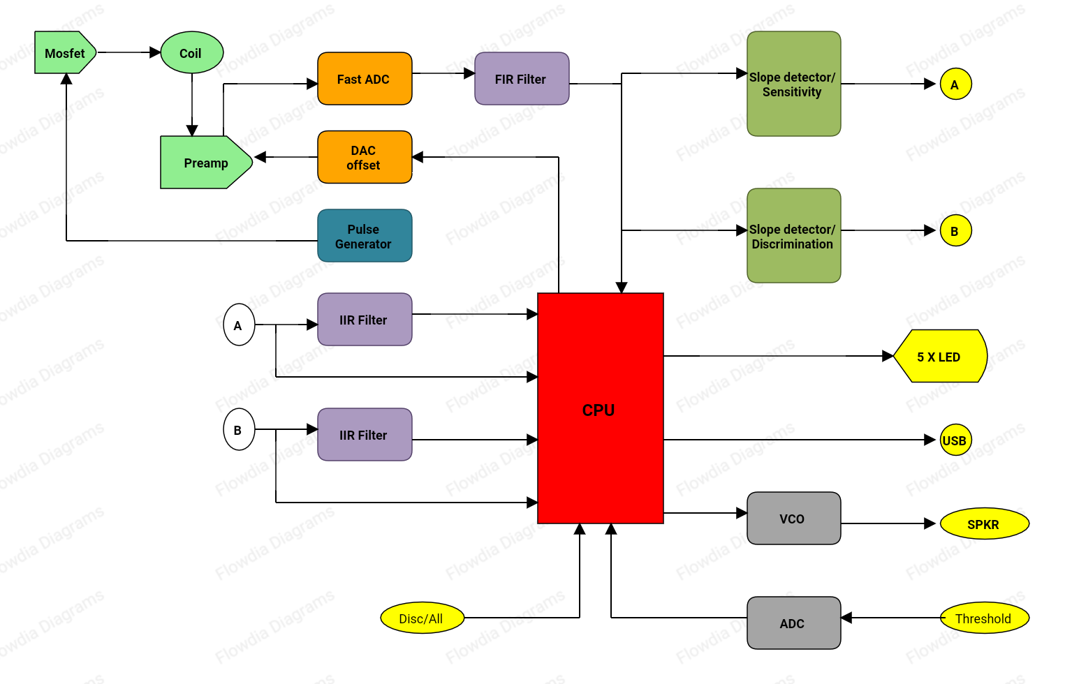

                Thanks for doing that, looks good, the only think I would change is to mark the Red block as CPU rather than "Logic", as it is a micro, not just FPGA logic blocks ..
                Thanks again.

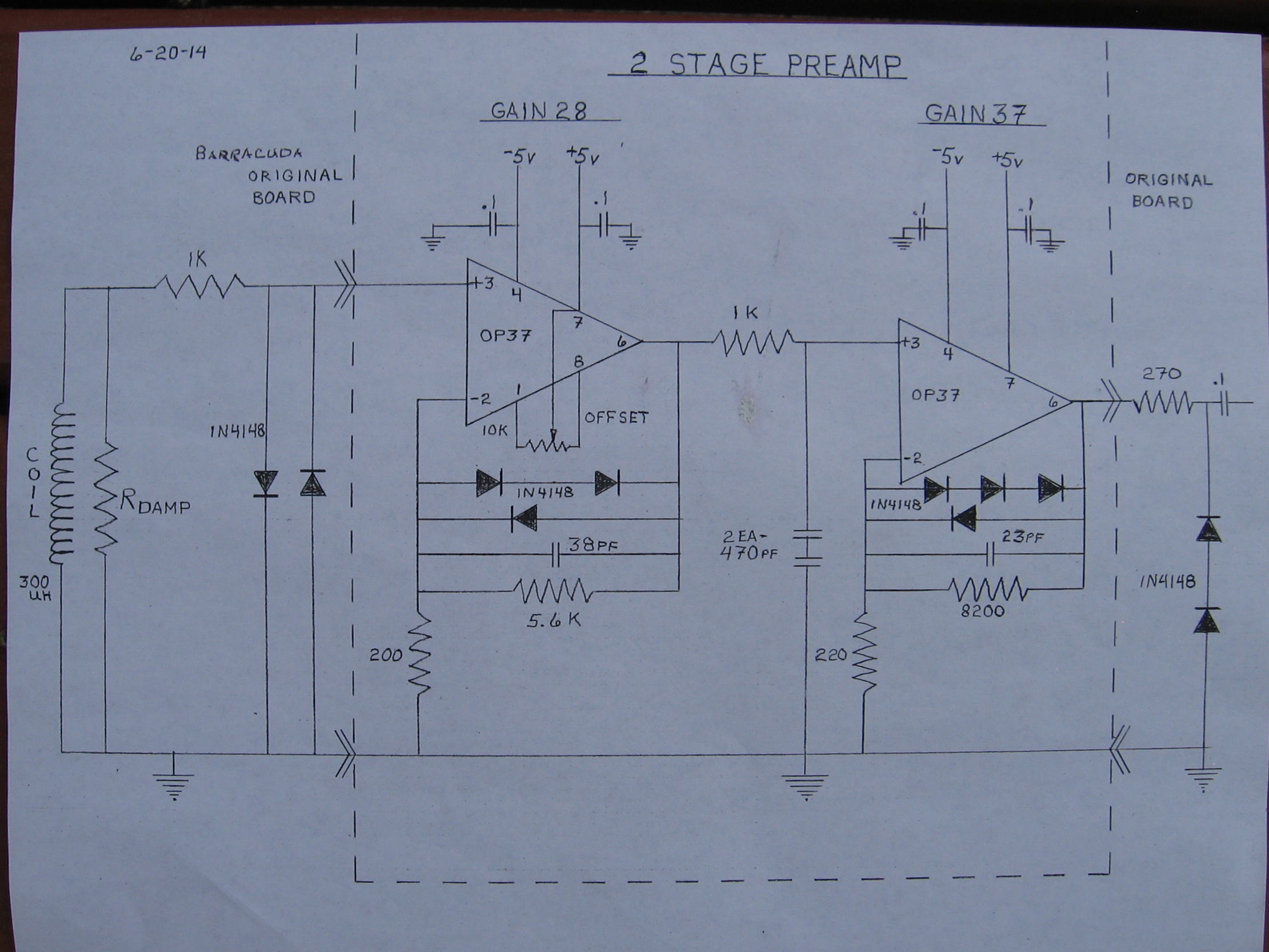

                  Since I am happy with the discrimination side, I need help with the op-amp design. I like the MPP op-amp with it's double stage, but it has issues with saturation and speed ... I will replace the op-amp with a faster one in the meantime (>50v/us slew rate), but it does need a re-design in order to pass a slope that may only be 5us, with a fast coil. I have built a spider weave coil that has a slope of only 2us, but the current op-amp (NE5532) cannot handle it
                  Any suggestions/designs for the op-amp welcome ..
                    CPU
                      A better pre-amp design might be something like this one Click image for larger version
ID:	356935.. from the MPP thread.
                      .. or maybe just take the diode idea and apply it the the original MPP op-amp circuit, and change out the NE5532 for a faster one ..
                      ..the diodes would help solve the saturation issues ..
                        Other op-amps may help and two stage to split the gain does help.
                        Check the MAX412/410 & LTC6230.
                        The first op-amp will set the Noise figure so that one could be the low noise op-amp with moderate gain then a fast recovering op-amp with more gain.
                          Just made a discovery. The op-amp was not overshooting, I just needed more damping on my coil, it is now critically damped.
                          Result is my gold ring sensitivity has increased to 200mm ... which is a great start ..
                          However, I see the output signal from the MPP with respect to -5v (my FPGA GND) only varies from 2v..5v, so I am going to have to level shift that to the 0..3v3 that my ADC expects ..
                          Will work on that ..
                              Thanks. The MAX412 would not be fast enough regarding slew rate, I think we need fast slew rate amps in both locations, the LTC6230 would be good ..
