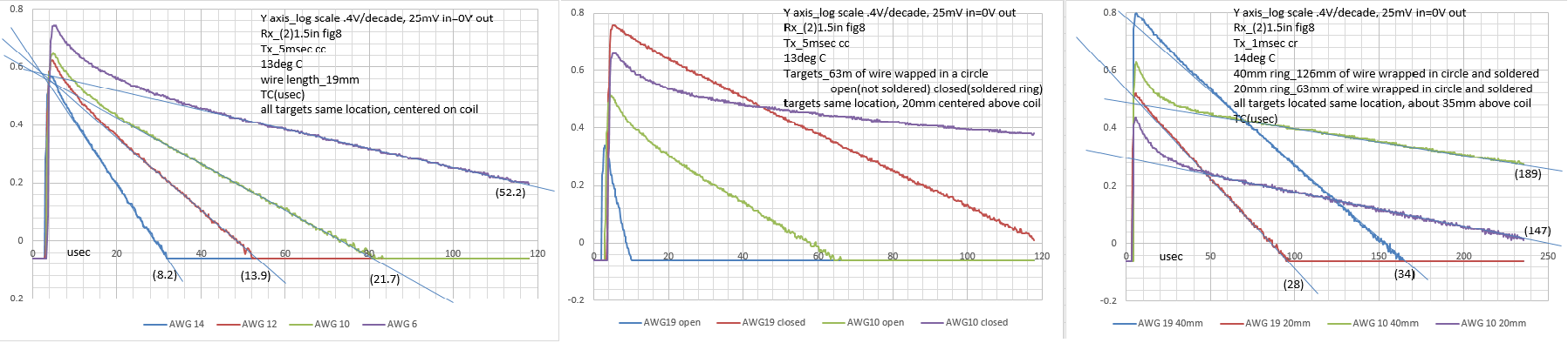

                      I did investigate this idea in the past (but not with an FPGA) and concluded that attempting to discriminate different targets by measuring the slope was equivalent to discrimination by conductivity. I'm interested in finding out what happens when you get the design off the bench and into the real world.
                      Lack of sensitivity is most likely due to only using 10-bit ADC sampling directly at the preamp output.
                      Good luck. Watching with interest.
                      Also, here's your block diagram the correct way round.
                      Trying to understand conductivity. A chart of some targets made with copper wire. If conductivity of copper is a constant why does the decay slope change. Does a target have conductivity or does the material have conductivity?
