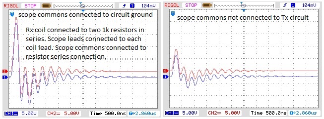

                    Probably the biggest problem I have is getting the IB Rx coil signal low enough at Tx turnoff. I used AD620's a lot for strain gage bridge amplification. Not enough BW for PI, but I see some that would be if input signal at turnoff is low enough.
                    Scope pictures of Rx coil at Tx turn off. Have been looking at amplifier out, maybe looking at Rx with amplifier not connected will help.

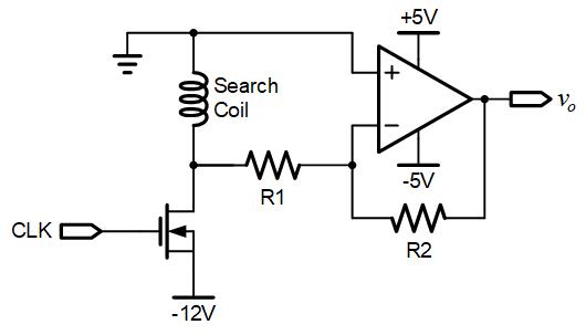

                            Have you read other threads in the forum? All of this has been discussed in detail. The Hammerhead II project shows the use of a PIC to replace the 555 & timing chips, and almost any PIC can do this. As for differential, look at the project forum called Differential Front-End PI. Also, here is a "standard" PI front-end, damping R and clamp diodes omitted for clarity. As you can see, it is actually differential, except for R1. As the coil voltage settles all you are left with is the thermal noise of R1. If the ground is noisy, it should common-mode out, assuming a decent CMRR.
                              Why is the "standard" PI front end differential input?
