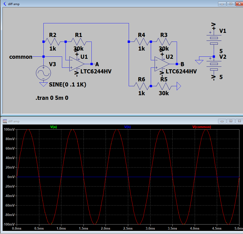

    It's differential in the sense that most opamps are used as differential amplifiers. Yes, I know this is commonly called a single-ended configuration but the opamp amplifies the difference between ground and the other side of the coil, which decays to ground. It is obvious that at full decay any noise on ground is common-moded and does not show up at the output, assuming good CMRR. But this is also true during the entire decay. So whatever problem liudengyuan is having, it's probably not what he thinks unless it is due to a bad layout. And without some circuit drawings from him I doubt he'll get much more help in figuring it out.

                  Thanks for the replies. Trying to understand any noise on ground. Made a spice simulation. Ground is half way between the supplies. Common is noise reference to ground. Single ended tracks common, diff amp cancels common reference to ground. Don't know which is better. Maybe not what your suggesting.
                    Ugh, my mistake, you are correct. I forgot there is a gain-of-1 pass-through on the common-mode signal. Thanks for the catch.
                      So what is true differential amplification? Do I need to isolate the power supply?
