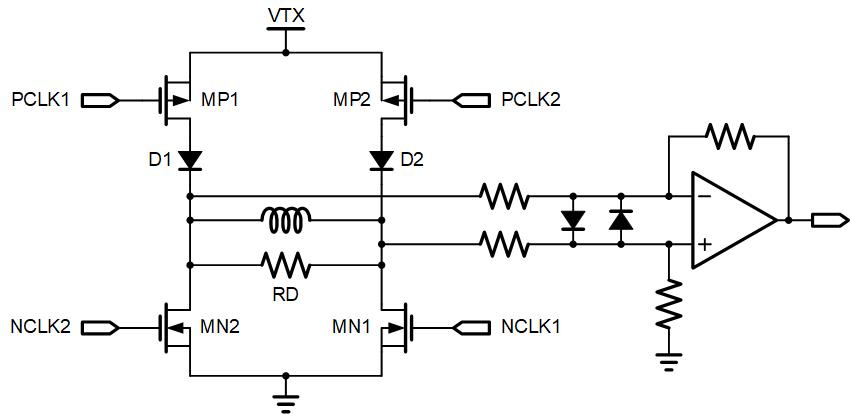

      My currently preferred method of driving an H-Bridge is with analog switches. While you can use 4053-types the DG469 is my favorite, 6 ohms max and up to 44V on the rails. Yes, I have run the TX supply that high. And the logic input is 3V-compatible. No level shifting or translation required.
      There is a simple way of getting rid of the SPDTs on the NMOS devices, bonus points if anyone figures it out.
      Hi Carl, I dont like asking for things, but I was wondering if there is any more to your h bridge circuit as I am interested to see how you are hooking up the pre amp and its configuration ? thanks.
      • Asking is still the best way I know of for getting answers...
        An obvious solution is to use a separate RX coil. It does not have to be induction balanced and offers the flexibility of optimizing the TX and RX inductances separately.
        If you want to use a mono coil then options are limited. The circuit below works pretty well though I have never tried to push it into the realm of aggressive performance.
        • Thanks Carl for the pre amp cct, much appreciated, I have got a basic very simple full bridge working with a single coil without letting out too much smoke , now I can add a preamp and see whats happening , cheers.
            Tried the unipolar and bipolar circuit again. Bringing my hand next to coil caused a problem with the bipolar circuit. Thought coil volts not decaying to power supply volts might be causing problem. Tried next day and a few times after, no problem with bipolar circuit. Don't know why. Next is adding regulator to Tx power supply so can adjust for 1A peak at 160us Tx on time. Starting to like the bipolar circuit.
            Maybe found the problem placing hand near coil. Sometimes I look at (A)integrator out, sometimes (B)differentiator out. Noticed when voltmeter was connected to (A) there was a problem bringing hand to coil. Connected a 10k resistor to (A) and 100nf capacitor to analog common to isolate meter from integrator. Problem solved. Maybe meter lead lead was picking up some Tx signal effecting the integrator?
            Added regulator to Tx supply, looks good.

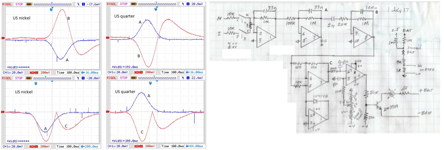

            picture, one I posted awhile back
              Tried bipolar awhile back. Ended with more diodes. Wondered if is necessary. D1 and D2 are MUR460, D3, D4, D5 and D6 are 5EWH06FN.
              First column, with D1, D2, D3, D4, D5 andD6. Resonance with Rd disconnected, about 1MHz.
              Second column, D3 and D4 removed and D5 and D6 shorted. Resonance with Rd disconnected, about 600kHz. Needed a lower Rd.
              Coil(133mm fig8 ).
              With extra diodes, resonance higher and could use a shorter delay. Not sure it's better yet. Need to do some more testing.
              Top four pictures are with either M1 or M2 turning off.
              Tried again today. Rd with all diodes(1200), Rd with 2 diodes Carl's circuit(650). 133mm figure8 Rx, separate Tx, looking at amplifier out. Carl's circuit looked better today.

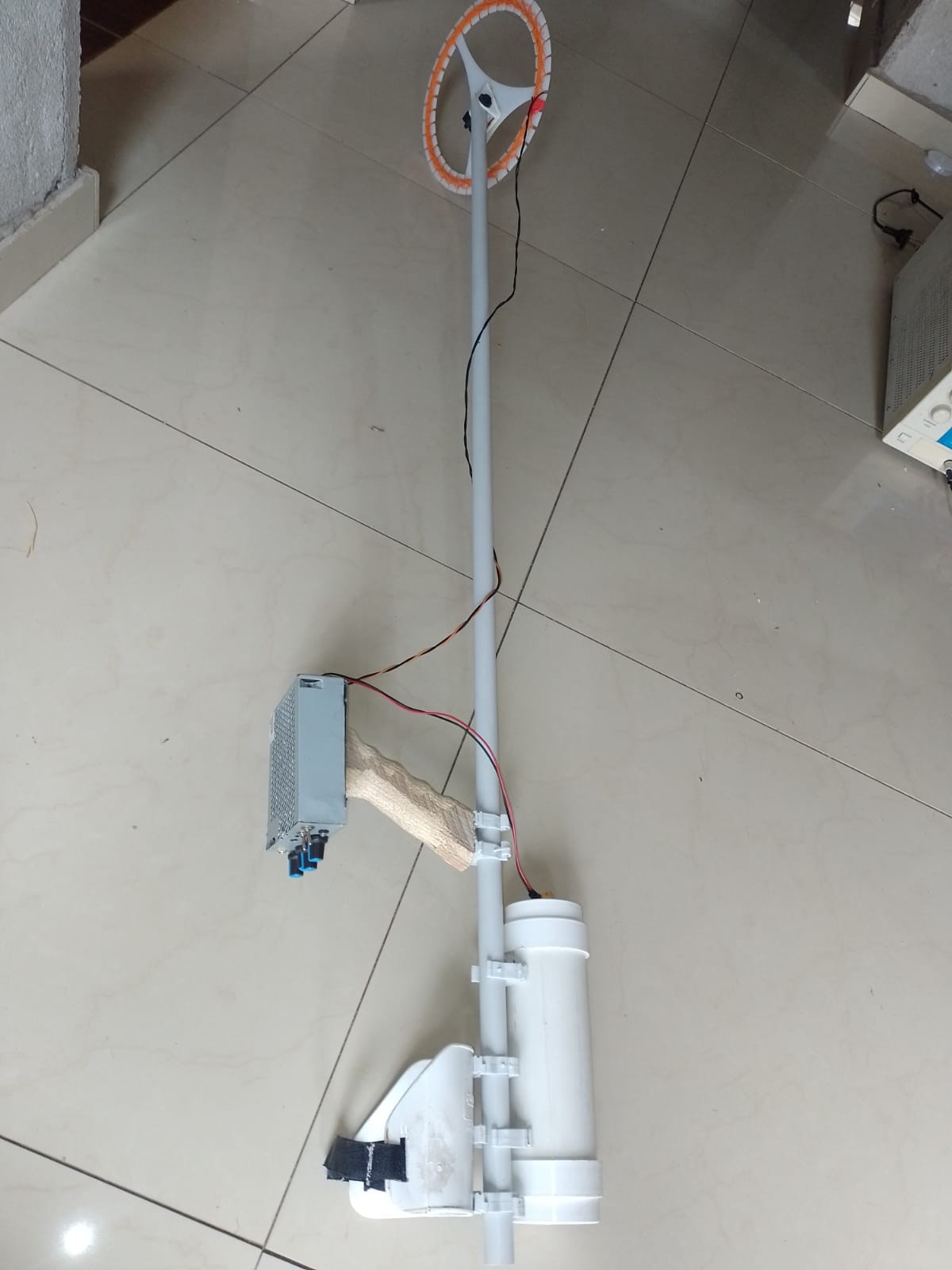

                  I know this thread has been inactive for several years. however the amount of information here is impressive to say the least. I have finished my first HH2 detector which I want to optimize for the detection of small gold nuggets under large stones in rivers. I am analyzing your bipolar circuit although I don't know how to adapt it to the circuit I already have... Is a pulse sent in one direction and then turned off and sent in the opposite direction with pulses of the same duration? What is the improvement over a unipolar pulse?
                  thank you for answering me and I will be very grateful for the answers. Dario

                  • Yes, it pulses in both directions. The advantage is that you do not need to use an EFE sample to cancel Earth field effect, it automatically cancels. Since there is no EFE sample, you can run at a much higher pulse rate.
