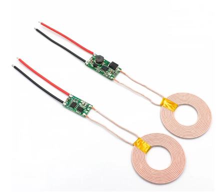

                        maybe you know how to turn on Tx without Rx module ?
                        • Hi pito,
                          What you mean with "turn on" ? If you want to send max energy without Rx module, you have in mind that uP controls Tx power by changing the Tx frequency and PVM of the Tx signal automatically AFTER hand shaking with Rx module. This is done by software in control uP. If you will to use Tx coil only for sending of energy, you have to made your own electronics with generator of 100-125KHz with 50% PVM and power bridge with 4 pcs power transistors ( two N-ch and two P-ch) and suitable drivers. In this case, you will use only Tx coil and serial connected capacitors (they formed LC tank for 100-125KHz) from ready wireless module. Finally, set the Tx frequency at resonance frequency of the LC tank. Also you have to use some desoldered parts from ready module.
                          • What you mean with "turn on" ? = When you apply power to Tx module it is trying to communicate with Rx module sending short pulses 100kHz , when communication is established it is sending continuously 100kHz.
                            Can this be done without Rx module ?

                              • No. In handshaking they exchange more data - the type of Rx, max power for Rx .... It is not way to simple "enable on" sending of power from Tx module.
