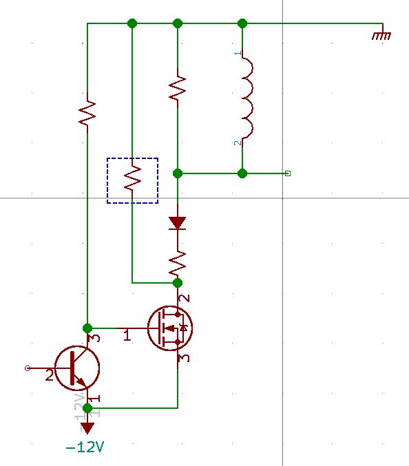

      The 56k resistor should be from the MOSFET drain (and the HV diode) to system ground (or maybe should be across MOSFET's Drain to Source).
      It is needed since the diode blocks discharging the MOSFET's Drain charge.
      Is it needed? Looks to me to be better without a discharge resistor.
        That post was originally by Carl.
        Something like in the dashed blue line - ?Click image for larger version
Name:	56k Position.JPG
          Agree. Latest thinking is that it is best to leave the drain/diode junction charged as it reverse biases both the mosfet and the diode, which results in the coil seeing less parasitic capacitance in the receive period.
          Eric.
            Eric.
                  Eric.
                  True. Adding the resistor makes things worse, as it increases the time before you can sample.

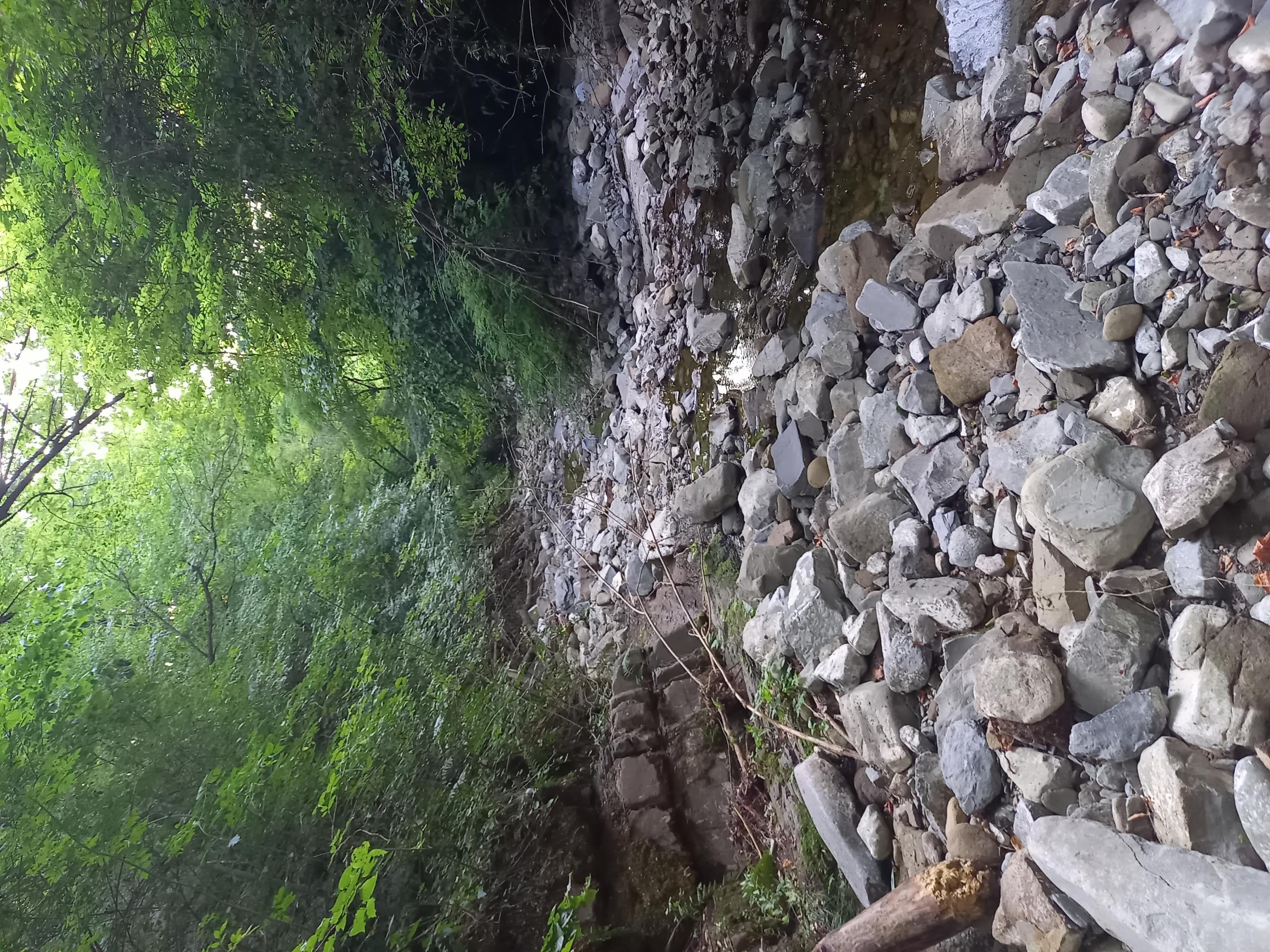

                      I did go to one of the sites (a creek with lots of rocks) with a regular VLF (Vista Gold) and it failed miserably.
                      Did not ground balance very well (3/10) points for GB.
                      On the positive side it does detect small items in air better than Golden Mask 1 & 4 and Minelab FT16000 & Goldquest.
                      I will definitely need a custom built machine to hunt over there.

                            Looking at the conditions in your picture of a creek, I think a 20cm coil would be about right, and maybe of the dual field type to improve the sensitivity to the smaller nuggets at the coil centre. Another possibility is a ferrite cored probe to get in between rocks and in crevices.
