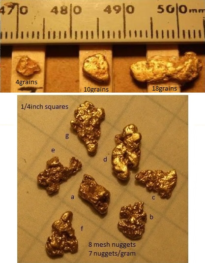

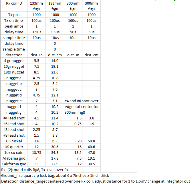

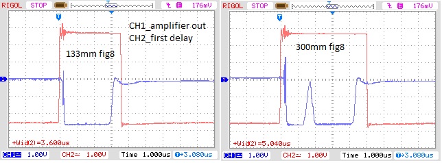

            Adding a reply to this thread since it's about detecting small nuggets. One thing on my bucket list would be to find a nugget with my DIY detector. Never done any metal detecting and don't live near a place that has nuggets so I'm thinking odds not good. Doing some testing with what I have so far. Detector would need to be able to detect nuggets if I had to travel couple thousand miles. I did get the detector to detect #9lead shot in an air test, detector does ground balance. When I get timings right I can test some lead shot in the back yard. Including a test with 133mm ID figure8 coil(looked at change in integrator out instead if swinging targets because it was easier, 1 to 1.5 mV change at integrator out is detectable with GB off. Have a 300mm ID figure8 to test next. Maybe need to make a 200mm ID figure8 coil.
            Reading the forum, probably should have made Tx bipolar not unipolar. Could change delay and sample timings to improve detection distance for small nuggets which would effect larger targets, not sure what to try.
              Tested the 300mm fig8. Didn't do the nuggets since couldn't detect the #8 or #9 lead shot. #4 and #6 lead shot were better over the coil edge than coil center. Probably not a good nugget coil, maybe due to needing a longer delay time before sampling.
                Good experiments Green in reply #35, #36
                  Wasn't thinking about the 4, 10 and 18grain nuggets earlier. 133m(300mm). 4grain 5.5inches(5.5inches). 10grain 7.5inches(9inches). 18grain 8.5inches(11inches). Some improvement with larger nuggets.

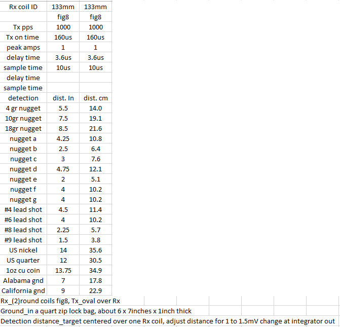

                        More thinking for bipolar Tx for small nuggets. https://www.geotech1.com/forums/atta...7&d=1606753902 comparing 133mmRx with 300mmRx.

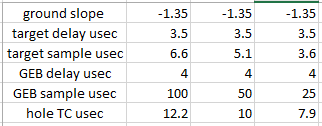

                        Looks like 133mm might be better for small nuggets. Especially if detecting #8 and #9 lead shot is important. Thinking probably need GEB. Made a chart comparing different GB sample times. Ground slope and target delay would effect target sample time to ground balance(a guess what they might be). Hole TC is bottom of hole(minimum signal). Thinking 50us GEB sample time for first try. 40us Tx time gives about 1A peak. Could Tx 8000pps, thinking 4000 or 5000 to start with. Any thoughts appreciated.

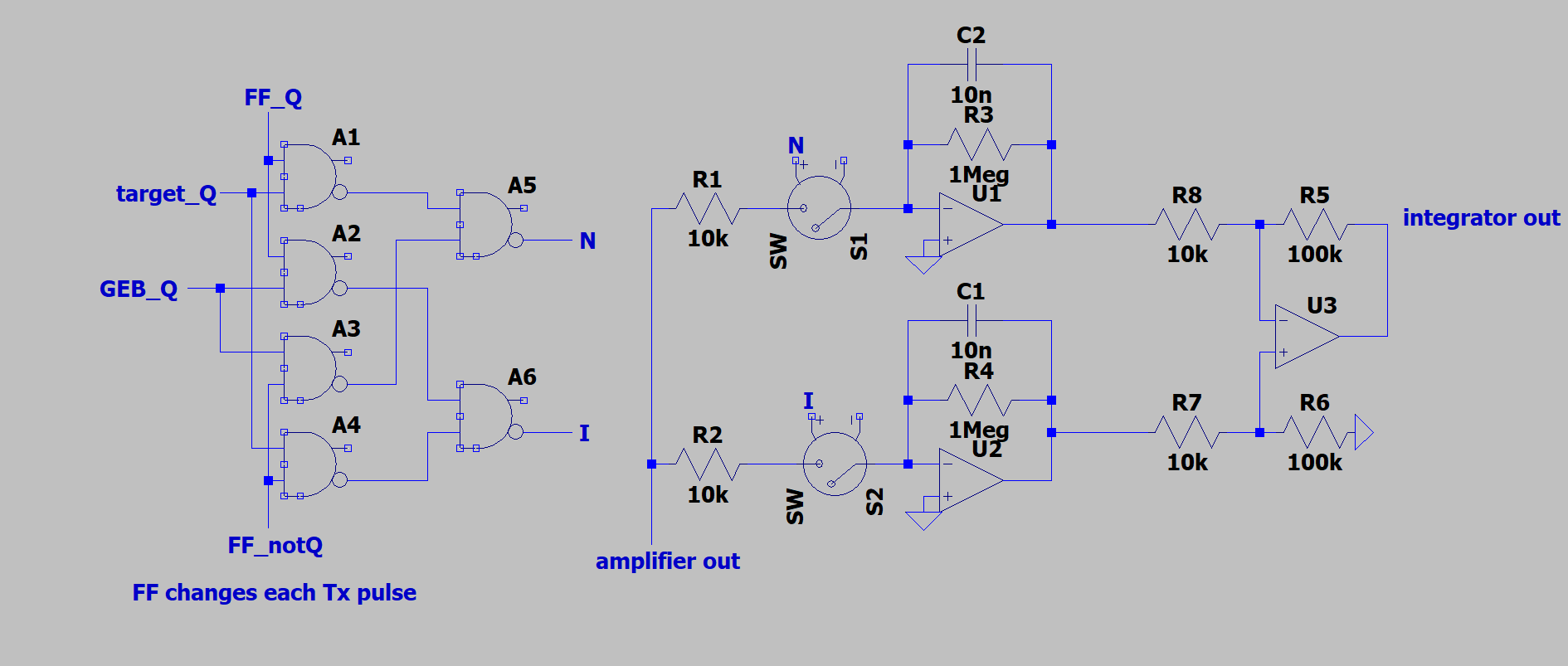

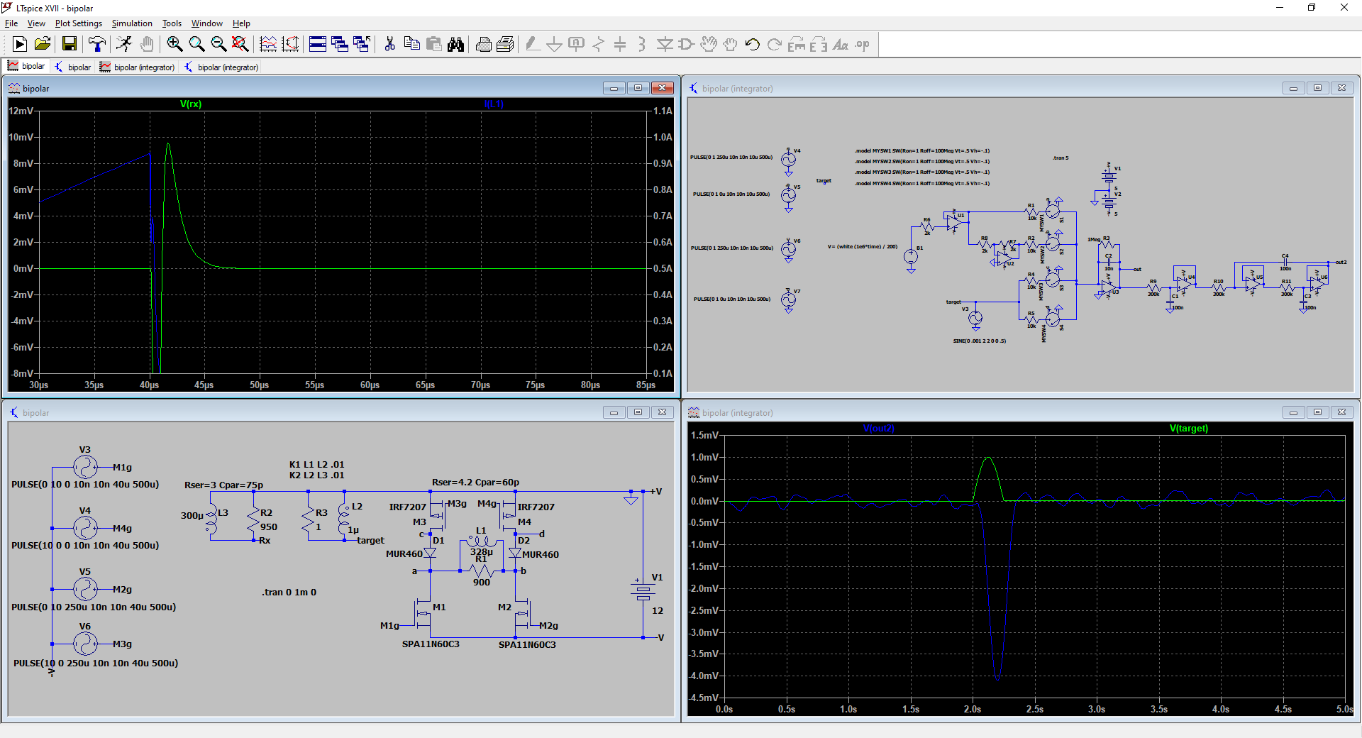

                          What I'm thinking of trying. Spice integrator for comparing S/N. Doesn't include switching amplifier output to integrator for target and GEB(bipolar Tx3). U4, U5 and U6 make a 3pole Butterworth filter, probably try a switched capacitor instead. Any suggestions to make circuit better or obvious errors?
                          Still thinking bipolar vs unipolar doesn't effect S/N very much if average Tx current stays the same. Hoping someone can correct my thinking.

                            Hi green nice work, just so I understand your sim, are you using a bifilar coil ? (L1,L3)
                            • #44
                              The detector coil is figure8, Rx(two round coils fig8, Tx(oval over Rx). I made a simulation for bipolar and unipolar to compare. Was thinking single Rx coil would give similar results as fig8 Rx for comparison. The actual circuit needs a absolute value after the integrator that a single Rx coil doesn't need.
                              I use a figure8 Rx because it reduces pickup noise and ground signal.

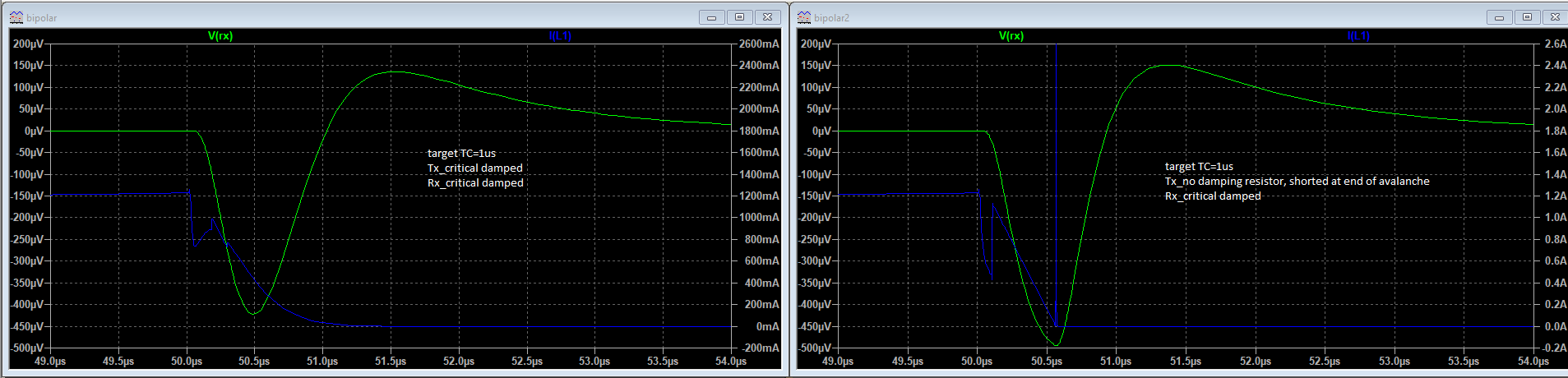

                              • #45
                                Have wondered if there is a way to damp the Tx coil to allow earlier sampling. Tried with spice. Better but not much. Would take more circuit, should I expect a bigger difference if I made a real circuit?
