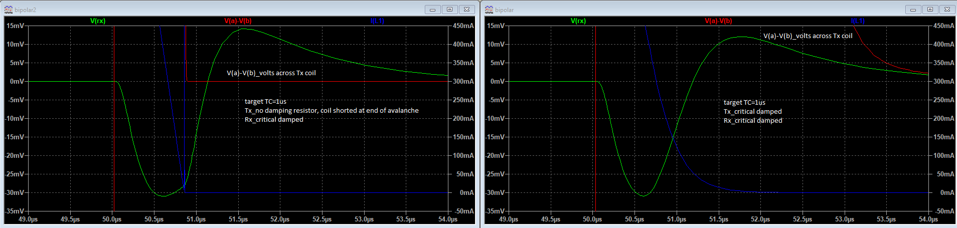

    Have wondered if there is a way to damp the Tx coil to allow earlier sampling. Tried with spice. Better but not much. Would take more circuit, should I expect a bigger difference if I made a real circuit?
    Tough question, spice is a great tool, but useing real circuits gives us a real world result with the types and quality of the components that we have access to.
    • #47

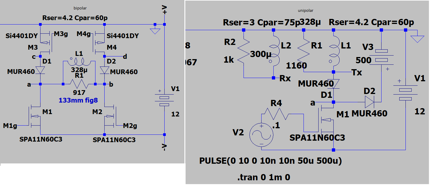

      Made spice simulation bipolar, similar to my unipolar circuit. Need about 3.5us delay with my circuit, spice circuit looks like less than 2us delay would work. Maybe my amplifier or something I'm missing is the problem. Wondering if coil volts not decayed enough could be causing the problem. Coil volts=rate of current change(X signal?). How low should the rate of change of Tx current be when sampling the signal with a PI(separate Tx and Rx)? .015V/300uH=50A/second, could that be a problem? Looks like trying the circuit not critical damped would be worth trying?

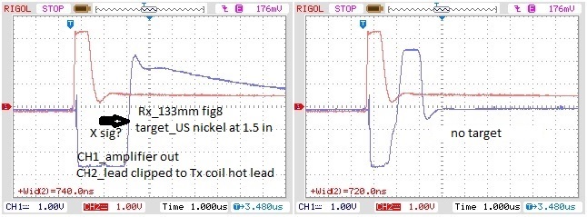

          Wondering about the X signal(coil current not decayed enough)I did a test this morning with the 133mm fig8 coil unipolar circuit. Adjusted damping for best amplifier out signal. X and R signal are opposite phase for non ferrous targets(nickel). Amplifier signal goes more negative until R signal overrides X signal at about 2.5us after Tx off. Maybe the reason can't sample closer to spice simulation time around 2us delay? Make sense or am I still missing something?
          CH2 clipped to Tx coil hot lead insulation not hot lead.

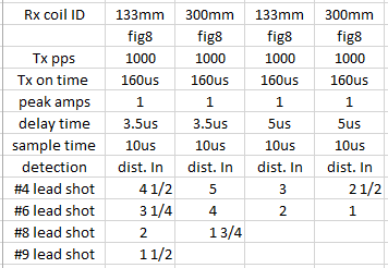

                A test comparing 133mm and 300mm I.D. coils at 3.5 and 5us delays with #9, #8, #6 and #4 lead shot. Tested lead shot is good for comparing distance for nuggets less than about 2 grains. Adjusted target distance for about 1.5mV change at integrator out.

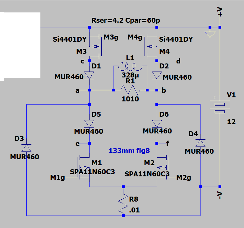

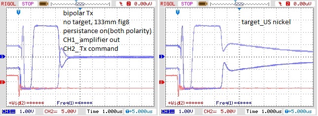

                        Made a bipolar Tx circuit similar to picture(Tx eight). Different MOSFETS, used what I had. Bipolar doesn't look bad, unipolar circuit needs less damping(spice circuit also). Including spice simulations I've been paying with. Has anyone tried dumping the coil current to zero similar to bipolar2 simulation. Looks faster than critical damped but requires turn off time to repeat to 1 or 2 nano seconds(spice simulation). Anyone have another suggestion for dumping the coil current faster than critical damped.
                        Forgot to turn on a target, bipolar2.zip

                          https://www.geotech1.com/forums/atta...8&d=1610389484 D1 isolates the coil from the M1 during discharge with the unipolar circuit. Any ideas isolating the coil from M1 and M2 during discharge with the bipolar circuit? Real circuit effected more than spice circuit.
                          • #58
                            Do the same thing, add series diodes.

                              Not sure where you are suggesting adding the diodes. I added D3,4,5 and6 in spice. Looked better in spice but wasn't better in real circuit. Used 5EWH06 diodes instead because didn't have enough MUR460 which I used for D1 an2.
                              • #60
                                I have the same simulation except d3 and d4 which i dont have and a board design waiting to be finalized. In what way it wasnt better? The coil settle time is not improved?
