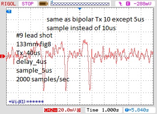

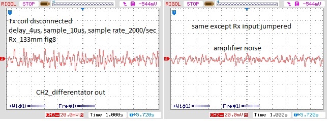

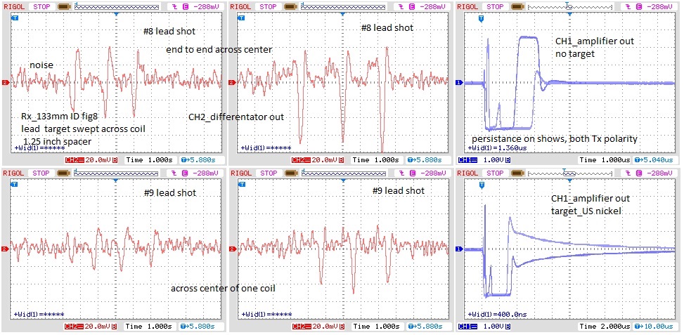

            Zapped a couple fet drivers yesterday. After repair I decided to do a couple tests for reference as I try to improve the detector. I've been lighting a led when signal exceeds a threshold for detection distance. Recorded signal to compare S/N if noise changes later when I try to improve the circuit.
            A plastic ruler was spaced 1.25 inches above the coil and targets where swept across the ruler. End to end across center and across center of one end.
            Noise appears to be random. Wondering if the no target(noise)trace looks like what I should expect.
            Tx_40us about 1A peak, delay_4us, sample_10us, 2000 samples/sec
            Added another test. #9 lead shot end to end across center(forgot to label picture). 5usec sample instead of 10us. S/N is better but not as much as I was expecting?

            • #66
              I see I labeled bipolar Tx 10 pictures wrong. Left shot pictures should be across center one end, right shot pictures should be end to end across center(higher amplitude).

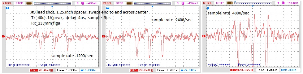

              • #67
                Another test. Varied the pulse rate(sample rate). S/N looks higher for higher sample rates. Would be better if noise was more consistent and lower.
                • #68

                    Some of my noise is coil pickup.
                    • #70

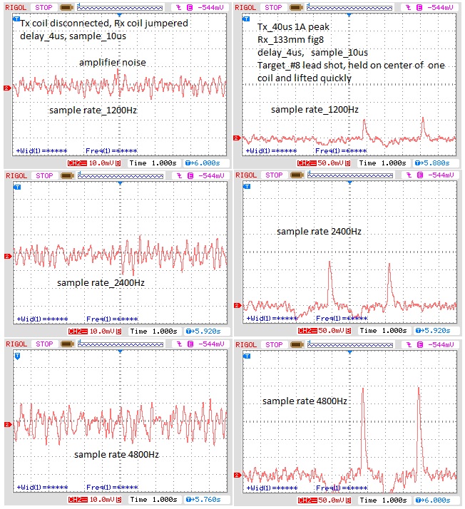

                      Increasing sample rate has been suggested for increasing S/N. Doubling sample rate doubles integrator gain(integrator gain=Rfdbk/Rin*sample rate*sample time). To increase S/N, noise signal would have to increase less than double. Don't know what increase in noise to expect if sample rate is doubled. Tried a spice simulation awhile back with white noise, appeared square root of 2(1.414)might be close. Test bipolar 12, doubling rate didn't double signal gain so I tried another test using #8 lead shot(better signal to noise) and held target on center of one of the coils and lifted quickly(hopefully more repeatable). Looks better, signal increase closer to double. Noise increase less than double, maybe close to 1.5.
                      • #71
                        Have you tried doubling the sample rate plus doubling the integrator time constant?
                        Eric.
                        • #72
                          Eric.
                          Not sure I'm correct at what you are suggesting. I use a integrator with the switches out side the feedback loop. Gain=Rfdbk/Rin*sample rate*sample time and TC=Rfdbk*Cfdbk. Doubling sample rate doubles gain and TC remains the same.
                          With switches inside the loop. Gain=Rfdbk/(2*Rin) and TC=Rfdbk*Cfdbk/sample rate/(2*sample time).
                          With switches inside the fdbk loop, doubling sample rate should halve the TC. Doubling Rfdbk should increase the TC back to where it was and double the gain. Same as integrator with switches outside the loop.

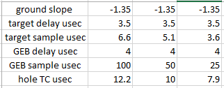

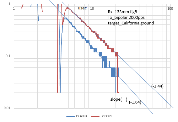

                            More thinking for bipolar Tx for small nuggets. https://www.geotech1.com/forums/atta...7&d=1606753902 comparing 133mmRx with 300mmRx.
                            Looks like 133mm might be better for small nuggets. Especially if detecting #8 and #9 lead shot is important. Thinking probably need GEB. Made a chart comparing different GB sample times. Ground slope and target delay would effect target sample time to ground balance(a guess what they might be). Hole TC is bottom of hole(minimum signal). Thinking 50us GEB sample time for first try. 40us Tx time gives about 1A peak. Could Tx 8000pps, thinking 4000 or 5000 to start with. Any thoughts appreciated.
                            Tried GB today. Couldn't GB, not enough adjustment range. I set ground sample time then adjust target sample time with 4us delay between to minimize ground signal. Calculated adjustment ranges based on my guess for ground slope. bipolar Tx1.png. Slope a lot steeper with short Tx times. Been using 160us Tx lately. Need to change my adjustment ranges. Thinking 40 or 80us Tx would be good when using the 133mm fig8 for small nuggets. Larger coil could use a longer Tx pulse(maybe 160us)with a 6us instead of 4us first delay. Would need different adjustment ranges. Maybe there is a better way to do ground balance?
                            Ground target_ quart zip lock bag filled with some hot dirt from California about 6x7inches 1in thick.
                                Hope I didn't make any errors.
                                Just double the capacitance and keep resistors the same. Response speed should be the same as you had at the lower sample rate, but better noise averaging.
