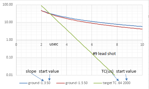

      Searched 1 thru 5. Some good threads. Not to repeat at lot of the information, I'm wondering if we can make the goal to detect a piece of #9 lead shot with a PI detector. First in air and then in ground, maybe 1 or 2 inches. More if possible.
      1. Fully stimulating a .64us TC target shouldn't be a problem.
      2. Including a decay chart for target and ground with 2 different ground decay slopes(Tx time and shape are a couple things that effect slope). Decreasing delay time .45us doubles target signal. How best to decrease delay time .45us without decreasing signal?
      3, 4 and 5 need answers.

          Thanks for the reply. Lets look at number 1. Sweep speed 24inches/second, target over coil .25seconds. When we sampled data at work we tried to sample desired signals at least 10 times, 20 times was better. Sample 2000/second(target signal 500 samples) sample 8000/second(target signal 2000 samples). Sample rate either case is more than enough to define signal. Using spice to integrate white noise and a target signal, increasing sample rate 4 times doubled noise and increased target signal 4 times(doubled S/N). I think real circuit similar. If noise is ground signal I'm thinking no increase in S/N. Maybe I'm missing something?

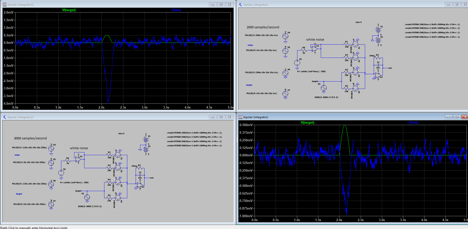

                Been having fun learning bipolar Tx. Wondering if I compare S/N, unipolar vs bipolar. Same integrator circuit, coil, Tx on time, Tx pulses/sec. Would bipolar be better?

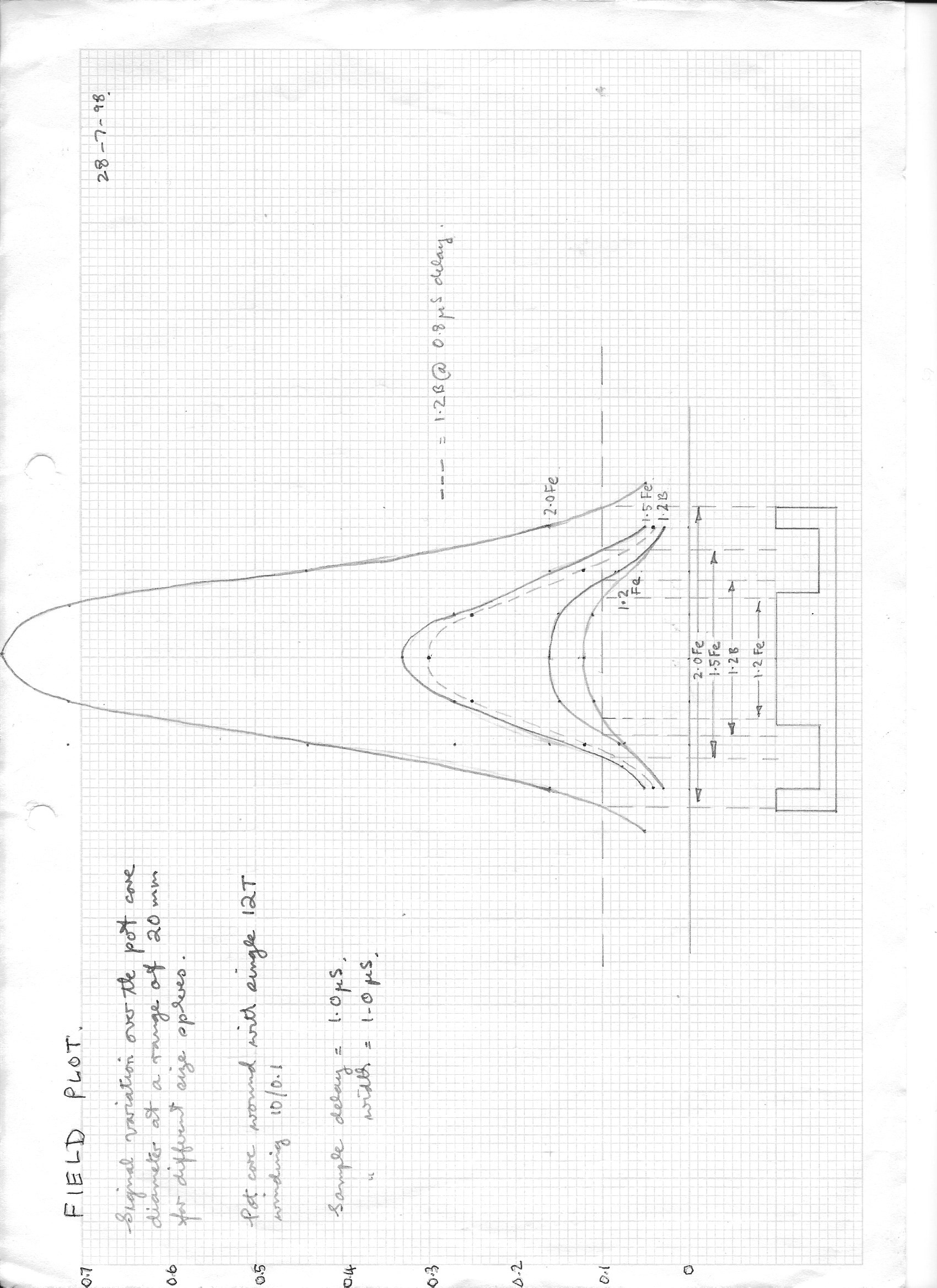

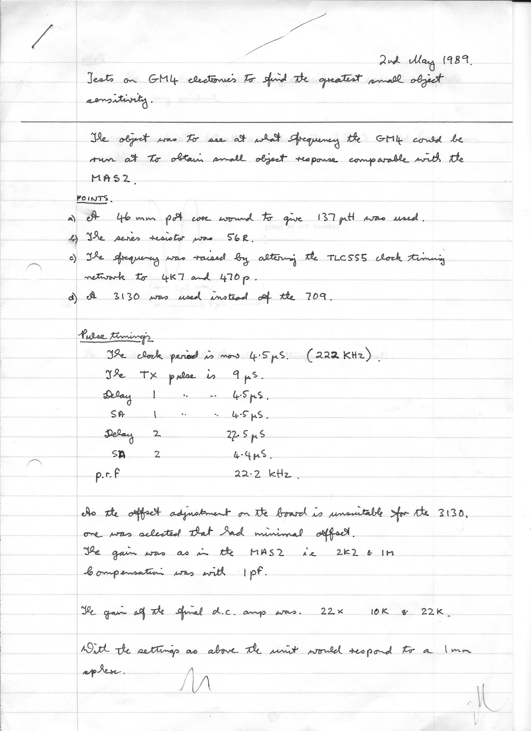

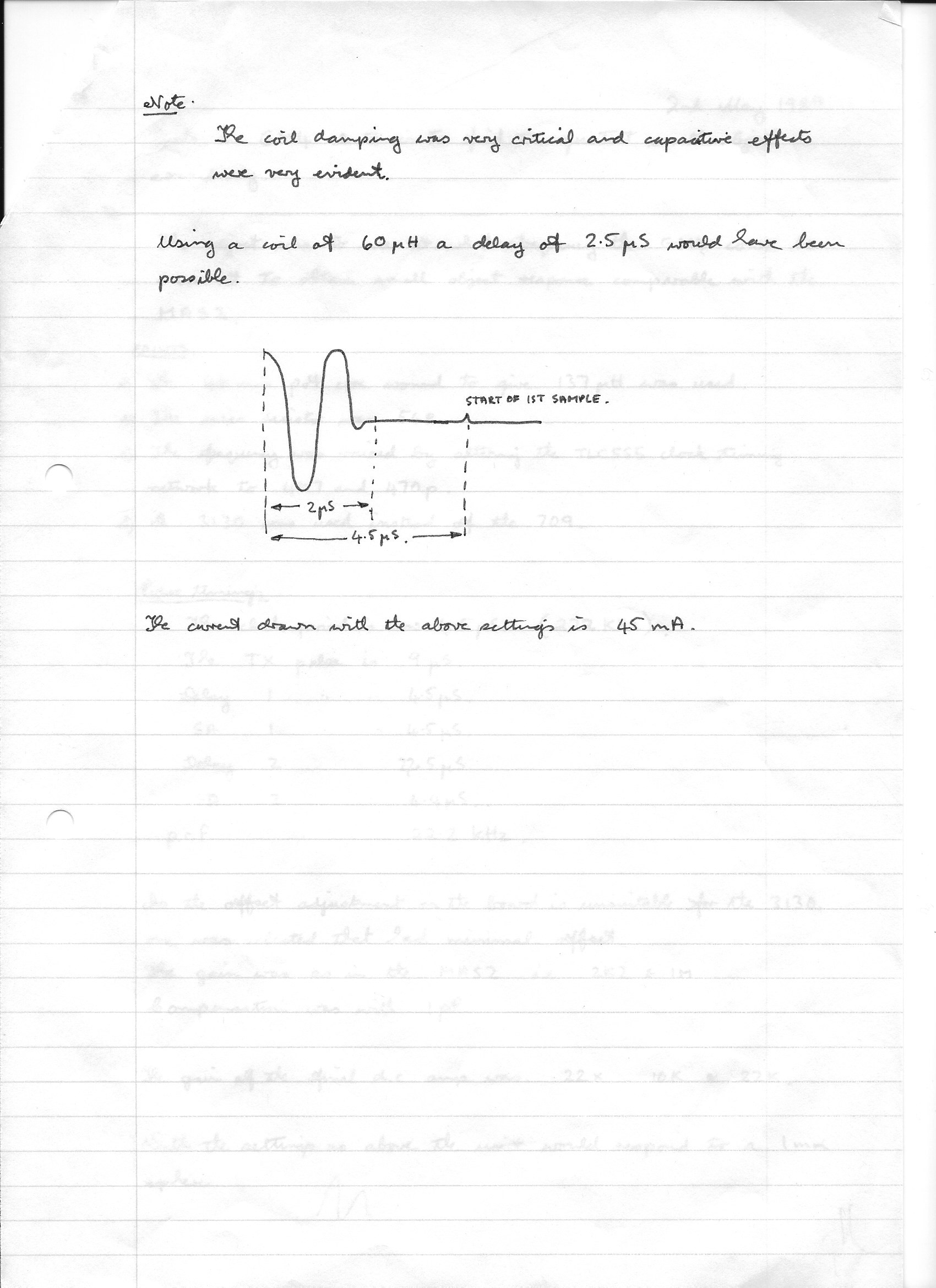

                  Joe Rogowsky made this point 'If you can reduce about 90pf of capacitance from the coil circuit due to cable capacitance, you have the potential to reduce the delay. However, this means putting the active circuit pieces close enough to the coil to allow this to happen. This is where doing some creative thinking is necessary to achieve your ultimate goal of detecting #9 lead shot at 2 inches depth'. Here is some creative thinking-------
                  Take a large pot core half, say 150mm diameter, and wind the coil on a bobbin to fit. Cut an aluminium disc 150mm and 2-3mm thickness. Mount the electronics on the aluminium plate which is then secured to the back face of the core. The leads from the coil pass through a hole in the plate, straight to the electronics with no intervening lead.
                  With the short Tx pulse of no more that 10uS, any leakage flux around the core will not give rise to any significant eddy currents in the plate. Use a delay of say 2uS and a rep rate of >10^4 pps at a low peak current and you should get close, or even better. This works!
                  Eric.

                      This is not something I am currently doing. The last time I was working with a pot core was in 1998 when I obtained some 70mm diameter ones. Prior to that in 1989, I modified a PI frisker design to run at very short delays, using a 46mm pot core.
                      I was surprised to find these huge potcores such as 150mm and even up to 300mm by a German manufacturer called BLINZINGER. Hate to think what a 300mm would cost. No way am I going to fork out that sort of money.

                        [ATTACH]54412[/ATTACH] [ATTACH]54413[/ATTACH] [ATTACH]54414[/ATTACH]
                        Eric Invalid Attachment's
                          Eric.
                          If I click on them they work. They should have appeared as .jpg's so will load them again.Click image for larger version
ID:	359114 Click image for larger version
ID:	359115 Click image for larger version
                            If I click on them they work. They should have appeared as .jpg's so will load them again.[ATTACH]54418[/ATTACH] [ATTACH]54419[/ATTACH] [ATTACH]54420[/ATTACH]
                            Eric they are working now thanks.

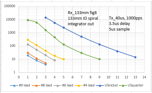

                            • Charted signal vs distance for some targets. Think it's more repeatable. Noise level effects detection distance. The lead shot cover .5 to 1.5us TC targets(small nuggets). Nickel(10us TC) and Quarter(145us TC)targets to see what effect changing Tx and sample times parameters have on higher TC targets.
                              The quarter looked different. Changing Tx Rd effects the higher amplitude(lower distance)points. Under damped reads higher volts. Any thoughts why?
                              Thinking of trying Tx 40 and 80us, sample time 5 and 10us and first delay 3.5, 6 and 10us. Any thoughts?
