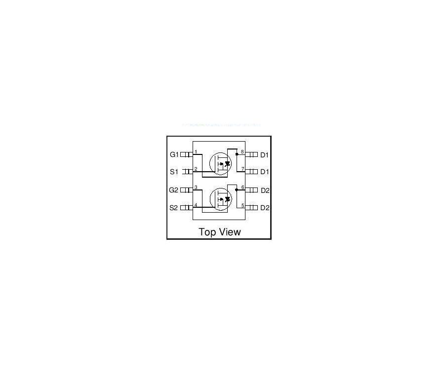

    Does anyone know which mosfet npn double has this pin in /out ?Click image for larger version
    Something is backwards with the gate & source...
      Yes, but I would say so !Only with this pin in/out does the device work !
        Do you mean ignore the pin labels and go by the internal drawing?
        If so that is the common connections for a dual, 8-pin P-ch MOSFET.
        Example:
        https://www.mouser.com/datasheet/2/4...ey-1763764.pdf
        Or do mean ignore the internal drawing and only look at the pin labels?
        Is the MOSFET a P-ch?? or an N-ch??
        Are you looking at it from Top or from bottom?
        If in a circuit maybe the leads were bent around and it is actually installed upside-down. Some makers do that to try to keep someone from figuring out what parts they used.
