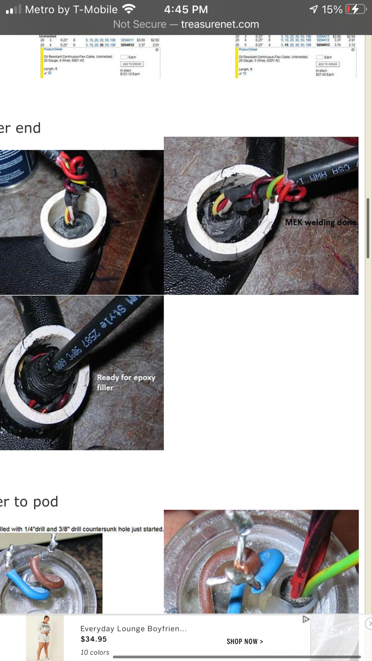

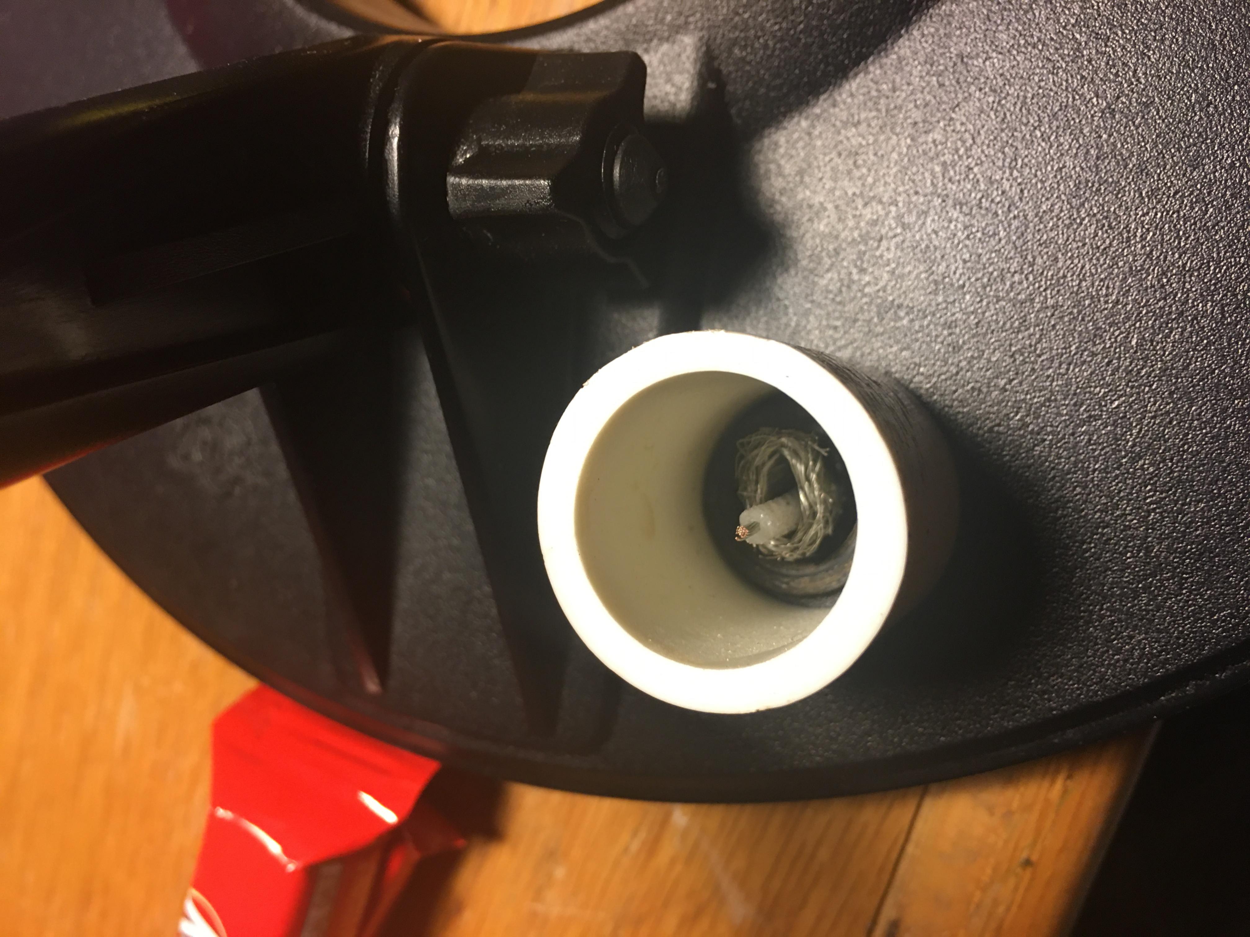

Carl not sure which way to proceed now. I do want a waterproof machine. What do they seal the coils with at whites? I was also thinking of doing like with an excal, it is what I meant to convey above but I am ok considering to fill the coil with epoxy as well. Not sure how that will effect the capacitance of the coil.
Need advice

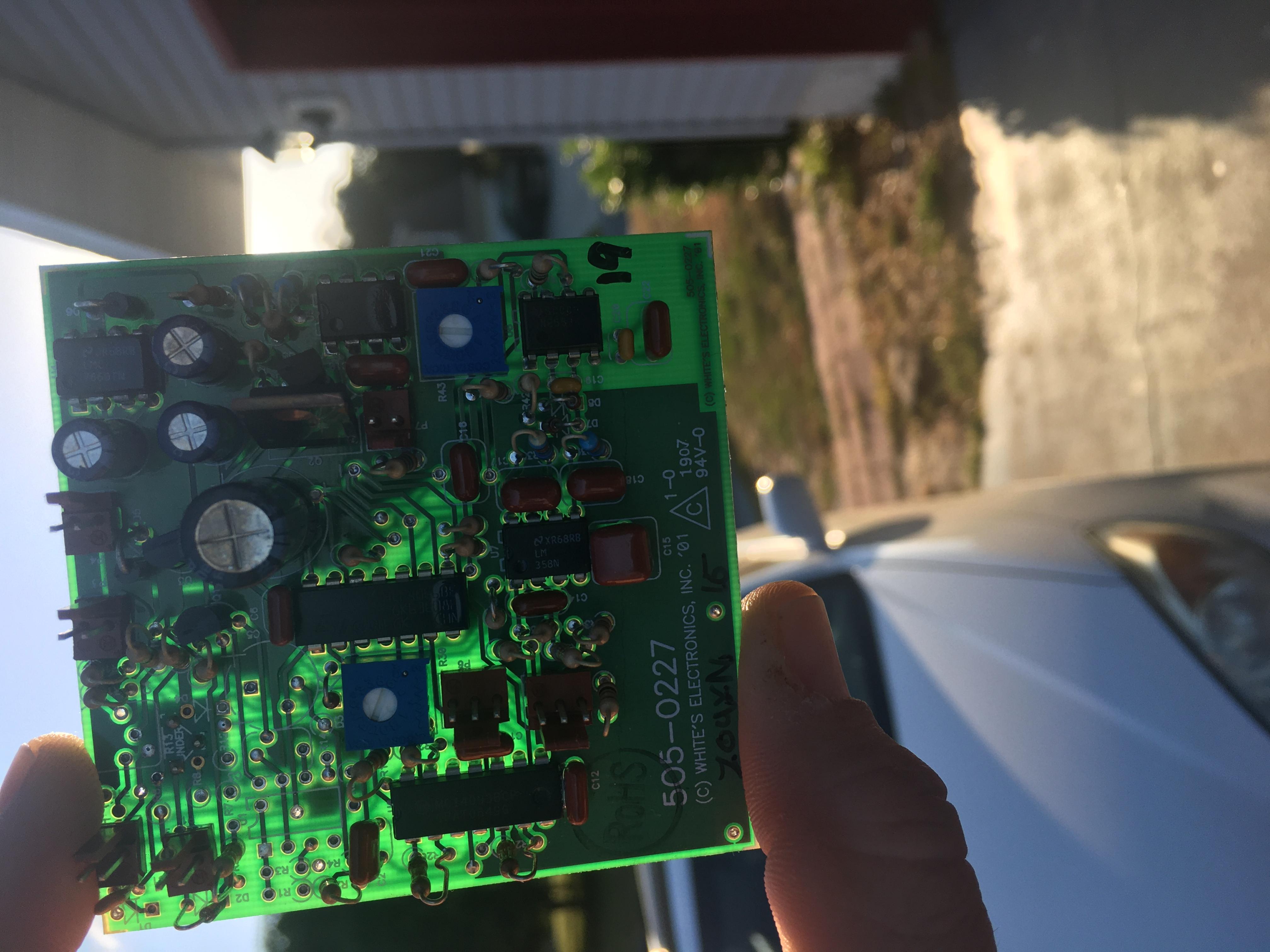

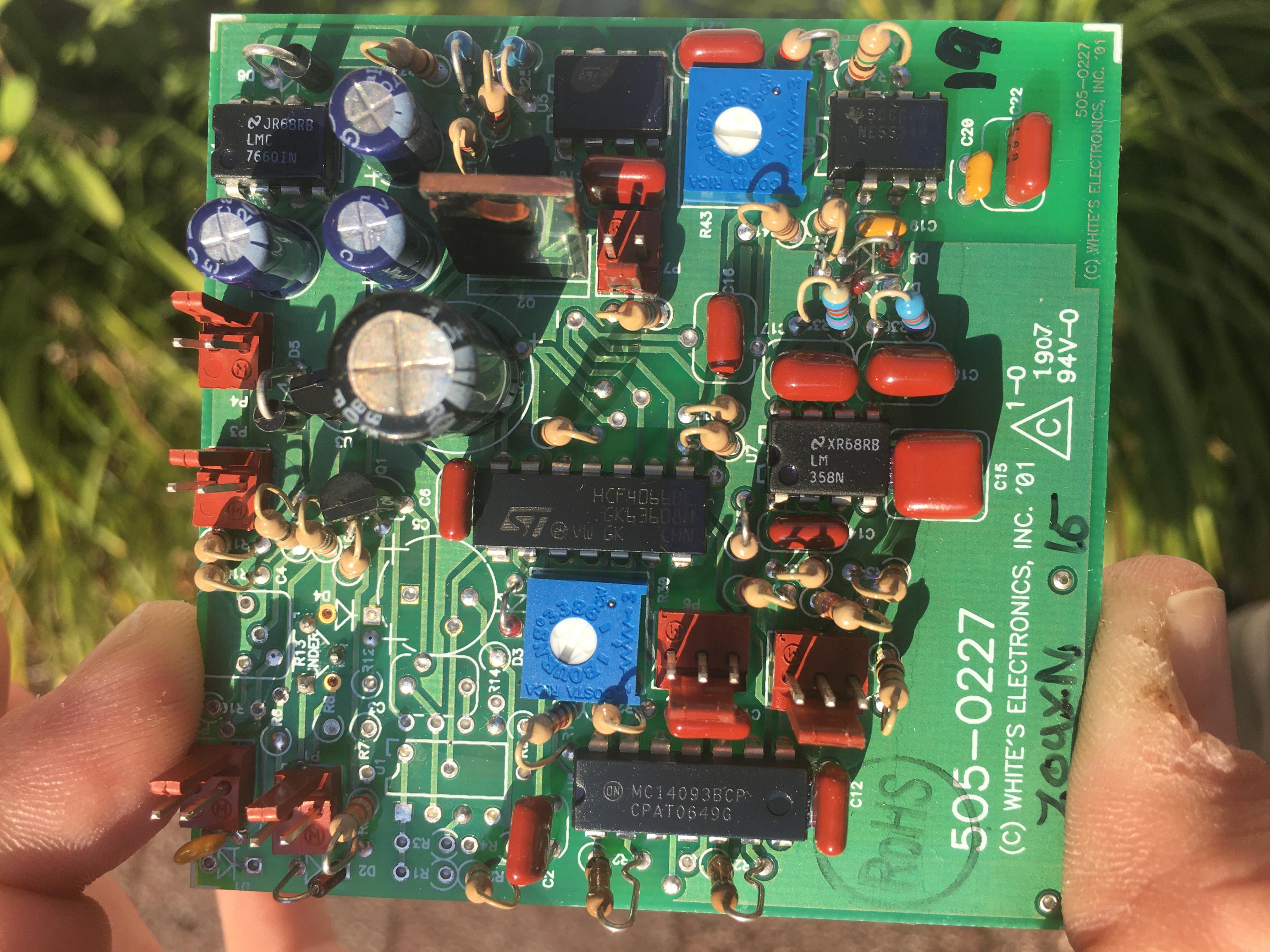

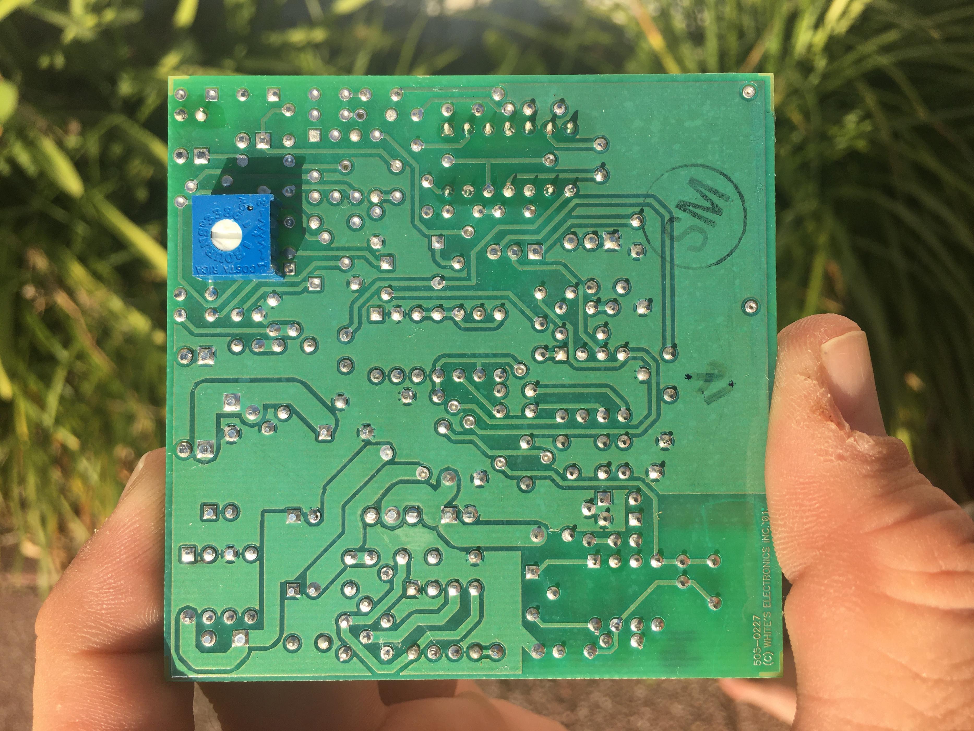

thank you CP for pics. back board side pic is especcialy nice, near to perfect one. i see now it's whites' 505-0227 board.Originally posted by Cladpirate View PostKt315 hope this will do. Any questions on parts numbers just ask. [ATTACH]55402[/ATTACH][ATTACH]55403[/ATTACH][ATTACH]55404[/ATTACH]

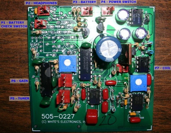

we have a schematic of it from Carl M., fabric sch.
if you do camera shot orient a board in the way like you read - all signs and silk grafo must be in right reading orientation.
not inverted. i give an example what i mean.Attached Files
Yes, a dual field will work. SMPI was sold with a DF coil for a while.Originally posted by Cladpirate View PostI have another question for the group please. Would a duel field coil work with this machine or does anyone know of a decent low profile coil that will work well in the water?
Many water coils are poorly designed. What you want is a very thin profile, skinny donut, with a center-mount clevis. Some Eric Foster machines have the skinny donut and center clevis but not the thin profile. Tesoro concentrics (9x8 & 12x10) have the thin profile but not the other 2. All the water coils I have ever used are either really hard to push through the water or they flip & flop in the moving surf.
