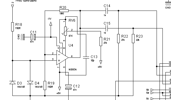

    Check everything 5534, pin 7 +8 v, pin7-7v, R18 (750om) to L, Dr IRF 740.

      dear georgi.g.zhelev
      i chek all parts and are correct
      new problem
      • PS-G
        Problem is very simple, before you is a PCB and the scheme is purely assembly error, check everything again. 5534 changes, there is positioned correctly, power +8 v,-7v. GND, trimer shifts 100k. Where the installation is correct SCHEME WORKS 100%!

          DEAR georgi.g.zhelev
          5534 I solve my problem
          My metal detector is a serious problem facing
          Detection range is now very little money with a 50 * 50 for a large target is 10 cm
          And are not altered to TRIMER Game
          When the U3 to the external circuit metal detector with the same sequence again previous works.
          Don not my problem where I circuit is about
          I was really tired of this metal detector
          Please help me

            • What about me Georgi ,
              I am still waiting for your answers for How discrimination works?
              how does it discriminates.
              What are the control parameters.

                Hello, okantex! How does the discriminator? I can not explain how it works. I SEE THAT THE WORK, THIS IS IMPORTANT! OK?
                What are the control parameters? DELAY, mks?? DELAY; mks, not a fixed parameter, it depends on:
                1. COIL mkh? ;conductor / conductor kapacitet (Lc) =?
                2.Impuls power mks?
                3.Which operational amplifier will use the receiver (NE5534, LF357, LM318or OP27 ...) is a diagram of the output with different parameters, DELAY is different.

                • excuse me,
                  how does machine decide that target is ferrous or not?
                  does it look at mks(delay) , lenght of delay
                  or signal value at specific delay time?
                  or ?

                    Sorry, my English is very bad.DELAY discriminator is a fixed setting. OSTSILOGRAMS, See the front page!
                    G.L.!
                    P.S. SEE OSCILOGRAMS " PULS STAR-G light " DIAGRAMS ARE TRUE!

                                See the scheme and ostsilogram. U5 (4053 multiplexer, 3 keys), U6a integrator channel FERROS; U6b integrator channel NONS FERROS; U7a differential amplifier (amplifier contrast, NO CLASSIC!)
                                OSTSILOGRAMS SEE! Position 7; Vc-T5 (Q5) IMPULS 50mks control key (4053 channel FERROS, integrator U6a, U7a; Position 9; Vc T7 (Q7) IMPULS 50mks (delay) 4053 managed key channel NON FERROS, integrator U6a, U7a. Output of integrators (U6a, u6b constant voltage is obtained with sign +,- ! The output of U7a difference occurs between 2 signal, this signal control mikroampermeter (indicator discrimination). OK?
