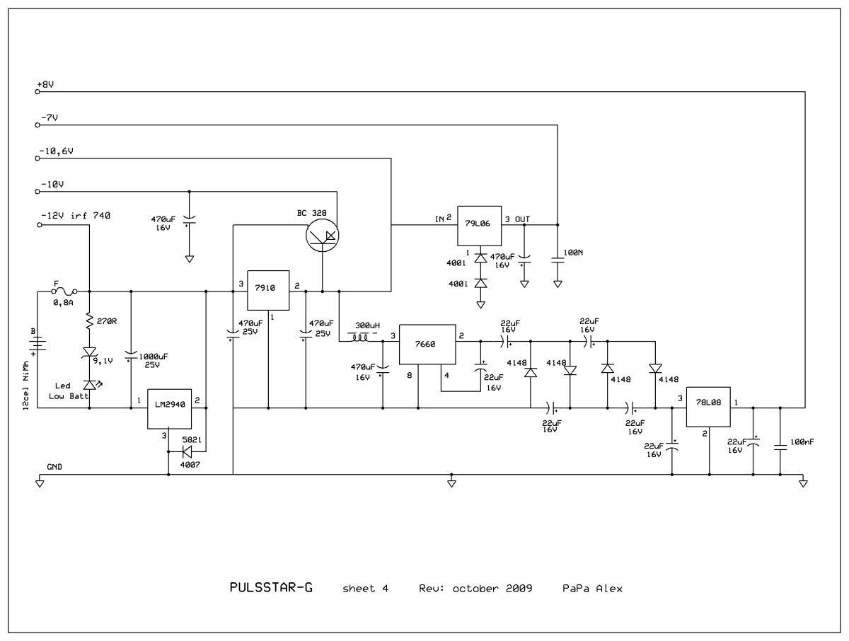

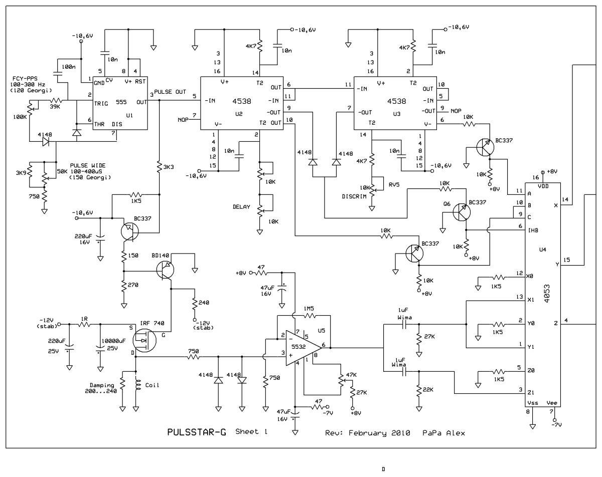

    • Hello wm6 and forum
      This is my final schematic wm6 corriged and working, it is the same that Georgi , just a small adjust in the power supply for the 5534 (47R)..
      Also remember my schematic you must paste one and one..etc... to assembling the all.
      Thanl you again Georgi,
      Alexis.
      • Also i have put more 2 half amp 062 for experimenting some filter in my board,ok...the numbers for input and output of the op's is in "my own numbers for my circuit boards" everybody can put is own ..every human mind are diferent in the concept of schematic !!! but for final result it work well.

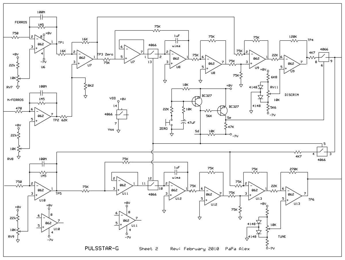

          • Dear Georgi ,
            http://www.geotech1.com/forums/forumdisplay.php?f=38
            at this link there is project. in this project , discrimination is done by samples which are taken from first 10mks.(us ) .
            inspects the change of ( sample1 - sample2 ).
            in your method
            let say first sample ( ferrous ) is taken from 150mks-200mks A1
            your non ferrous sample , 250mks-300mks A2
            you are subtract A1 -A2 = difference
            than multiply the DIFFERENCE by opamps.
            think ...........if there is no metal close to coil , there wont be output.
            if there is nonferrous metal , difference will be POSITIVE
            if there is ferrous metal , difference will be NEGATIVE
            is above correct. ?? I am not sure about it. to my opinion difference always will be POSITIVE ,but in nonferrous metals will be big.in ferrous will be small. but always positive.
            please correct me

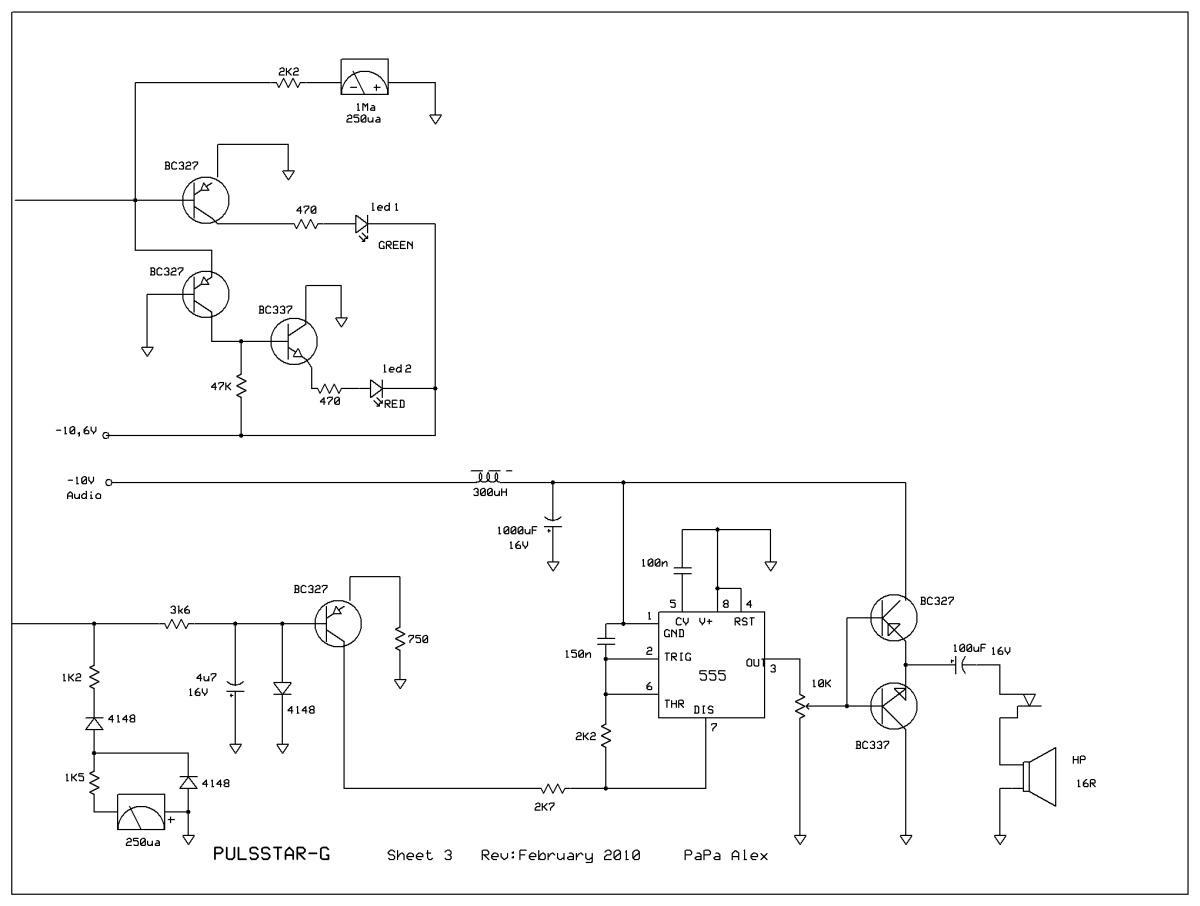

              • PULS STAR-G
                Hi Georgi,
                here started bugwhiskers very promising his project named "QED":
                http://www.geotech1.com/forums/showp...52&postcount=1
                Unfortunately, to date, we have not seen his working detector, except many claims and debate fightings that it is working and even better than newest Minelab. After 4 years of "linguistical development", "QED" is still on promising base: maybe in June (not known which year).
                Thing was commercialized even before its launch (price of "QED" kit have to be about 1000 AU$), so no complete public plans, schematic and code, only kit version to buy.
                On the other site, your project is here, is public, repeatable and free, and, as we can read - most important, it is working !!!.
                Thank you Georgi. You are our hero!

                        • PULS STAR-G
                          Hi everyone! Hi okantex! You do not believe that the discriminator
                          does it work? I made 2 pieces PULS STAR-G, THEY WORK CORRECTLY! Discriminator WORKS! "FERROS" and NONS FERROS. I will not enter into teoriatichen dispute with you, I'm practicing. He believes that the work will make PS-G, who does not believe it does not.
                          OPTIMIST MAKE AIRCRAFT, and PESIMIST MAKE PARACHUTE !! G.L!
                          • Dear Georgi ,
                            I did not say I do not believe it.
                            Everything is possible,
                            what is your coils inductance uH value?
                            according to uH value tile of signal swings, maybe this could give ferrous and nonferrous results.
                            If will say may last word after trying your way of discrimination at my project.
                            kind regards
                            ,okantex
                            • ps-g
                              Originally posted by okantex View Post
                              Dear Georgi ,
                              kind regards
                              ,okantex
                              Hi, KOMSHO!
                              I use coils : 300 .... 500mkH, discriminator works without a problem, nothing inconsistent. tuning to coil is not necessary !
                              quickly looked to link that gave me interesting proekt.Mikrokontroler and that makes it unique, I prefer the analog technique, because it can be repeated and there is scope for creativity.
