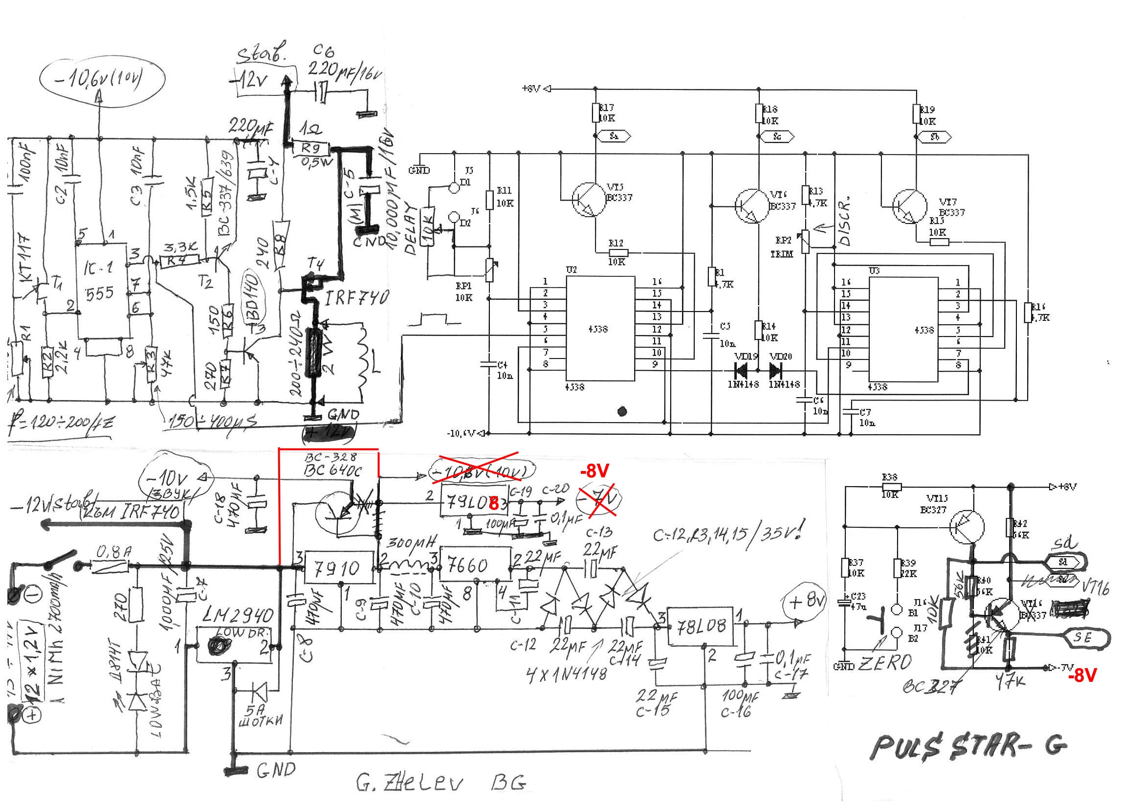

    thinking you can try to use 79L08... maybe not be so critically... reconnect it according to circuit.
      error
      a moment, Alexismex!! in NEW REVISED schematic is NOT exotic 79L07.

      Hi KT315, this schemitics is wrong because have error
      and
      How works this discriminators part ?

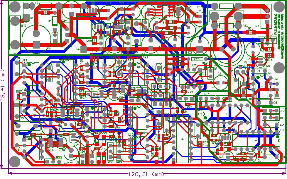

      and I need PCB for big DIP parts (not SMD) if you have please send me ?

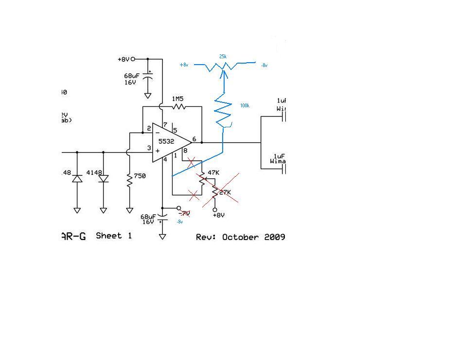

        Hi Kit,
        Thanks for sharing this info, and thanks to Alexis for the redraw
        Here is a way to get full offset from the NE5534 and use +/-8 volts
        See attached
        Mark
          can you put the pcb print picture here for us to make...looks good
            Hello Forum ,
            I understand for the balance it is better to use -7v but i will try with -8v and i will adjust some resistor , also i will check check with EIA - E6 standart value resistor (75K ? )
            The most interesting part of the schematic it is the discriminate part to check if this part permit some good discrimination over iron and no magnetic metal like copper, gold etc....
            Thank you all who help to make this possible.
            Alexis.

              I can not download pulse star pcb on link
              Полная актуальная информация о компаниях и учреждениях в Москве, городах России и СНГ. Самое подробное описание организаций, отзывы в интернете, адреса официальных сайтов, схемы проезда, телефоны бесплатно в справочнике организаций Отзывы.com.
              I think it is gerber file.

                    Last version from IMPULSE STAR - BG
                    Correct version PS-G Thanks Georgi. Now I need PCB (DIP) from it. (Like Pulse star II).

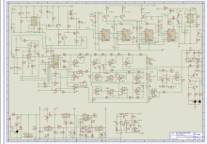

                      PULS STAR-G
                      Hi all! Hi humhum! Sorry for my bad English.Shem has an errors!!
                      comotator ( Q22,Q23 ) Q23 -no corect!!!
                      • #41
                        ''R..'' for old version
                        Thanks Georgi ,but not problem because I make(design) this for OLD schematic try version .
                        Your Detector is very very good, have deepth and Discrimination , like Puls Star II.

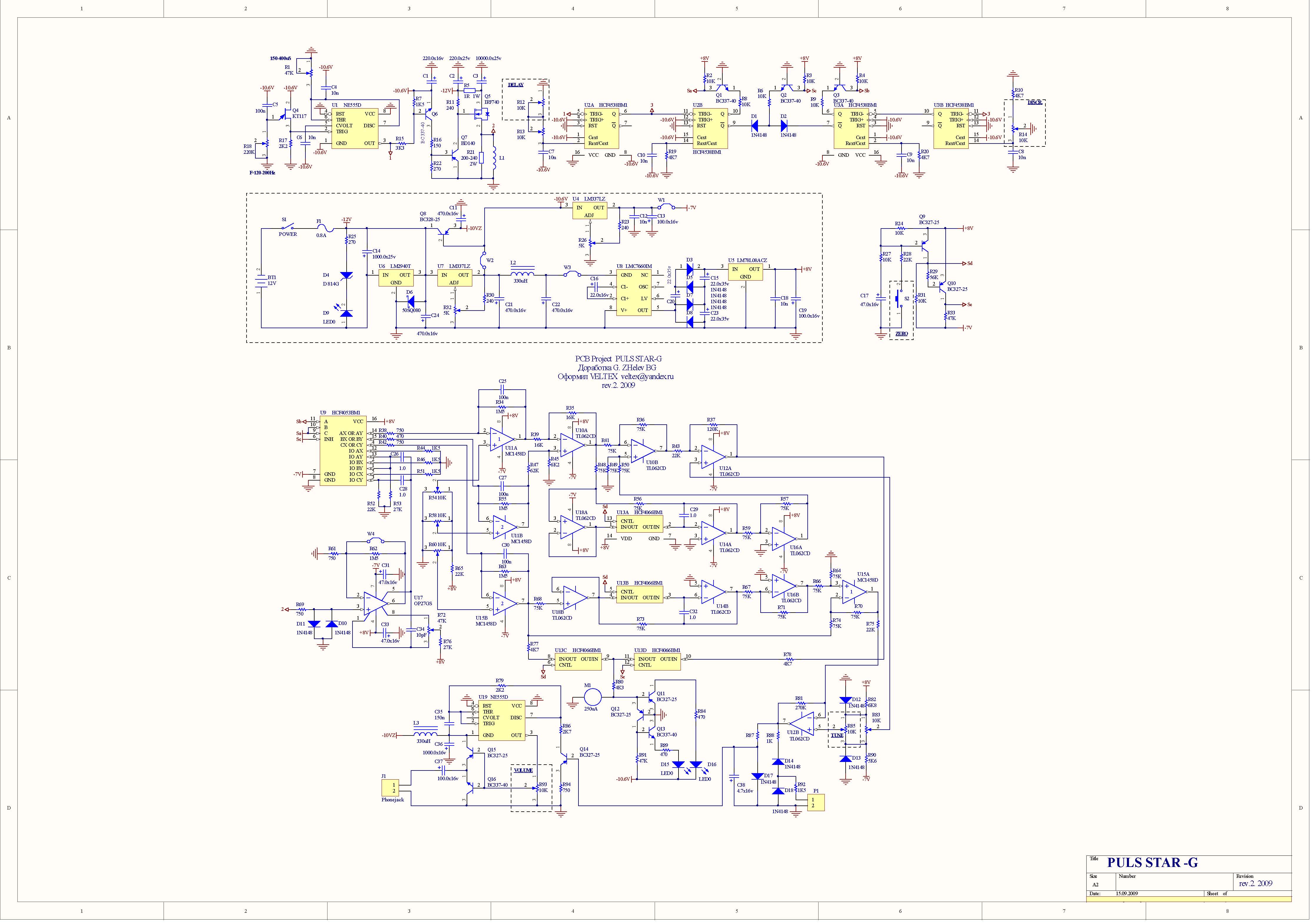

                          Hi georgi.g.zhelev
                          Your proteus drawing is perfect and good .
                          Can you upload proteus formatted file ?
                          Best regards.

                            Hi, aft 72005! I do not fail Proteus.
                            • #44
                              Hi georgi.g.zhelev
                              I didn’t understand your intent
                              My opinion was picture below
                              • #45
                                PULS STAR G
                                This scheme is not my design. This is " humhum " design! OK?
