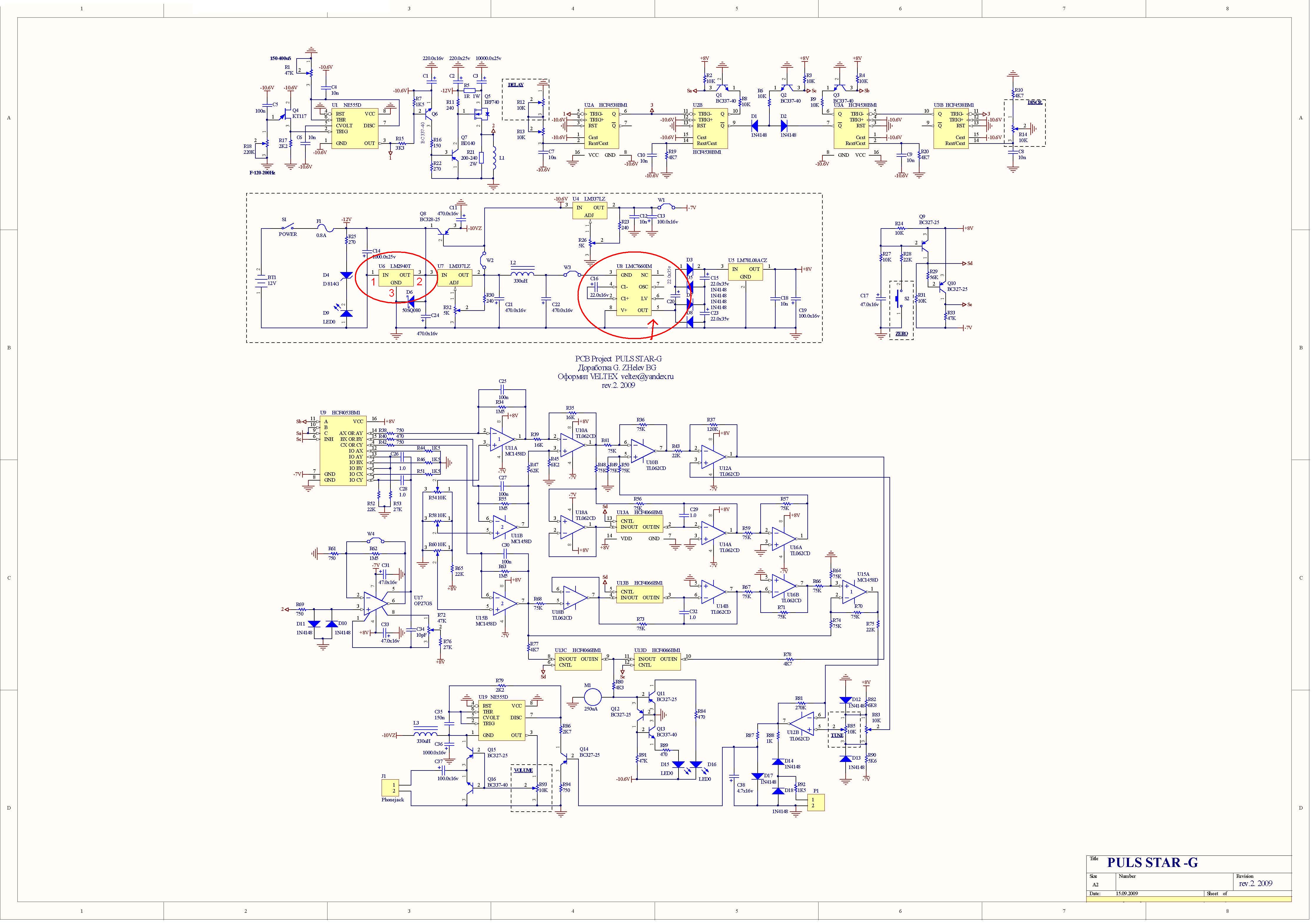

            • i have used for C19 C20 1.5mf but i have seen in the original is it 1mf which value is the best for pcb ,another thing the discrimination is not working well pls if have anyone guide me for best calibration for puls star bg and how the discrimination work for discriminate between ferrous -non ferrous.
              best regards
              aljacoub
              • hello and from G.S . I have a question and I,THE LM2940T VOLTAGE IS IN AMOUNTS
                • PS-G
                  Hi,LM2940T VOLTAGE IS 12v stab. G.L.!!
                  • THANKS GEORGI
                    • georgi ...I can not get price +8 volt I have this schematic, please help
