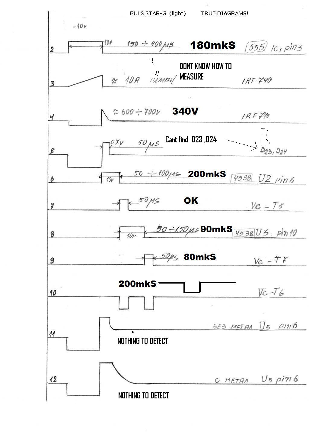

          I have finished my Pulse Star G but i have a small problem the green led light stays on and i have a little "BBZZZ" sound on my coil.I have set w/osciloscope NE555 at 120hz and pulse 70mkS....then i put in IRF740.
          Marius
          • Originally posted by steaua581 View Post
            Hello Georgi and forum,
            Marius
            sorry i ment 150 MKS not 70 MKS. But i can"t find diodes D23 D24 on schematic.
            Marius

                Hi steaua! What problem do you have? All steps are working there, you get all ostsilograms? This PCB is not my design; Check kolector, emiter all BC transistors ! D 23, D24? Sound "BBZZZ" of coil, this is normal.
                G.L.!

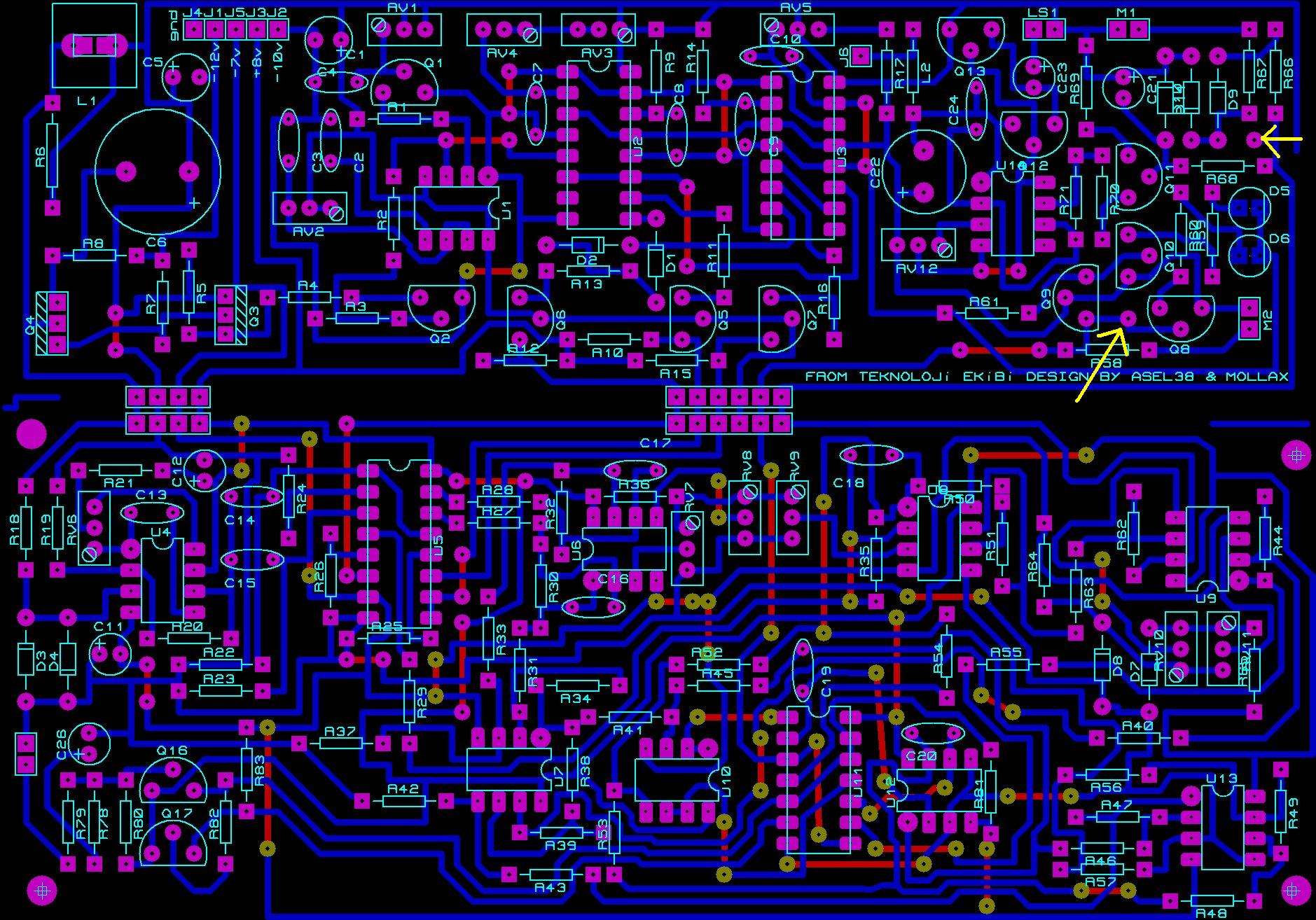

                  Hello Forum,
                  I was wondering what are the two holes on this PCB for? see atached picture...thanx and regards
                  Marius

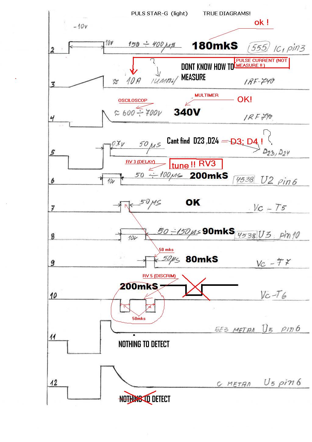

                      DIAGRAMS

                        But i still have a problem...dont know why i dont get no pulse on the Q5 collector, i have verified the resitors wich get to the Q5 collector they are all ok receiveng good voltage but no pulse on Q5.Also the green led stays on all the time...
                        What do i have to verify in order to find out why i dont have pulse on Q5?...
                        Marius

                          Hi,steaua581! Check: U 2b (4538 pin10, pulse 50mks; Q5, C8, R9, R10, R11. Change U2 (453, Q5, C8.
                          . Check the PCB!

                                Hello Georgi and Forum! I have solved the problem with the pulse on Q7.
                                I have set RV5 so i could get on Q6a Negative Pulse of 50uS.After that i have set Delay half way( 5K-0-5K)!after that with the help from RV7 and RV8 i have tuned so that i will get an output at U7A 0V, but this value of 0V its not stabile and does fluctuate between 0.20V and +0.20V!
                                Rv11 is set to half way and i pres Reset and the indicator shows me 0 but its not stabil! When i put Iron close to the coil the midle moves to the left and REd light stays on and im getting loud sound! When i put copper the indicator moves to the right and the Red light stays of and i dont get any sound! In any cases "The Green Light Stays On!detection is verry poor.A spray at 20 cm and a coper coin at 2-5cm.
                                What should i check...??
