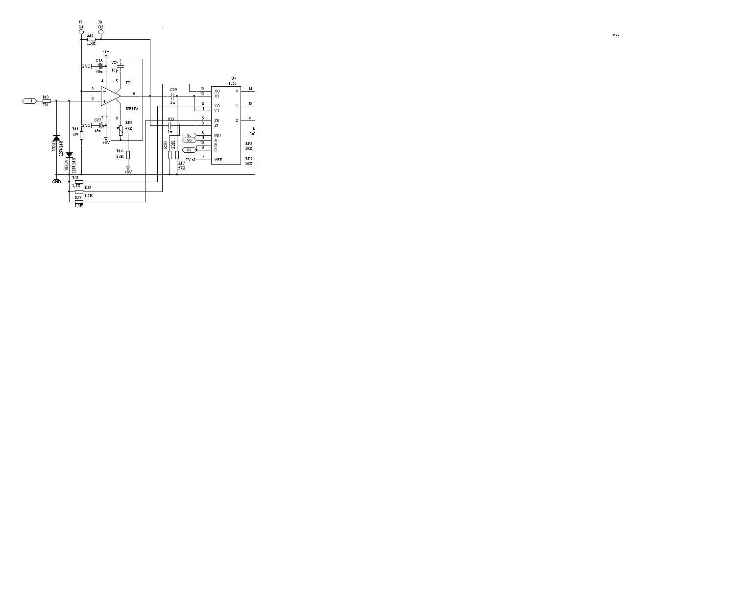

    • mohandes,fengzhai01, change R20 =1,5 M > 1M ; NE 5534 does not work well ! Change: OPA 134 , LF357, OP27 ( NO OP37). look there is a difference in the placement of the pins !

        • fengzhai01 , Please show your schemes to PULS STAR-G . (the diagram that you have done your PCB)

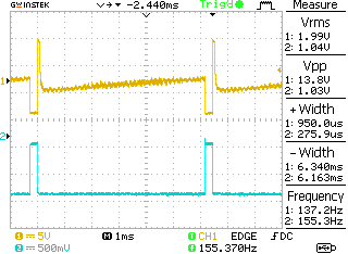

            hi georgi

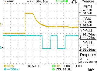

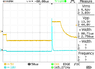

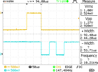

            i think my waves are ok
            look this image.
            one of them is delay (yellow)and another vc-T6
            all is ok i think if it does not i change that you say.
            please put for all your pics psg detector about ne5534-6

            • SEE # 515 !
                hi georgi
                look this image.
                [ATTACH]26250[/ATTACH][ATTACH]26249[/ATTACH][ATTACH]26251[/ATTACH]
                NO,NO,NO!There is nothing better. COIL = 350...500mkH ! True diagrams > SEE # 515!! , waveform #10 ,# 7, #9. #11 .Do you understand ?

                    • Congratulation
                      HI all guru
                      first thanks : Mr Georgi ,Mr Davor ,Mr Tepco , particularly Mr Porkluvr and Mr Carl Mr kt315 Mr 6666 and ....all my frined.

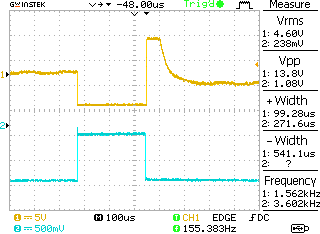

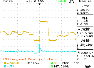

                      i am not sleep last night to solve my problem and now it is ok (i think )
                      i design again second board(oscillator) part of ne5534. i finish it and connect to my old board and I AM SO HAPPY.
                      please check my pics ,and tell me is ok or not.
                      i use C13 between pin 5 & 8.

                      • i design again second board(oscillator) part of ne5534.
                        What did you design differently ? other than C13 between pin 5 & 8
                          hi
                          look at my design(not good)
                          in this design i use 2 cap betweeen 1-5 and 5-8 , but i use just c13 in 5-8.
                          may be better figure in pin6 ne 5534?or it is good?
