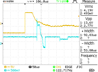

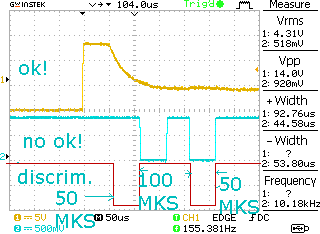

  • corectClick image for larger version
Name:	DS0018 mohandes ,disc., oscil s nadpisi.bmp
    • ok
      today i try to fix TP points but i just can set TP5 on 0.6v
      thanks

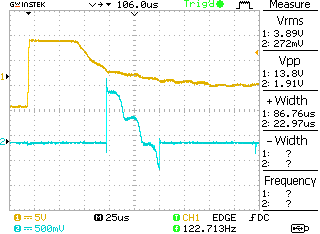

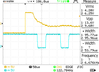

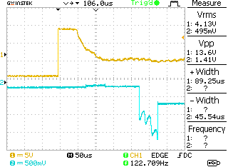

      • hi georgi
        just tell me my X,Y,Z out put have correct waves?
        X :
        Y:
        Z:

          • for more voltage amplitude you have to encrease PULSE WIDTH. also you need to change your mos-fet IRF740 on another transistor type. because max peak voltage for IRF740 is only 400V. you have reached the limit with 450V and will NOT get MORE.
