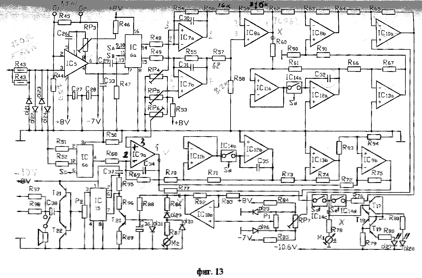

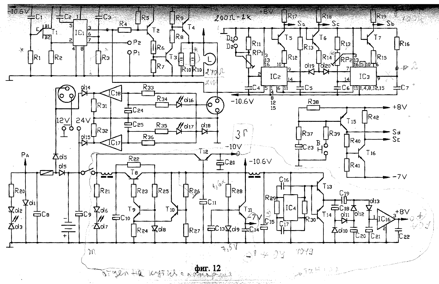

              • Original schematic in Book.Click image for larger version
ID:	334823Click image for larger version
ID:	334824Click image for larger version

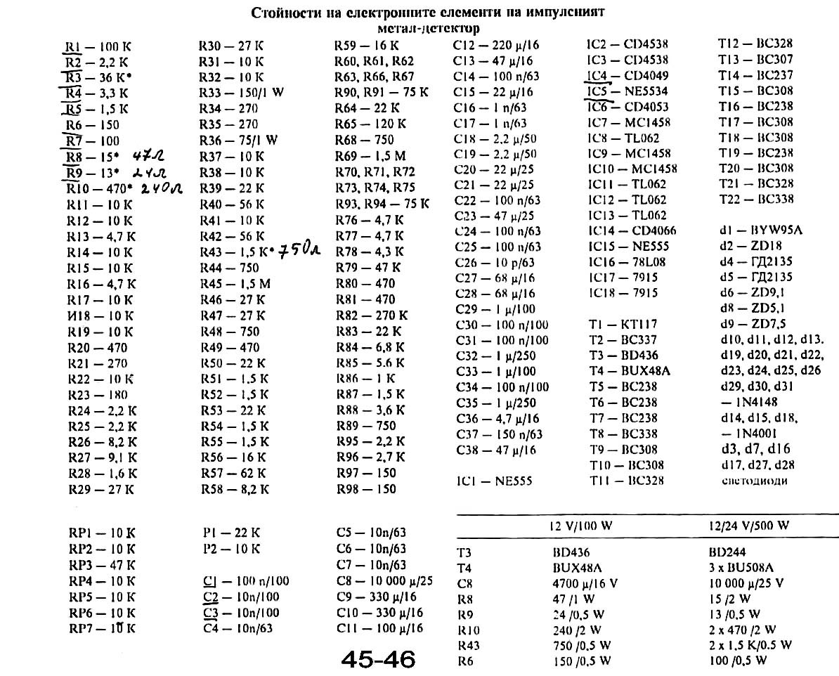

                  • HEllo scs
                    the main questions there?
                    1.which shematic is right which is rong and,,,?
                    2.the part list of each them have a problems,for example KT117 , 4538 aren in my country and equivalent of there parts I dont know .
                    3.have 2 coil for ps gb .I fear make the pcb and set the parts but have not the coils.
                    and .................

                            SEE SCHEMATIC > #366 ; # 369 ; Schemaic GENERATOR free КТ117 (no КТ 117) see # 116 ; coil 450 mikr.H ; R = 0,8...1 ohm . diametr. 30cm. ; 7907.. chenge to 7908
