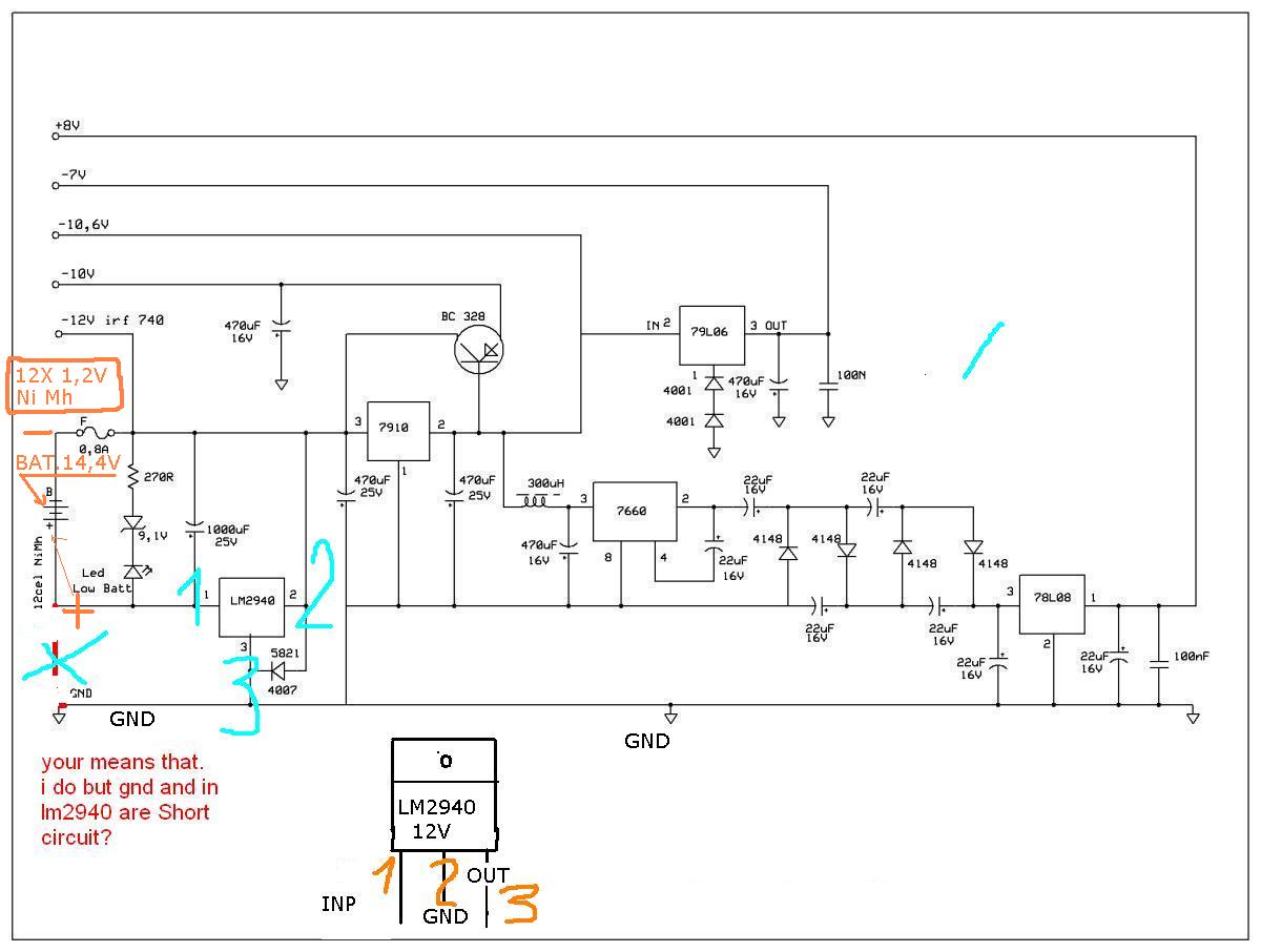

      my serious problem in schematic of alexis #4(supply figure) of lm2940 .when i connect the source that be too hot.

            • Hello georgi
              I think my first pcb of psg part of battery schematic is wrong and I again design attentive new pcb and set the parts but it do not give me the voltages.
              realy i help you.just you know i now use de adaptor 15volt and 1000ma-1500ma except the battery.
              when i connect the adaptor all out put voltage are 15 volt?
              what is my problem ?help me

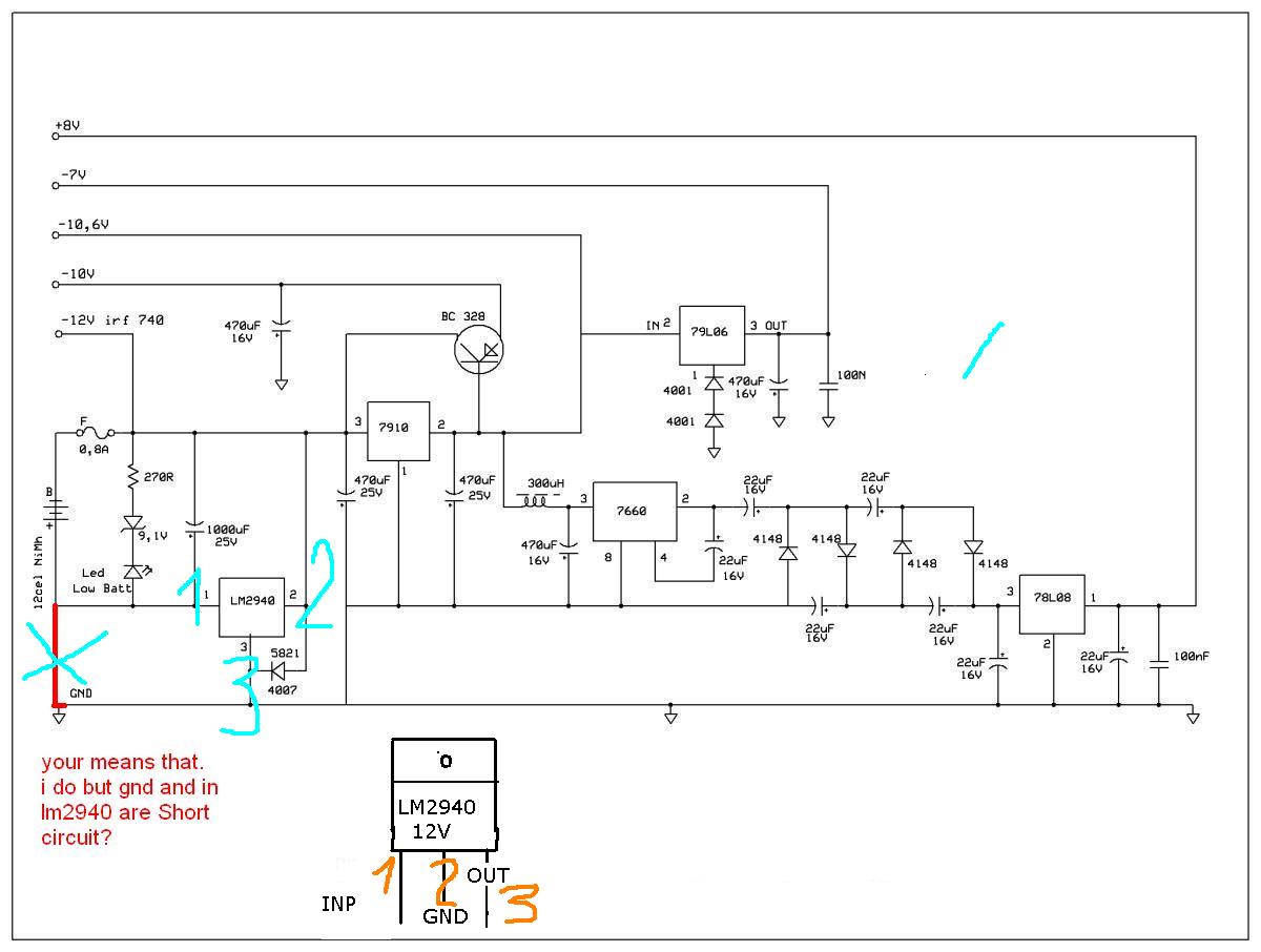

                • my problem is this shematic.
                  Gnd is +12 or -12?
                  i waiting........
                  • GND is +12V.

                      check the picture and help me.
                      i do but not have result.
                      thanks

                        • I think find my error
                          i use the lm2940 http://www.icver.com/images/PIC/L/LM/LM2940T-5.0.JPG and think the correct lm isLM2940CT 12 Volt 1 Amp Low Dropout Regulator
                          now it is ok?
                          and i use the schematic alexis .Gnd is + or-?is this correct

                            • hello george
                              i check that and that is correct butit is wrong.
                              and 7808 in the picture pin 3 is output but in schematic is input.and pin 1 in schematic go to +8v but in the pictur input ispin 1. is it correct in shematic?
                              and 7660 pin 5 is output not pin2 is it correct?
                              • 78L08 ......NO 7808,
                                mohandes , Open your eyes!
                                78L08
                                1...OUT
                                2...GND
                                3...INP
                                Schematic is 100% correct .
