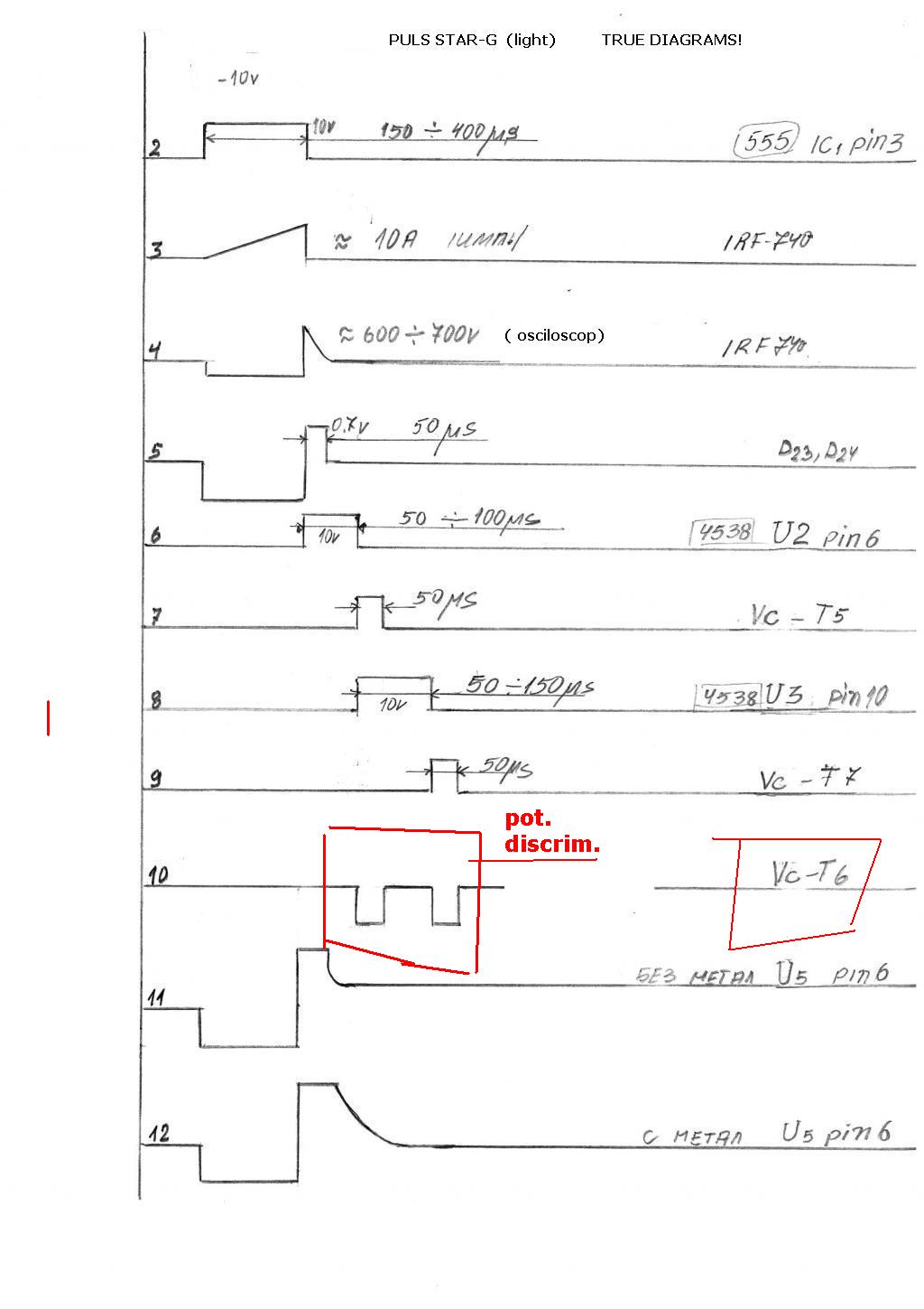

    I adjust RV7 and RV8 so at TP3=0V. OK!!!
    BUT when i will turn the disk potentiometer left or right the voltage at TP3 changes (is not 0V).
    So..... at who position must be the disk potentiometer before i try to adjust the RV7 and RV8???
      Hi Georgi.
      I saw it, but i ask again the same.......
      See oscillograms,

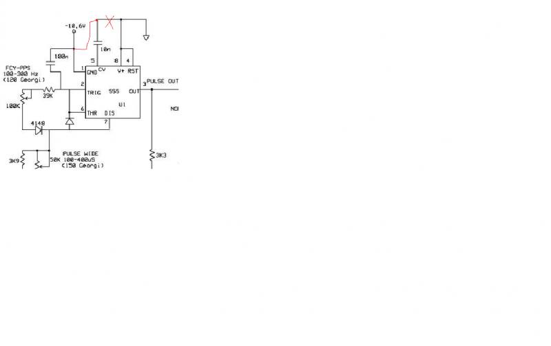

                          • Hi! ALEXISMEX.
                            If I conect the 100N capacitor to -10,6V rail (close to G. ZHELEV schematic) this would make any diference?
                            Thanks in advance.
                            DIRCEU.
