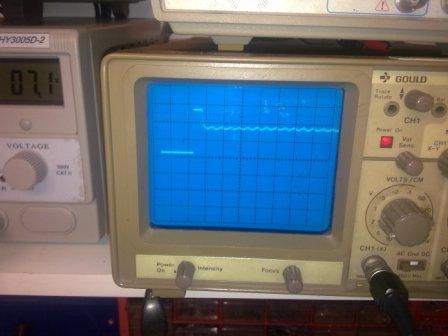

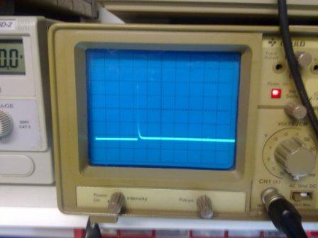

            I replaced the coil with another (280uH) but i have the same problems. I attach two photo. One from the Drain of MosFet and the other from the input of NE5534. This is very bad.
            What are you say? I took out the 5534 but the waveform remains the same. I will replace the 1N4148..... maybe...Also i replace the dumper without any results

                Hi George.
                The second waveform is at D21... D22 (1N414 with the NE5534 out of the socket.
                Coil is 280uH, r=1.5Ohm. I had one 1n4148 failed, i replaced both diodes but again the same. Damper is 240R and the board is OK.
                Now without to adjust the trimers it locate a soda can at 40...45 cm with full discrimination and a coin 30mmm at 25cm. But i see that it is not OK. The second probe shows 530V on the drain of the IRF740, so it is more near to you. But there is problem at the diodes, there the signal must be 0.6...0.7V but at my detector it is 1.2V (the peak). So i need a better diode, maybe more fast. The down side of the pulse is OK (0.7V).
                Any idea??

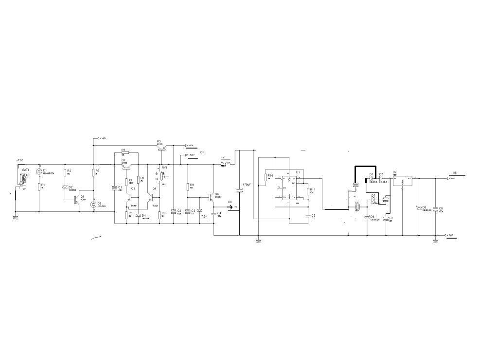

                  • Hi Georgi.
                    I attach the schematic of the power supply.
                    If you like the waveform at the diodes then i will adjust the trimmers today and i will tell you.

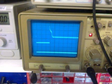

                    • Hi Georgi.
                      Here is a photo of the output of 5534. Look the ripple!!!!
                      I supplied the +8,-7V from the lab power supply but no results.
                      I will try to connect a capacitor on pin4 and pin7 of 5534.
                      Any other idea???

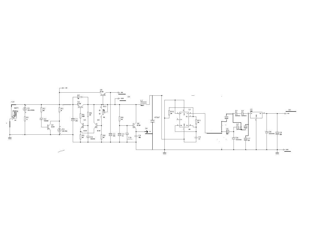

                      • I had a mistake at the schematic of power supply.
                        Look this....
