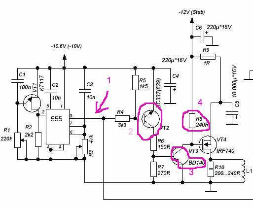

            • Hello Forum ,
              Ok Messyna y Georgi , for me it is Almost the same for the power ( you have a 50 Ma of diference )200 Micro second o 150 Micro second...
              for the test fix the RV1 to 120Hz and the trimmer RV2 to 150 Us ...and all is fine
              But if you have this design and your 740 is very hot ....you must look is another problem and for me i do not see where???
              1) see in 1 do you have really the pulse of 120Hz and 150 uS test with and osciloscope ..ok
              2) see in 2 in you solder well this transistor bc 337
              3) see in 3 if you solder well this bd140
              4) see if you put really a 240 R and not a 24 R or 2R4
              IT is very simple design you must have conected bad one transistor ...ok
              Check welll and you will have this worK
              nice
              Alexis.

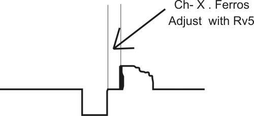

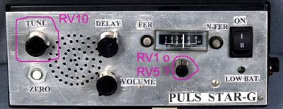

                  Today i have checked and adjusted the discrim , sometimes is good sometimes it fail , i use two sheet of metal 10 X10 cm one in copper the another in iron....
                  please , can you give me the best adjustment for the channel X Ferros : How did you fix with RV5... at 0,, 10... 20 uS o more the window see my drawing and another thing see the photo the pot discrimination you use RV11 o RV5 tell me...you move this potentiometer to adjust the center after you push the Zero ???
                  Thank you very much Georgi
                  Alexis.
                  • PULS STAR-G
                    Hi,ALEXIS!1. Potentiometer RV3 (DELAY) put in a position of maximum sensitivity and stable operation of the audio channel. (do not touch more)
                    2.RV5 discrimination> See ostsilograma scheme. (Q6 colector) fixed and not touch more!
                    3.RV7, RV8> putting U7A (TR3) 0V. more .. do not touch!
                    4 .. Potetsiometar RV11 >discrimination indicator to zero.
                    5 .. Push and relax ZERO, RV11 ... indicator of discrimination> 0 <!
                    UNDER INDICATOR ,POTENCIOMETER RV11! (NO RV5,RV10)
                    IMPORTANT! BEFORE SETUP, OFF TV!! (ALL TV> OFF)
                    CHANNEL discrimination is very sensitive! G.L.!

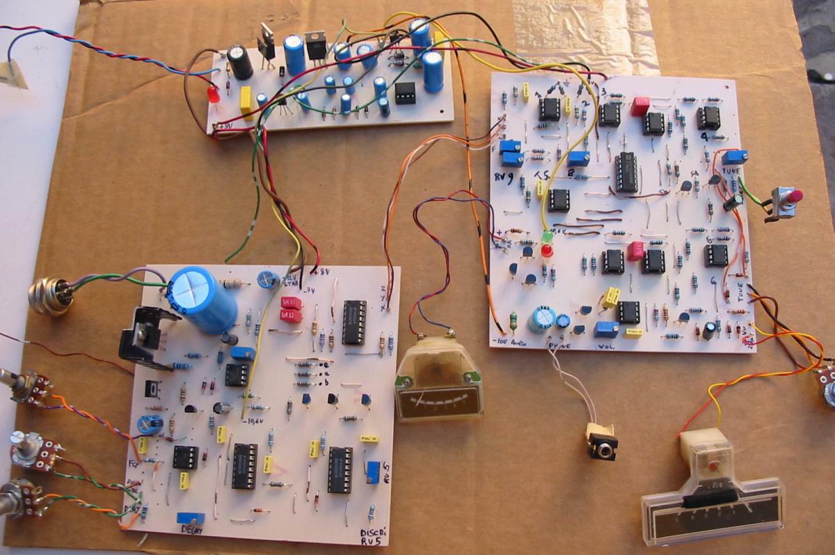

                        • hello Georgi ,
                          Today i check all the circuits , all is fine and working well Thank you for your help to morrow i will reajust like you say the preset ,ok...
                          Do you experiment with the BD 140 it is necessary this big one , a small transistor work also like the BC 327 ????
                          See my prototype experimenting boards, it is big one but this way i can check very well all the signals good ...now i can design the board 2 trace.
                          Have a nice day,
                          Alexis

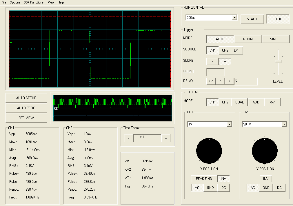

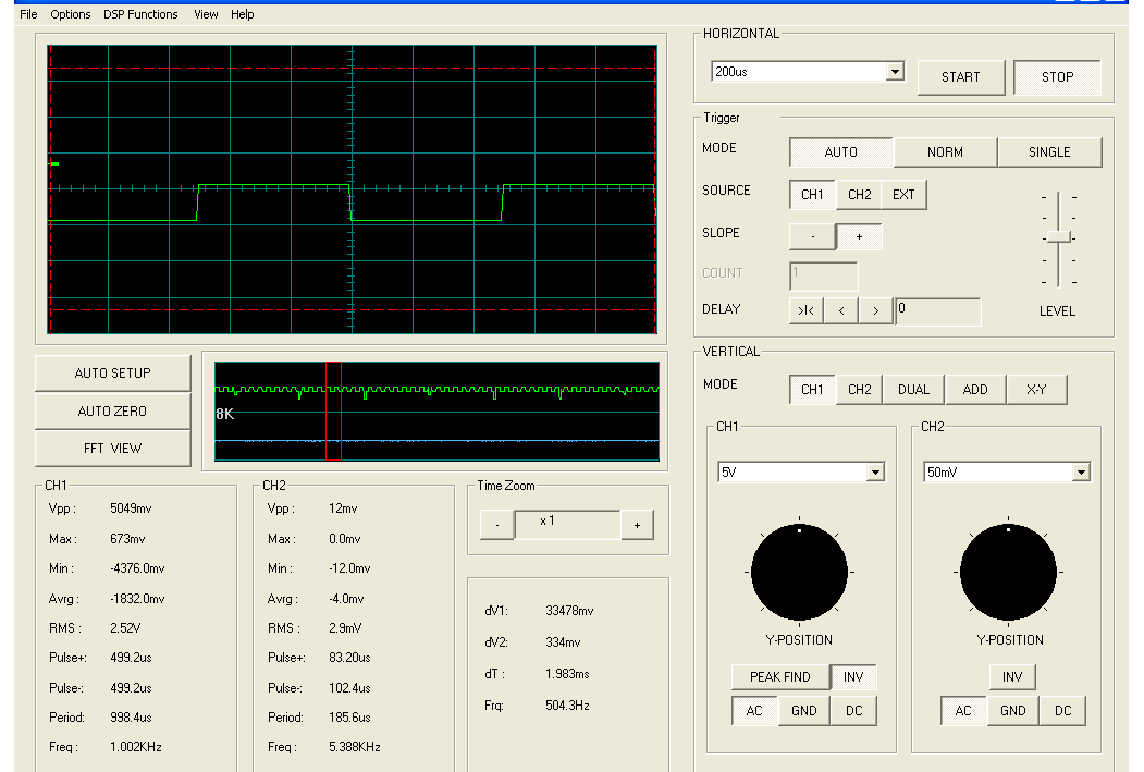

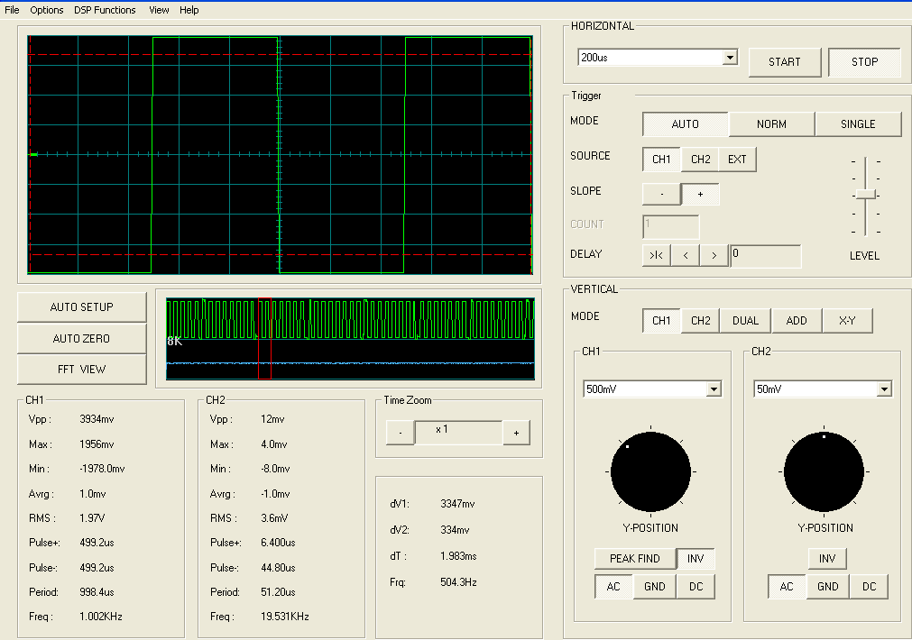

                          • hello dear georgi.g.zhelev
                            I got size of the output pulse 3 (555)
                            Its waveform to these three conditions are
                            i do not know the values for the horizontal and vertical have properly set or not?
                            Please set me for the best waveform and to determine the main values to the horizontal and vertical guidance.
                            With respect
                            mesyna
                            • PS-G
                              Hi, mesyna! I see, 5.049 mv ...ok. puls 499.2mks ..no ok. power trimer 150mks!!
                              f= 1.002Khz , no ok ! trimer freq. 120HZ!!
                              I have not worked with a virtual ostsilostsop, but nothing complicated.
                              1. horizontal placed on 50mks ..
                              2.vertikal ..... 2V.
                              Se check scheme and other control points ostsilogam governed by three-dimensional. coil has 500 .... 600v, there did not include! will damage the oscilloscope, you must include it in atenyuator (x 10). As I have described above how to set. then include the probe of NE5534 pin 6, there will watch the signal is there a change when there is metal.
                              G.L!
