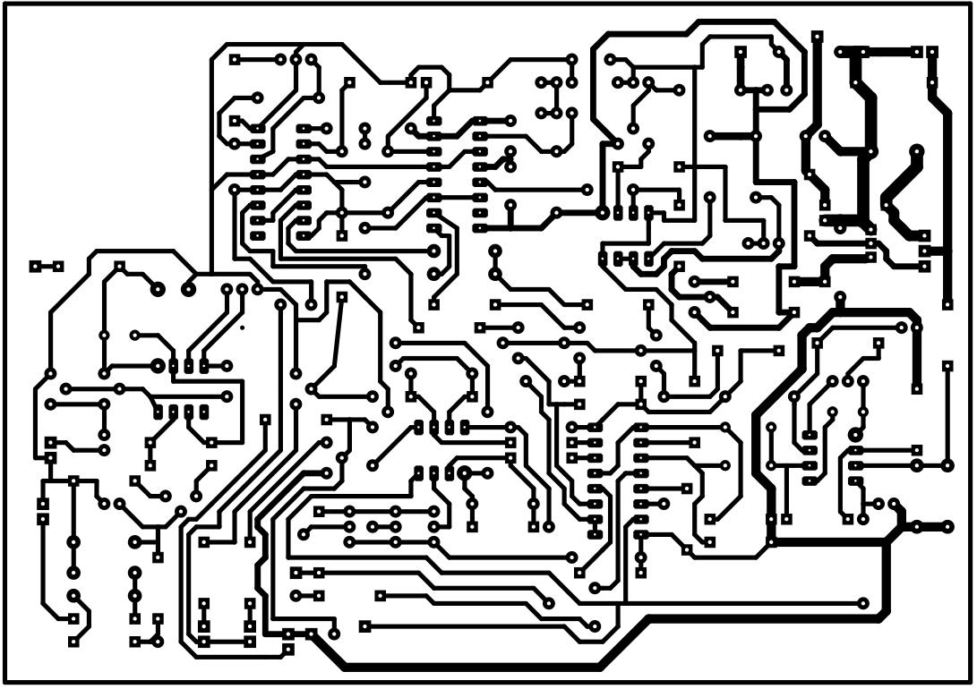

                    Hi.
                    I attach the pcb that i made my project. I think that the designer is HumHum.... not sure!! There are errors at the transistors. You must reverse them 180 degrees. The power supply from the same designer is wrong, so make an other power supply or make what KT315 post here. I finished it but i have not time to connect all together with potentiometers, coils etc. Maybe next week.

                          Low speed? It is only 57 kb.
                          Ok we can try with 4 parts of picture out of Geos pdf (ask Geo for PCB dimensions):

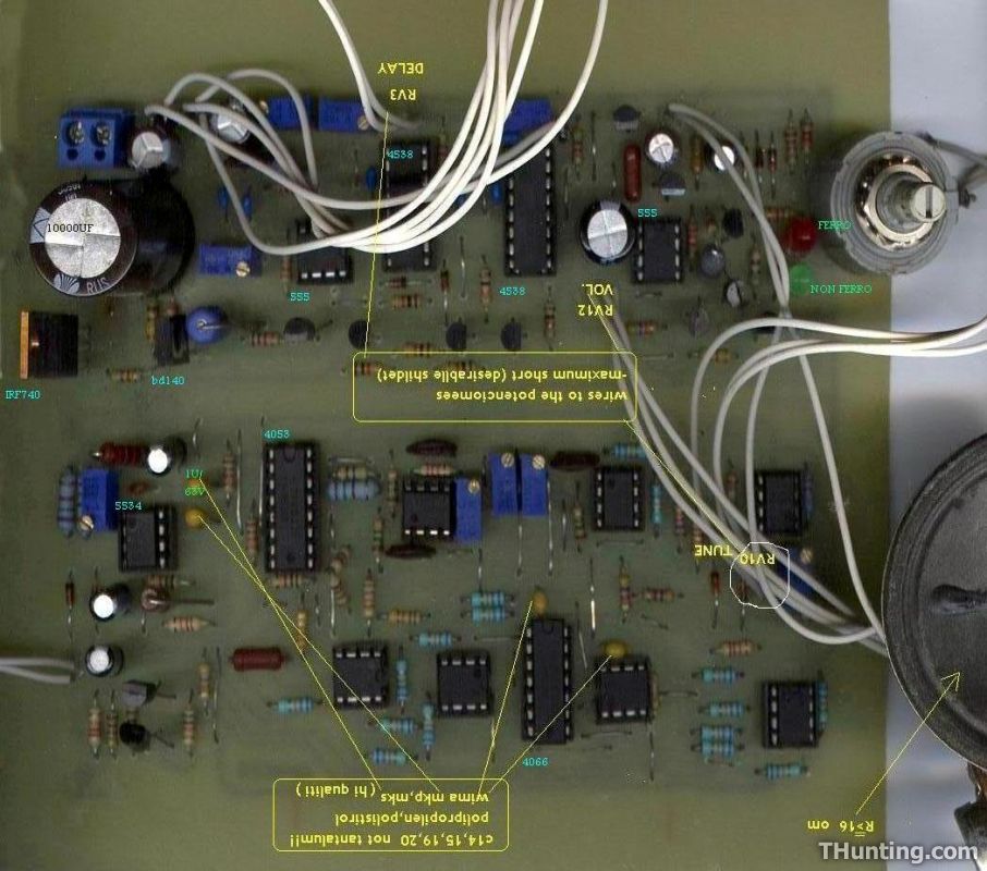

                            ok this pcb are old i have another pcb but i dont know if it workes or no i guess it workes becouse in thunting ther is a forum called TO ALL THE DIFFERENCES BETWEEN DPB2010,DELTAPULSE,PULSESTAR-BG the pcb of the pulsestar bg id the
                            single side one pcb and the power pcb here is the file with the wright dimentions
                            • hi
                              i guess japanies has built it and it workes fine with him thats why he compares it with the other md's so i dont know if ther is any problem with the pcb
                              hers the picture of the complet project from thunting
                              nice hunt
                              danny
                              • Hi.
                                This photo is from here not from Thunting....
