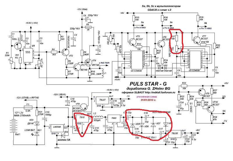

    in principle. the first is WRONG the pin at lm 2940.
    [ATTACH]30012[/ATTACH]
    your fatal mistake is you connect Output and Input of the 2940 on power supply. your 2940 will give off the magic smoke living in electronics.
    • PI detector with mono coil -correct discrimination for silver is not possible.
      • I can assure you that my this drawing is correct, because I was being used, or you didn't notice the zener diode has a 5.6V LM7905 below, it is because of the diode, the negative 5V into negative 10.6V
        • yes did not notice ..thanks for resolve the issue fengzai01 5 + 5,6v zener = 10,6 ok
          • kt 315 wAS WRONG What I wrote for 2940 certainly would make a nice boom
            • The scheme is 100% correct !!!

              • Originally posted by g.s View Post
                seems your name is due Eric Foster.
                get out a fat glass from your nose and look
ID:	340810The drawings I have some ideas that, if you use LM7910, then you output voltage 10.6V or 10V only, 10V only about 9.4 volts, this is the first question, the second question is a 7660 boost part is wrong, the third one is the U3 fourteenth adjustable foot is wrong connection, please see U2

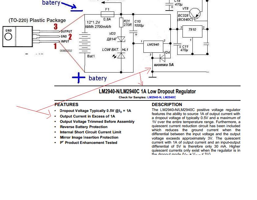

                  • We need to know first how battery is here oriented.
                    Where is + an where is - ? Georgi?
                    There are different use of + - battery sign in schematics drawing.
                    Which one is correct, this: - -|i|i-+ or this: + -|i|i- - ? According C10 + is at bottom.
                    What is (+-) marking convention - look at praxis:
ID:	340814The plan is entirely correct, this circuit is based on +12V GND

                        LM 2940 /12V
                        • it lm2940 look at the schematic that has the force 5 amp ??????

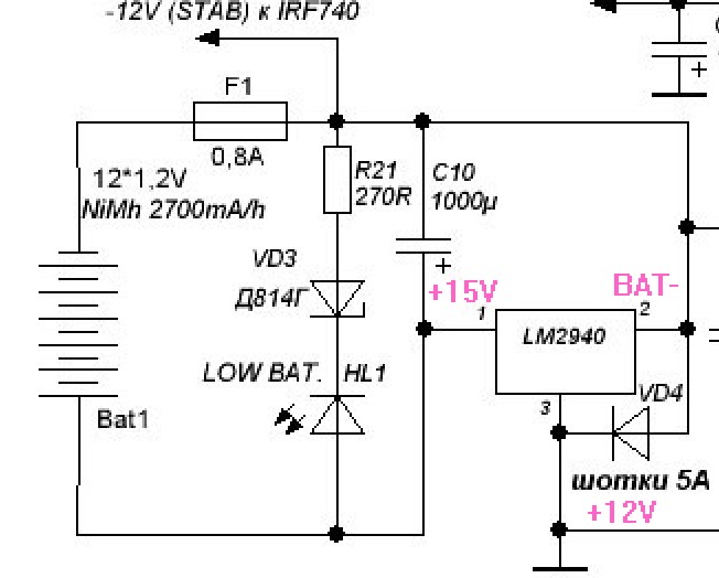

                          what is the meaning of the word womku ??
                            It is Schottky in Cyrilic.
